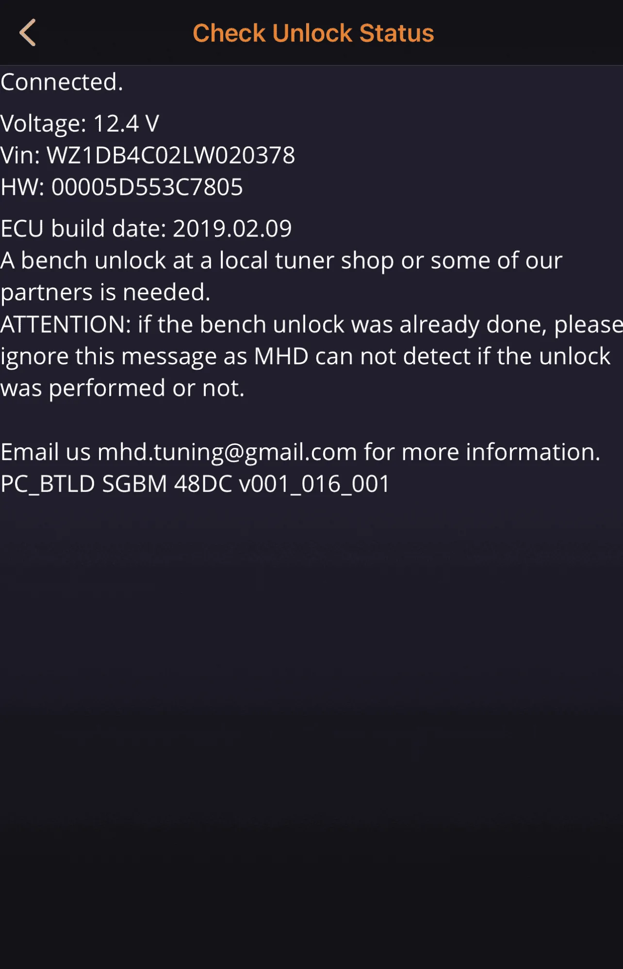

I purchased my vehicle December 15, 2021. It is a 2020 Launch edition. I have just now gone to tune my vehicle with an MHD OTS map and I am receiving an error that stops flashing the ECU at 2-3% every time. The ECU build date is 2019.02.09 which is why I am confused, as the DME unlock check is saying that a bench unlock is required. If anyone has any ideas about what to do I would greatly appreciate it! I am wondering if it is possible that the dealership could have locked my ECU with a later patch.

You will still need to have a bench unlock. I had Kies Motorsport do mine. Had it back the 2 days later. Shipped it Monday, had it back by Wednesday.

Unlock depends on DME production date and software update in it,
You can check it with MHD app, "Unlock Check" button, it doesn't need a license,
More info:
There are two types of locks
1) First type - Let's call it "software lock", DMEs produced before 06.2020 (except a few exceptions) that are updated by dealer, have software from BMW that blocks tuning from the OBD2 port. "Bench Unlock" modifies that lock, so it Opens it, and you can flash it with tuning apps
2) Second type - Let's call it "hardware lock"(not true but easier to imagine) - DMEs produced after 06.2020 they can not be "bench unlocked" like older DMEs. Right now, only one company, FEMTO, residing in Finland, can unlock them, so you need to ship the DME to them. Once it's unlocked, you can again flash it with tuning apps. The only limitation with the second method is that with FEMTO unlock, you can tune calibrations only, which means no program changes that are necessary for map switch, flexfuel integration, etc.
