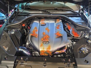

I attempted to but then had a guy airbrush some flames on it for old time sake. The VHT paint works fine. You will want to use the primer first and make sure there isn't too much moisture in the air when you do the clear coat or it will get milky from my experience. Hope that info helps.

That's fucking hilarious and awesome. I might spice up the old stock cover I have laying around with some hot-rod vibes.

Damn, thats fire

For a second I thought I was looking at a Mk8 Golf-R engine cover pre-recall..
