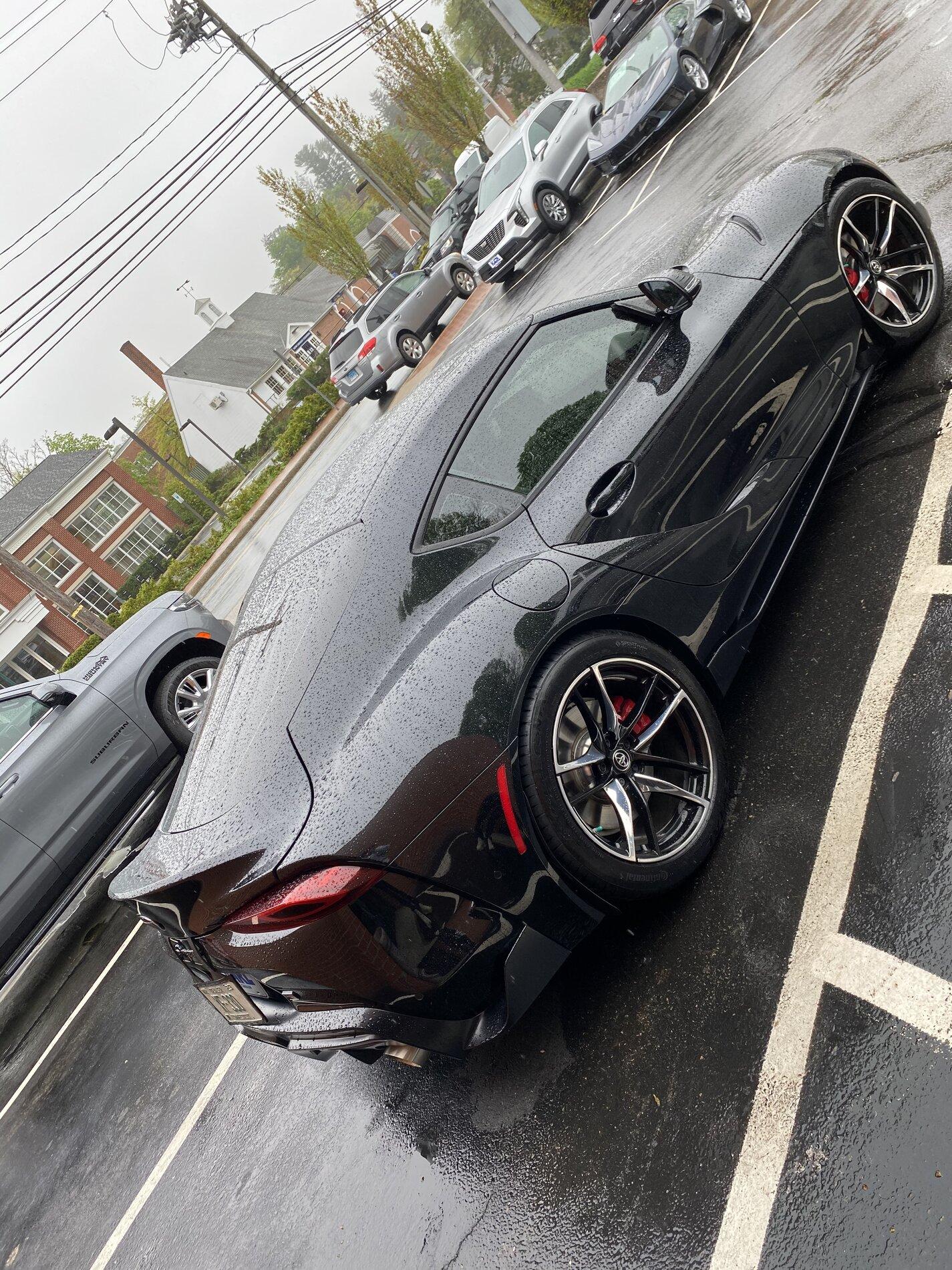

Purchasing 2020 A90 3.0 premium. 10.5k Mileage. Anything specifically I should look/inspect on car? Thank you!
erokkin
Eric
May 3, 2021
Lake Grove, Long Island
2020 Supra GR 3.0
Just want to know if there is something I should double check or ask before the purchase? knowing that it is bone stock with only 10.5k miles. $47k out the door. Comes with two sets of tires, all weather Continental Extreme Contact and stock Pilots. Thanks in advance guys and looking forward to joining the Supra Family.

^^ Well that was quick. Was just about to throw up some suggestions and read you had already bought it. LOL
