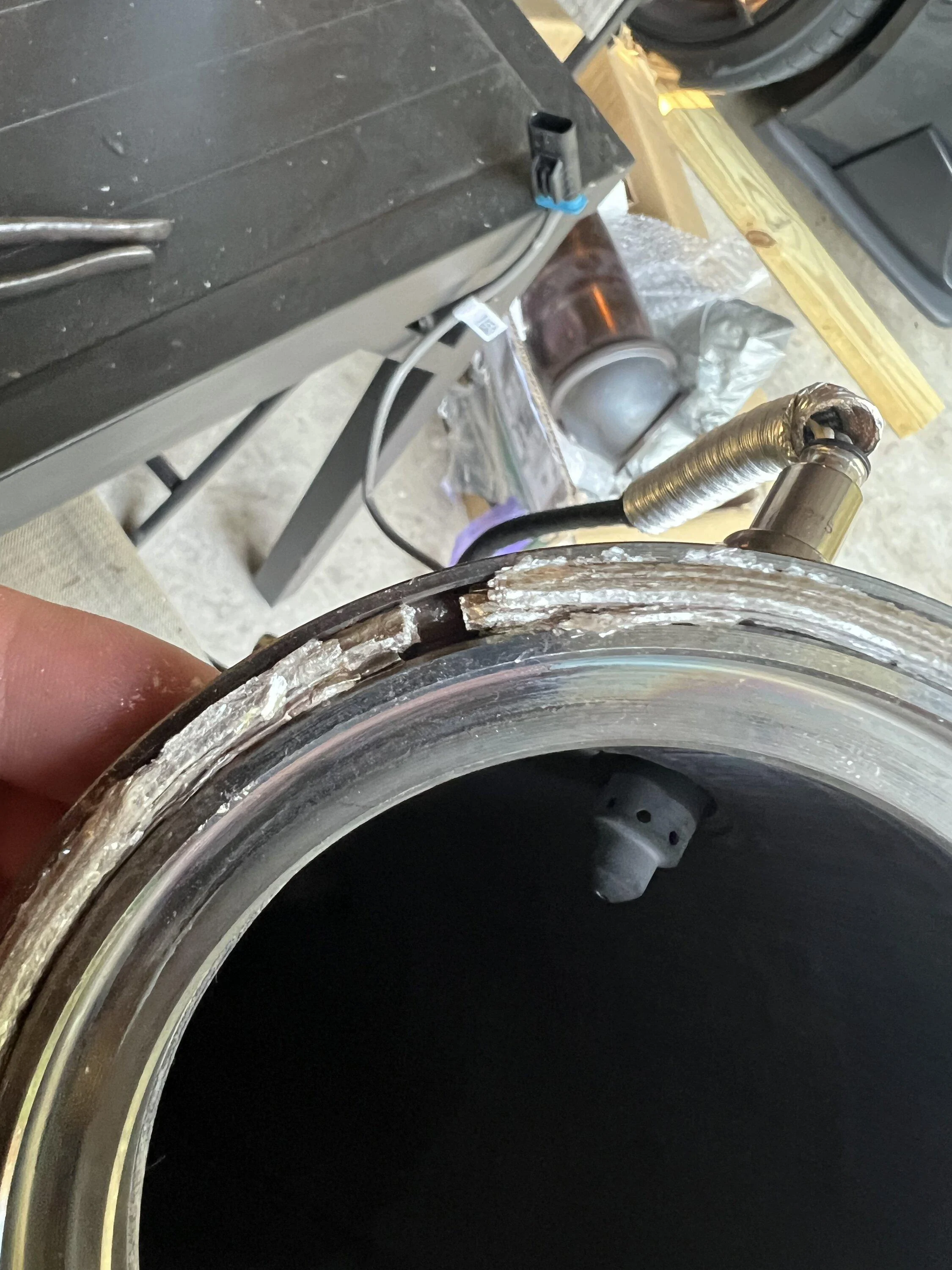

Look closely at these pictures, as the old gasket is still attached to the Titan when I removed it. It lives in that groove, so I don't know if you're trying to put it somewhere else or what

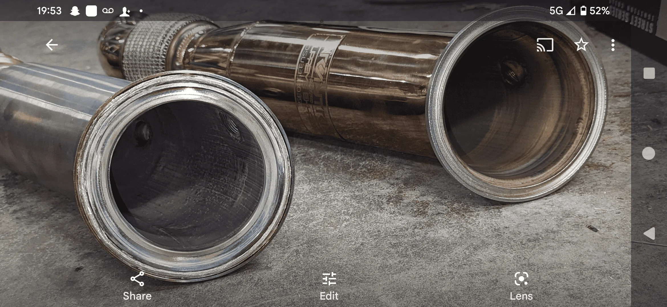

Thats the groove I was trying to use. I was able to slide the gasket on and off very easily with the oem downpipe. But when I tried it on the titan one it would just not fit whatsoever. I even tried using the old gasket from the oem downpipe on the titan and still no fit.

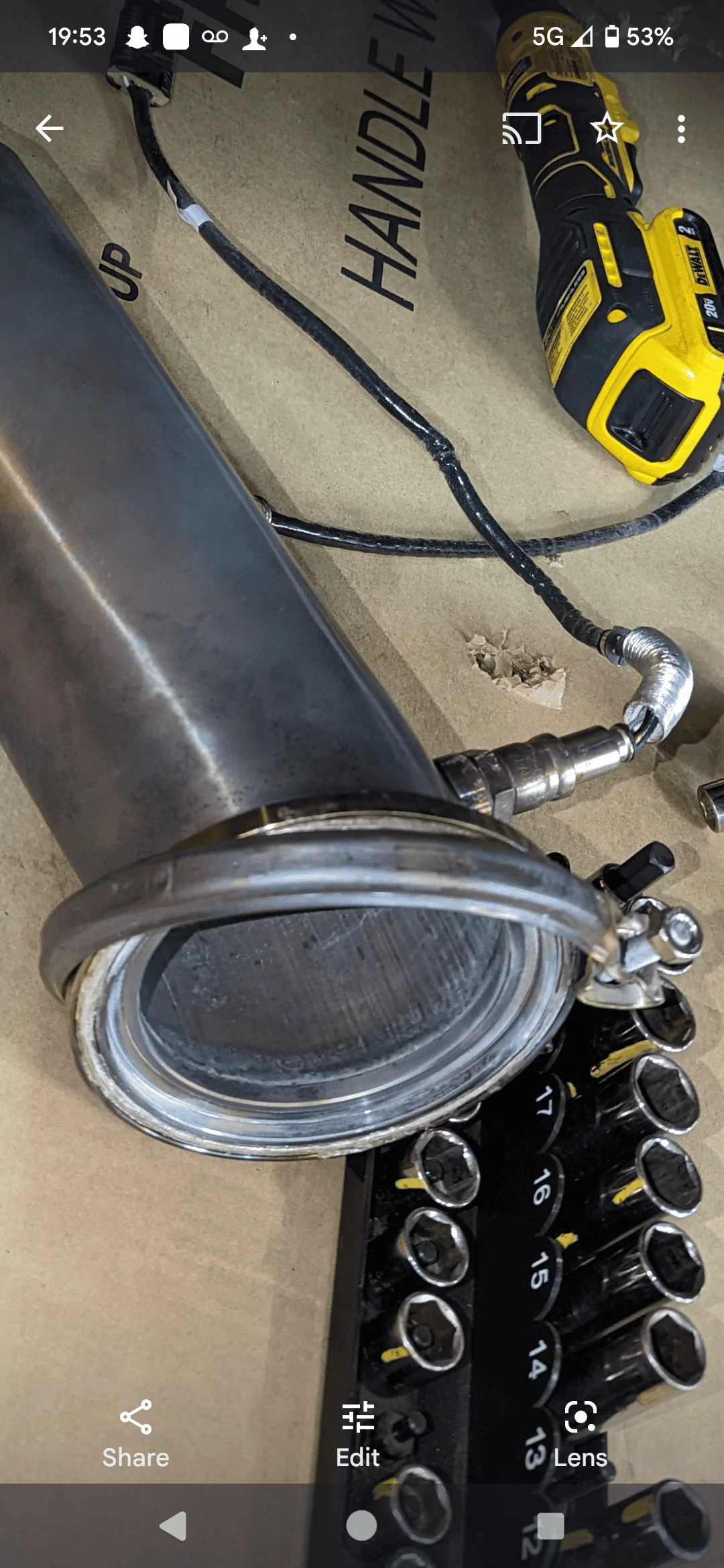

Just for reference I attached a photo to show how short the gasket was had to cut it to make it fit. Not using it like this. Ordered 2 new ones. Like I said I didn’t have to do that with the oem downpipe.
