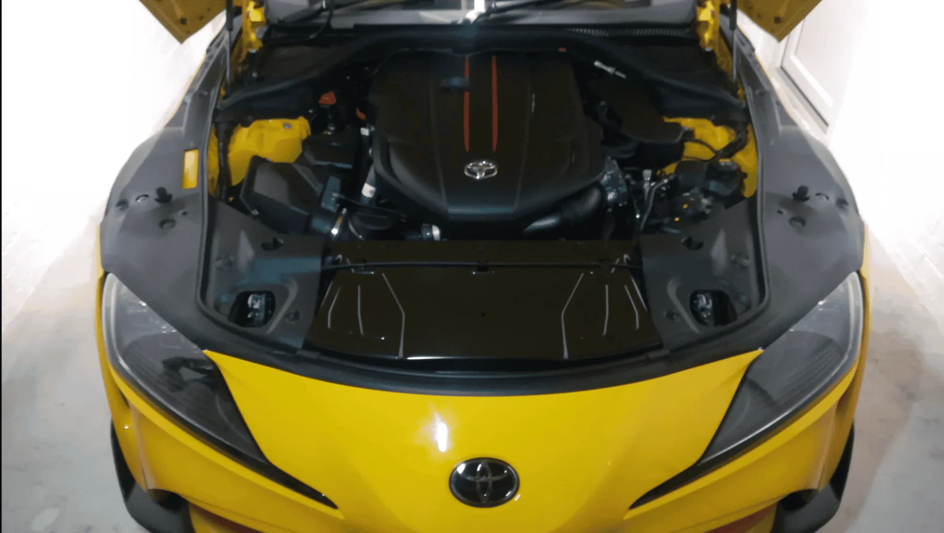

Does anyone know why the UK (and I assume EU too) 335bhp B58 doesn't get the strut bar? I can see the drilled holes are there, it just seems odd...
I'd like to add them onto my '23 Manual, does anyone know Nm torque spec for nuts and whether this will affect the car handling at all? (Fully stock)

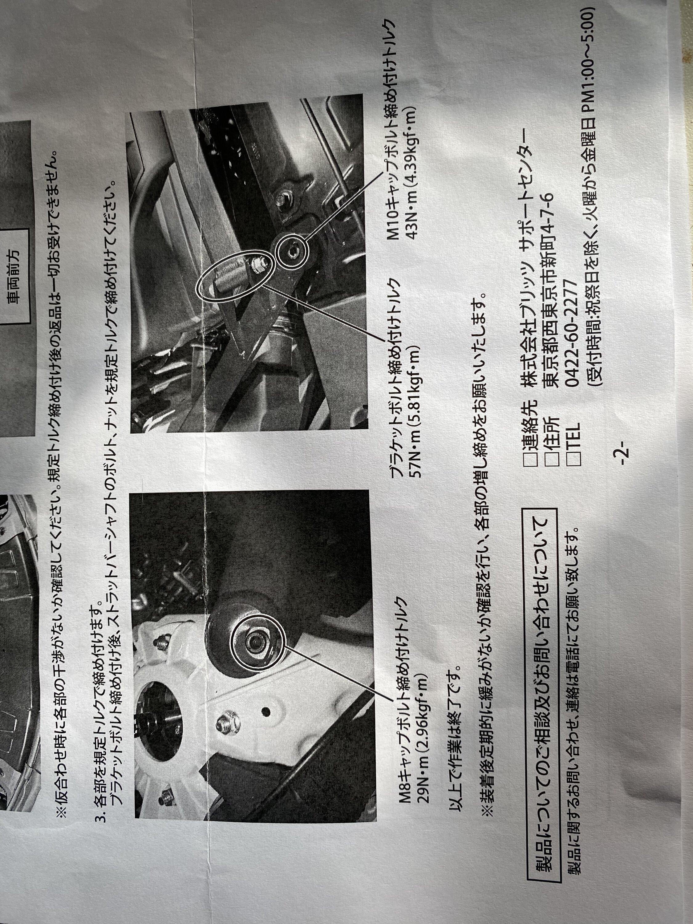

Really? I had assumed they were only missing on my early 2019 model.. I can tell you the Blitz torque values as I have them in the paper work sitting in my tool box.

Here it is! (Hopefully my pic is legible)
I had the same Blitz bar from RDHJapan and the rear bolts didnā€™t match. So I used the ones that came with my 2022. The front bolts that came with the bar, no problemo.
May not be what youā€™re referring to but it happened to a friend with a 2020 as well. So he went out and bought rear bolts. We had the same exact Blitz bar from RDH with same directions we couldnā€™t read šŸ˜‚
