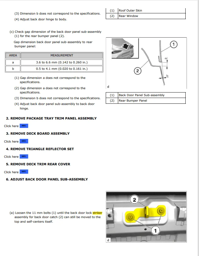

It may be the the rear hatch striker needs to be adjusted to pull the hatch down tighter on the seal and keep it a bit tighter. Here's the manual ref.
Phil
That's interesting, I will have to try this out. I would think this is something that could cause that vibration at WOT.
