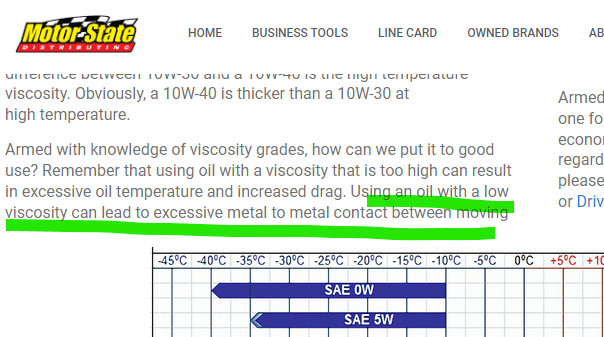

W/ ESG on the rise in the last decades, and unclear on the priorities of the automakers on MPG or logevity of engine, I would bet that their top reason to recommend 0w20 is primarily for MPG.
For our cars, I switched to 0w30 as minimum viscosity range.

First of all, I'm just providing mainly qualitative value so you can interpret the information how you like.
If you can track down the oil clearance of your main and rod bearing, it will likely be somewhere in the neighborhood of 0.0015 - 0.0025", the literature will suggest oil of #w20 to #w40 for typical operating temp. See article here or here. If you look at enough service manual the bearing clearance has a range, so jumping from 0w20 to 0w30 is reasonable. To jump from 0w20 to 0w40 might be a big leap.
Again, for me to move away from the manufacturer's recommendation is more of a bet than anything. YMMV
