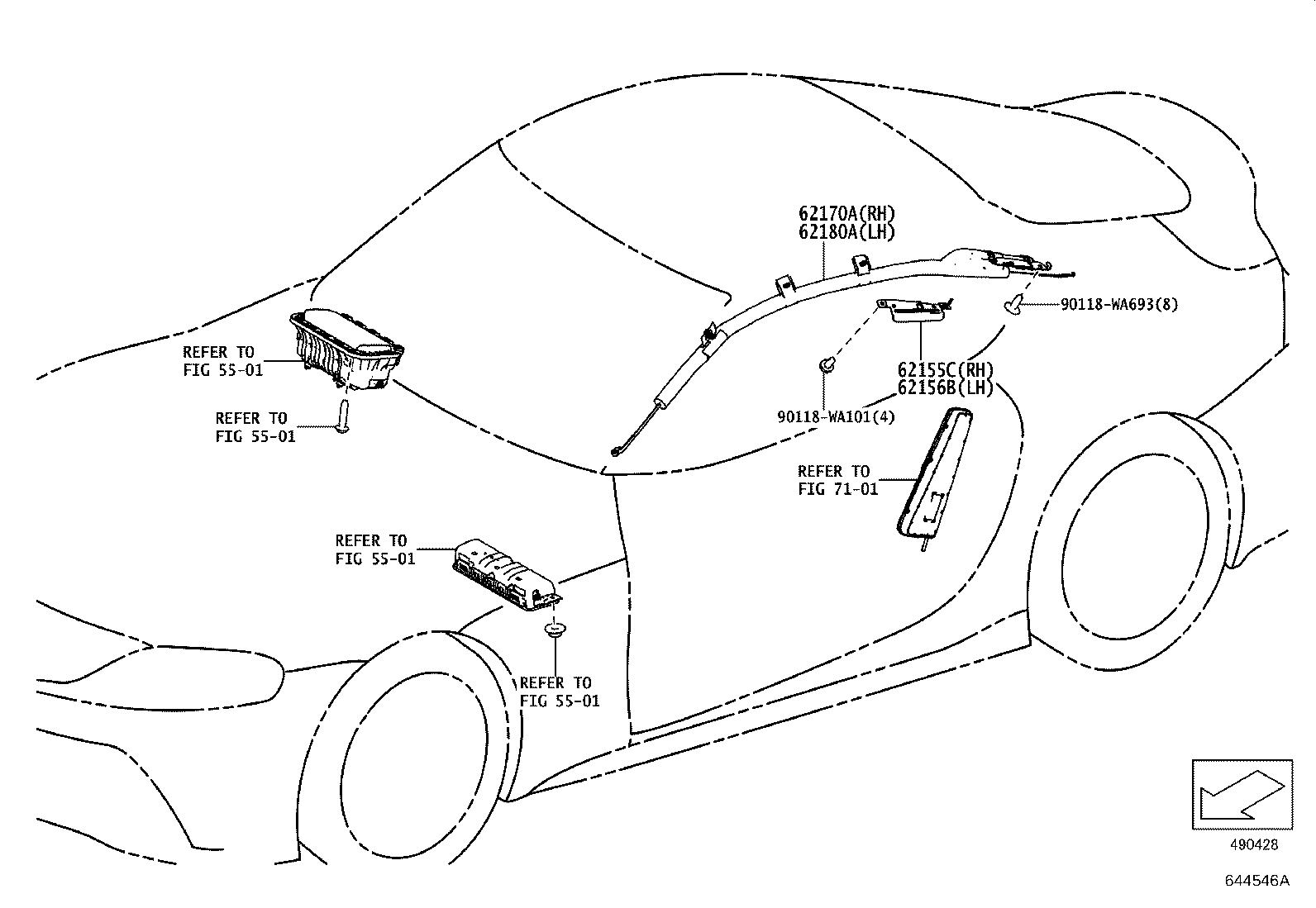

Sounds good. Is the air bag down low or up high in these cars
It will be mounted up high, since it's the curtain airbag. Here's a crappy technical drawing to show how it mounts. Tons of room for wiring in the lower part, honestly.

It’s been a minute since I had them off but tbh I remember it taking up the majority of the pillar. I wouldn’t call it spacious
