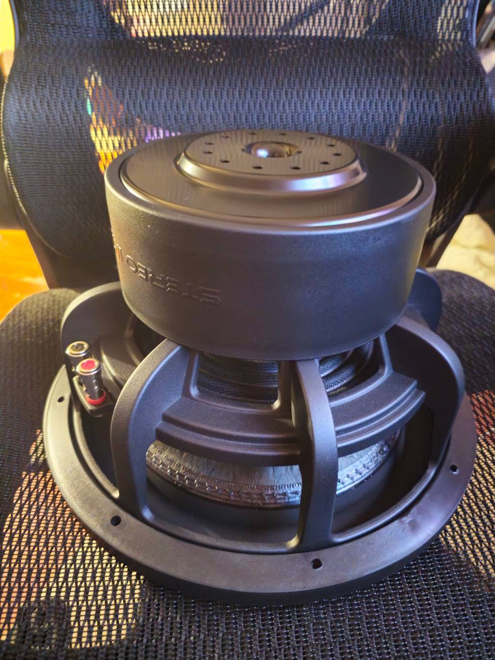

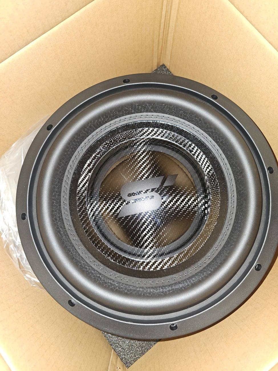

I have a Audison AFM1D (1300W) amp going to push this SI SQL12 (D2Ohm).

I replace all of my speakers with Morels and insatlled a Audison AF M8.14 DSP amp myself. I have the base audio which makes this much simpler. Your JBL system runs off a MOST interface that will need equipment that utilizes the MOST interface. Either an amp with built in MOST inputs (Mobridge K2), or a module like Helix SDMI25 or Mobridge DA1 to accept MOST in and convert to optical out.
I am currently looking for an installer to build my box and tune my DSP better and have heard really good things about Javier at https://www.audiosystemsca.com/

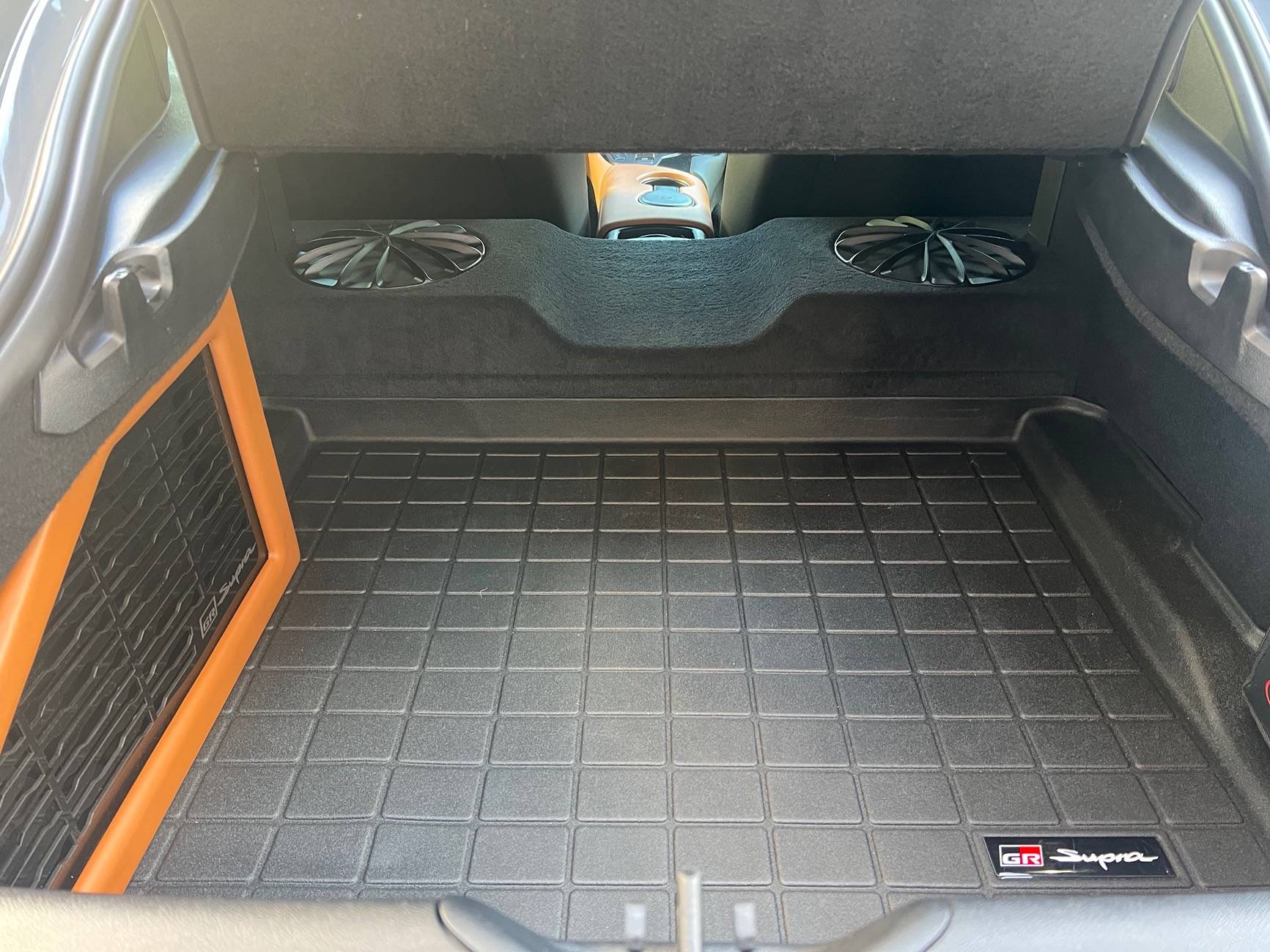

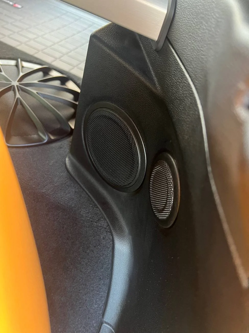

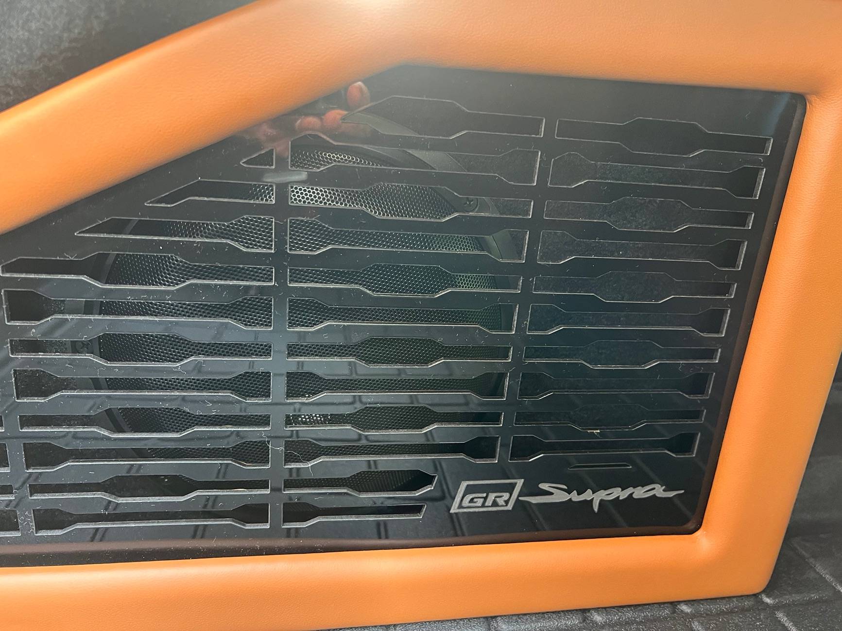

I have used AudioLab in Lake Forest for several of my cars including my Supra. They have done amazing work for me, and can handle any custom work. The owner, Sam, is easy to talk with and responsive.

Appreciate the pics and your recommendation! Love the setup! I was thinking of doing a box laying face up (speakers pointed to the roof) with 2 10s pushed against the OEM subs but I actually really like how you placed the sub in the nook of the trunk to keep the space. Do you mind if I ask what you were quoted?
