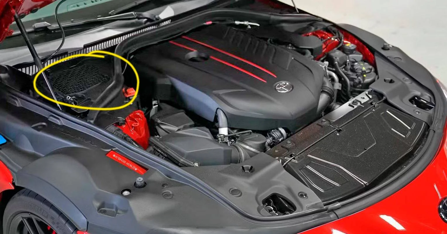

It actually ended up being something I never would've thought. It was from under the hood. The honeycombed shaped lid was vibrating on something, so I just put some EPDM rubber between the lid and it was gone.
Can't really say that your root of cause is the same because it can be so many various things. My rattle actually sounded like it came from within the car, hence why I removed the screen and some other stuff, but to no luck. When I finally asked a friend so stand outside the car while I revved it, he heard the sound from the outside, and that's how I figured it out. ?
