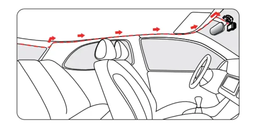

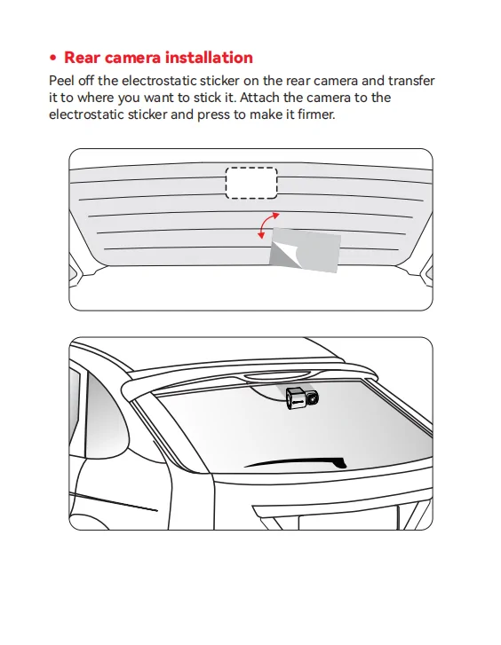

Redtiger dashcams are designed for easy installation and are compatible with the vast majority of vehicle models.
Most Redtiger dashcams use a Type-C car charger with a USB port, and the main unit is connected to the rear camera via a cable. Except for parking monitoring, all other dashcam functions can be activated through a simple and quick installation. You can install it yourself without needing to visit a dealer. We provide all the necessary tools for installation, including the adhesive pad, electrostatic sticker, and trim tool.

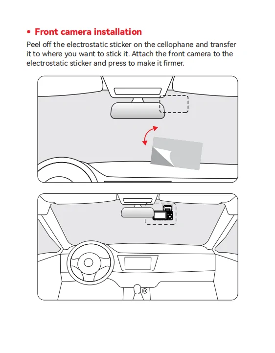

How to Mount the Dash Cam
The first step is to choose a suitable location on your windshield for installing the dashcam. We recommend placing it behind the rearview mirror so that it does not obstruct your view while driving.
The mounts of the main unit and the rear camera can be secured to the windshield using an electrostatic sticker and an adhesive pad, and the main unit can slide on and off the mount easily.
Before attaching the mounts, please make sure the installation area is clean and dry.
