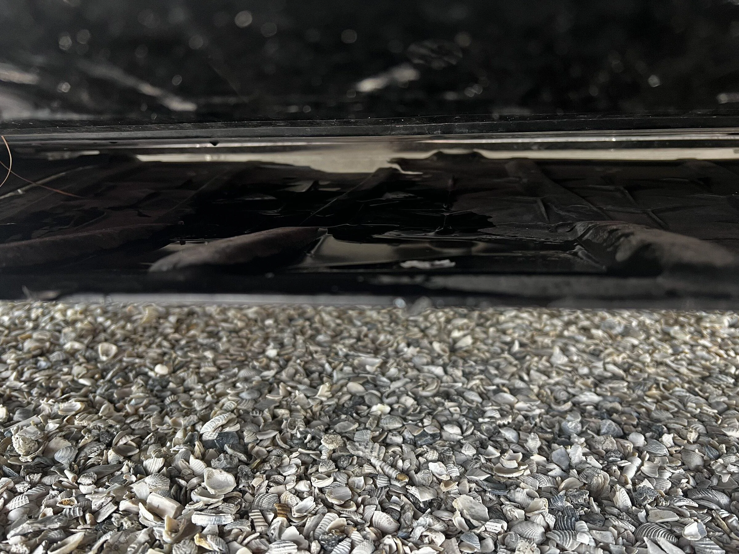

Anyone experienced a knocking noise under load only? This is definitely a knocking and not the normal ticking we have. Happens only under load and not when idling or revving in neutral or park. Im headed to the dealer on Tuesday but was just curious if anyone had experienced this. Ill see if I can attach a short video
Did you find out what's wrong with your car? I bet you your charge pipe is loose.
it was the skid plate. Once I hit 20mph the wind was strong enough to pull the plate down and it was scratching on the road.

That's the sound I heard at over 80 mph lol I think my plastic fiber panel was flapping lol.
