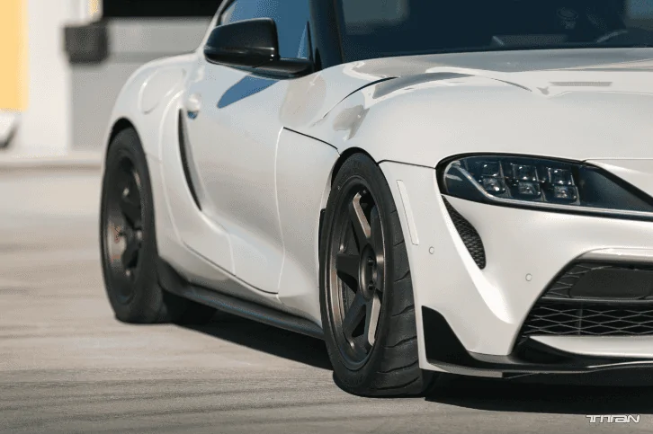

Do you guys have some pictures of the TE37s on the front, Their fitment seems pretty aggressive I am trying to see if they poke out of the front fenders.

They don't poke out, and Adam's tire fitment is more aggressive than others also.
