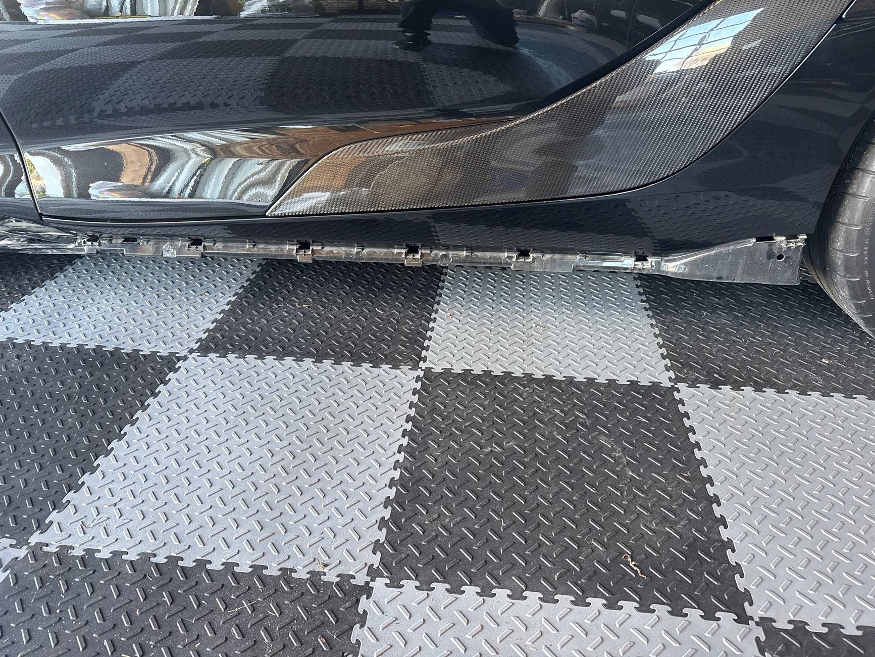

Does anyone have the schematics for the driver side rocker panel? Some bolts are obiois but really hoping it doesn’t connect to the trim above ??. Picture for reference
thanks in advance!!

there are 12+ claws holding that rocker panel moulding on.
check out page 2400-2409 of the workshop manual for the removal and assembly of the moulding.

there are 12 claws holding that rocker panel moulding on.
sweet Thanks. I’ll search for a workshop manual

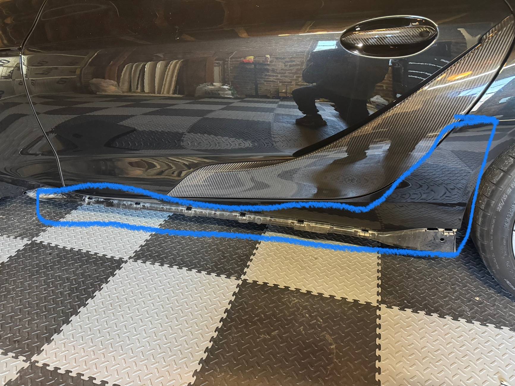

Hey Fuji question for you. I got your link to load and I’m wondering, is that rocker panel 2 pieces? I’m beginning to take off the trim piece on the inner door but the picture makes it look like 2 pieces. The part that is broken is where the painted side skirt clips into.
In your opinion, am I to be removing an replacing the entire rocker panel including the painted part between the rocker panel and the door garnish?

To elaborate a bit on my question, does the entire blue outline need to come off and be replaced for the part that the side skirt clips
in to? (side skirt removed in picture)

yes, the No.1 side panel moulding is one piece.
