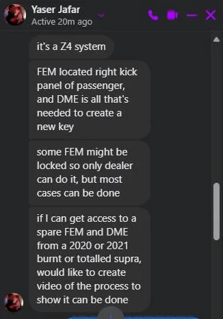

Try this company, will have to send them some modules but they are the only ones i know outside dealers that can help AKL vehicles.
VEPro - Vehicle Electronic Professionals and Module Programming
Speak with Yaser Jafar he is the contact that has done these before.
(I work in the automotive locksmithing industry he is the only person I know dealing with it)
