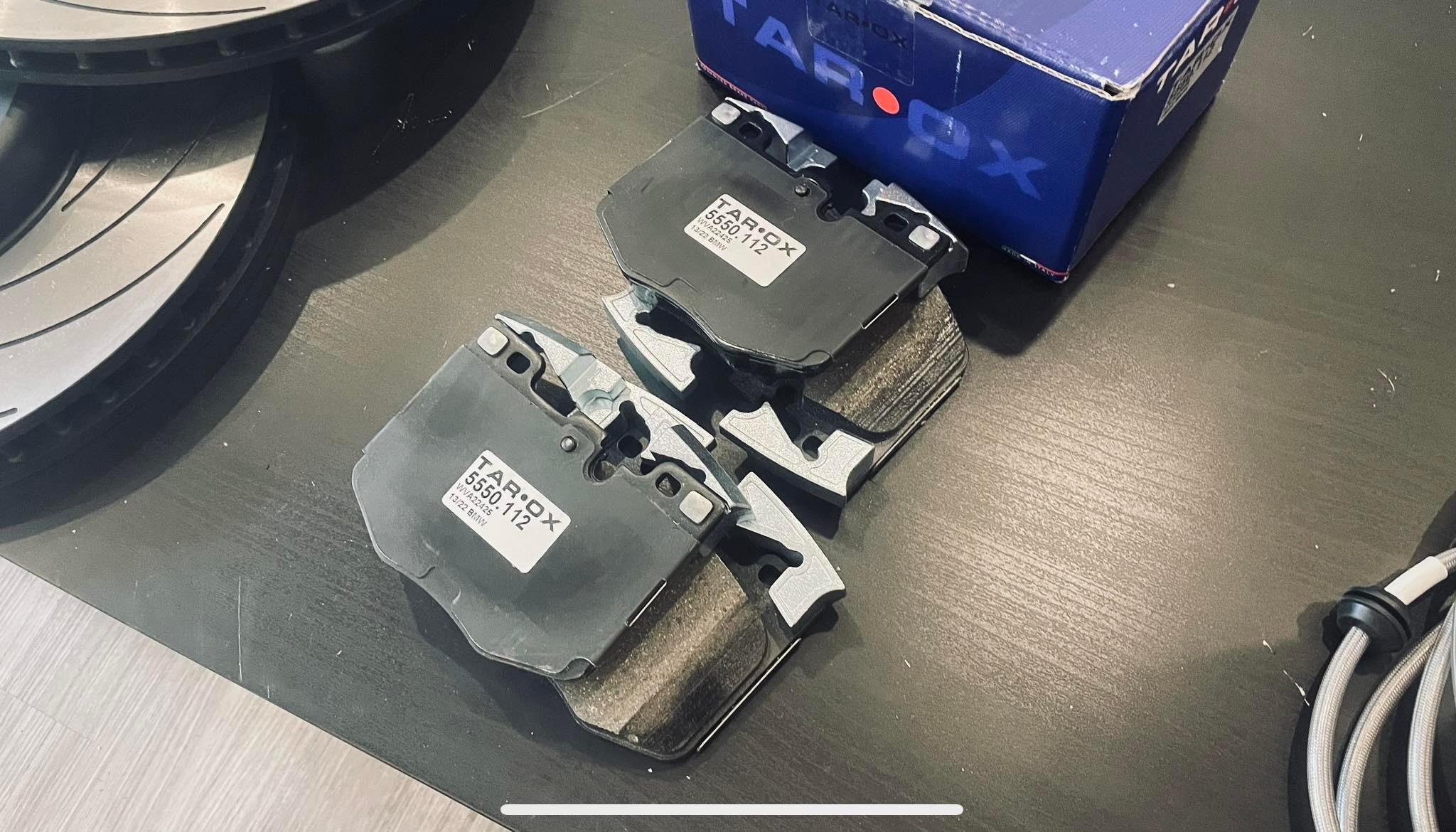

Brake pads come in 2 options, strada and corsa. Strada for daily/occasional track and corsa for more track applications.
Strada Specs:
Capable of withstanding temperatures of up to 600°c, this pad has an optimum temperature range of 200°C to 350°C.
Coefficient of friction:
Cold 0.37
Hot 0.42
Corsa Specs:
Capable of withstanding temperatures of up to 800°C, this pad has
an optimum temperature range of 250°F to 500°F.
Cold 0.47
Hot 0.49

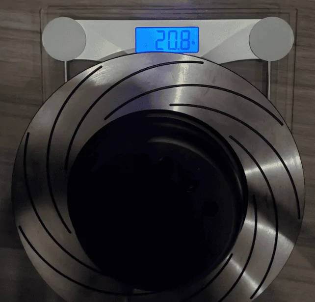

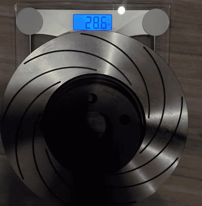

How much do the rotors weigh?
So fronts OEM are 28.8lbs, the Tarox are 28.6lbs so 0.2lbs weight savings. OEM rotors are 348x36mm, Tarox rotors are same dims 348x36mm
Rear OEM is 18.4lbs, the Tarox are a little more at 20.8lbs. OEM rotors are 345x24mm, Tarox are same 345mmx24mm

Update on 2lbs higher weight from the rear rotors, from Tarox:
Originally, we used a rotor that is the same “1 and a half piece” construction to the factory version, ie a steel outer with an alloy inner.
We are not able to use our heat treating process on rotors with this construction, so we switched to a fully cast rotor, that we can heat treat as we do with all of our other rotors. Yes, the rotor is a little heavier than the stock item, but the heat treating improves the performance and longevity of the rotor, and with it being on the rear of the car, the additional weight is not felt through the steering, so this was the route taken. Benefits far outweigh the negatives.
