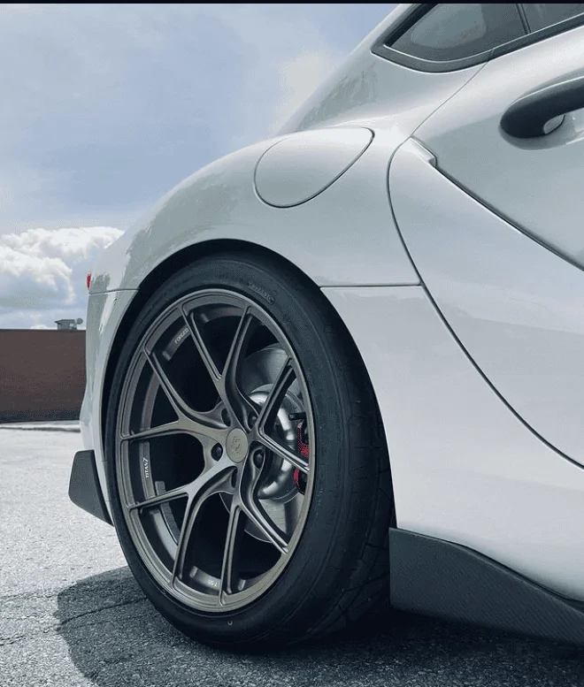

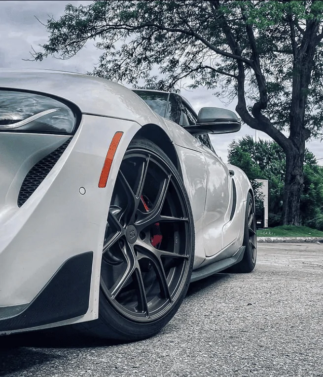

Our shop car:
Lowered about -1.5'' on Fortune Auto coilovers. Titan 7 Front is a 19x9.5 +34 and we did 275/30/19. Rear below is a 19x11 +40 and we did 305/30/19
Based on your wheel specs, you can do roughly the same tire size, the rear I'd recommend more a 295 with a 10.5
True, stock rear wheel is 10", maybe even just a 285. :(

Our shop car:
