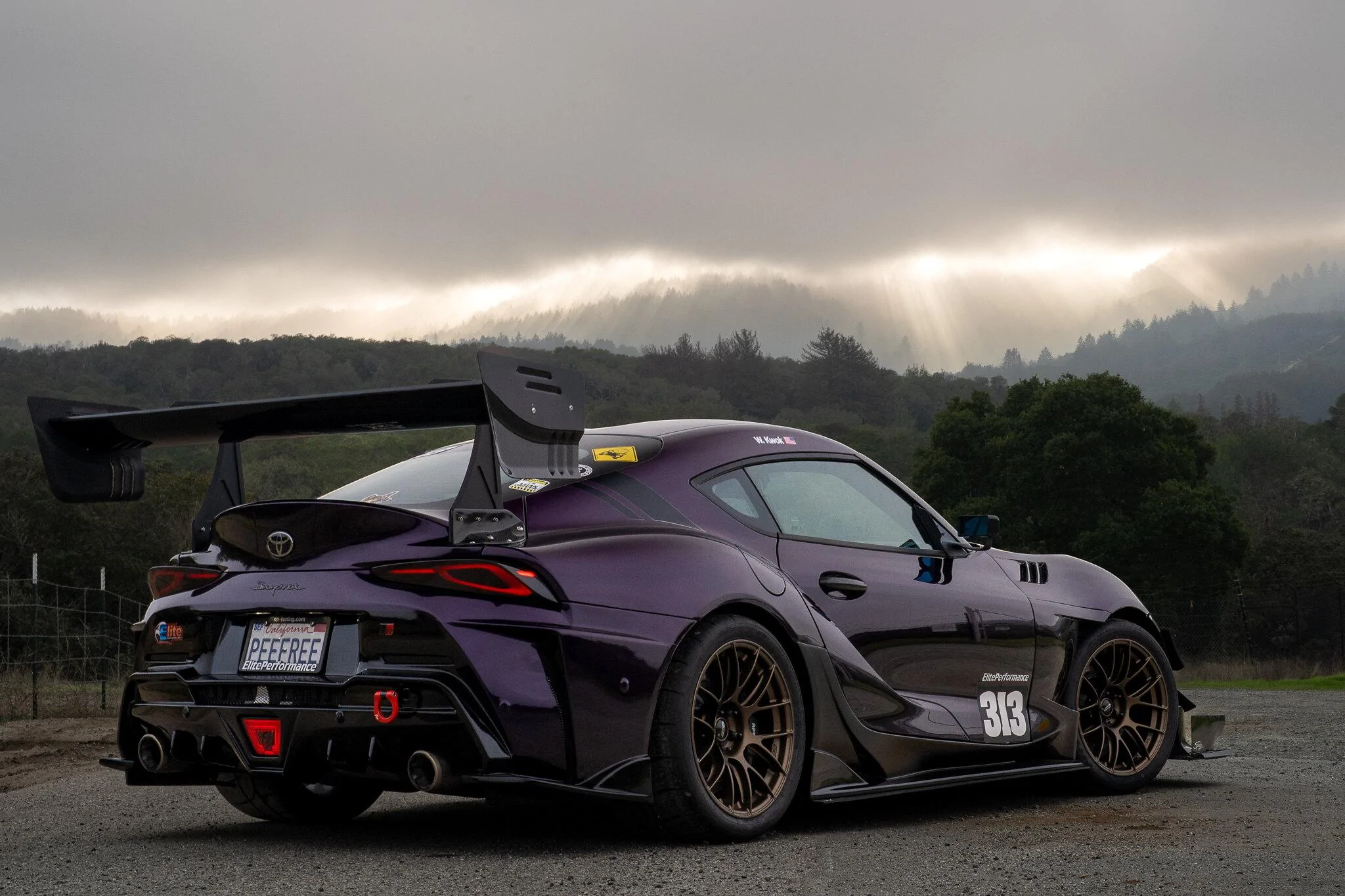

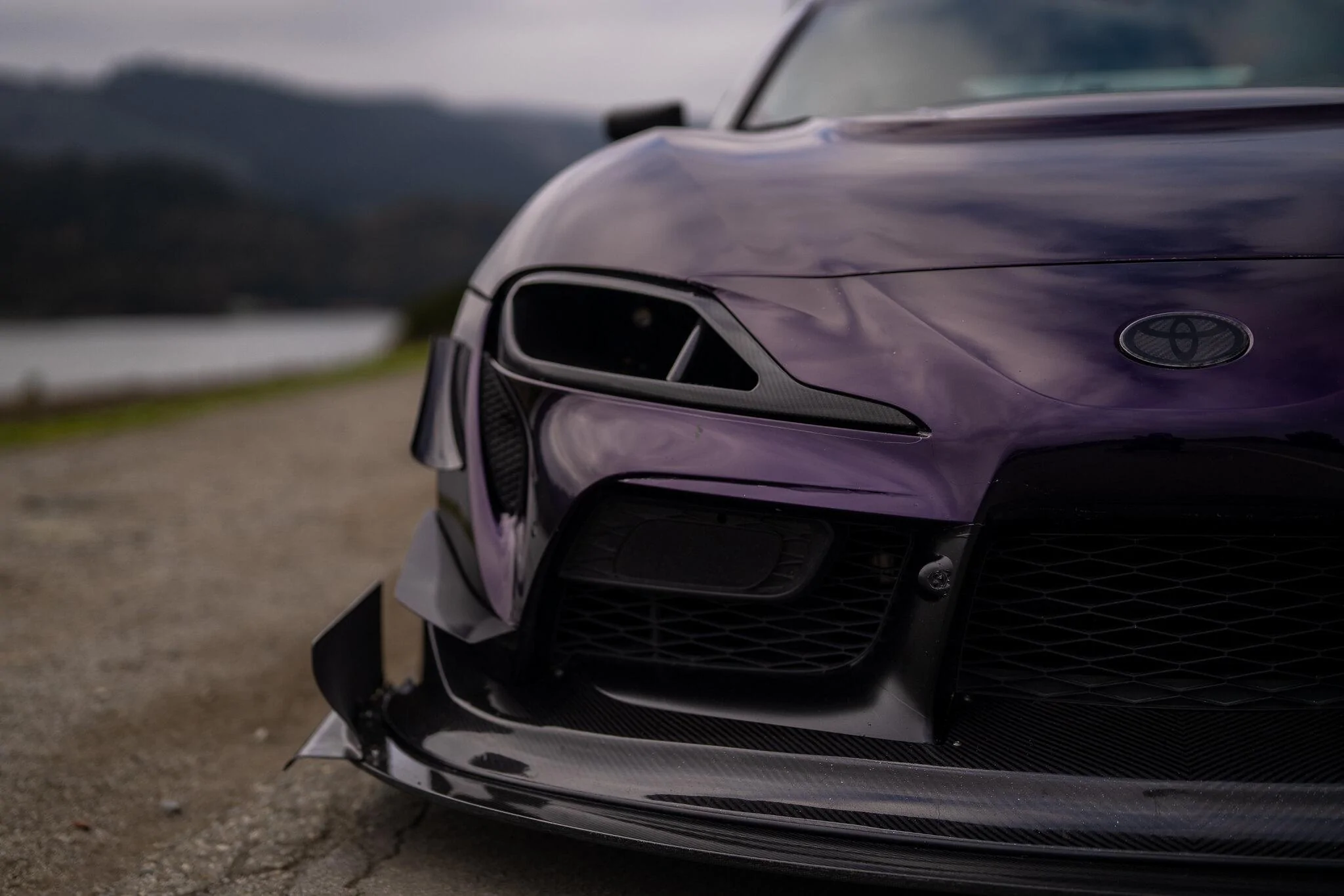

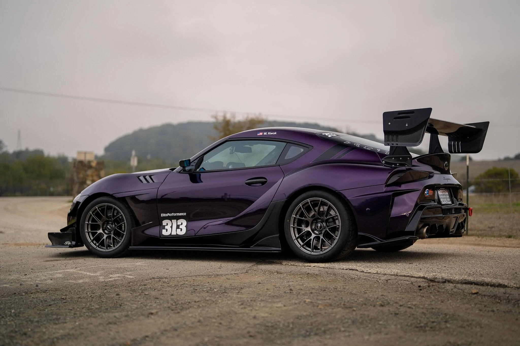

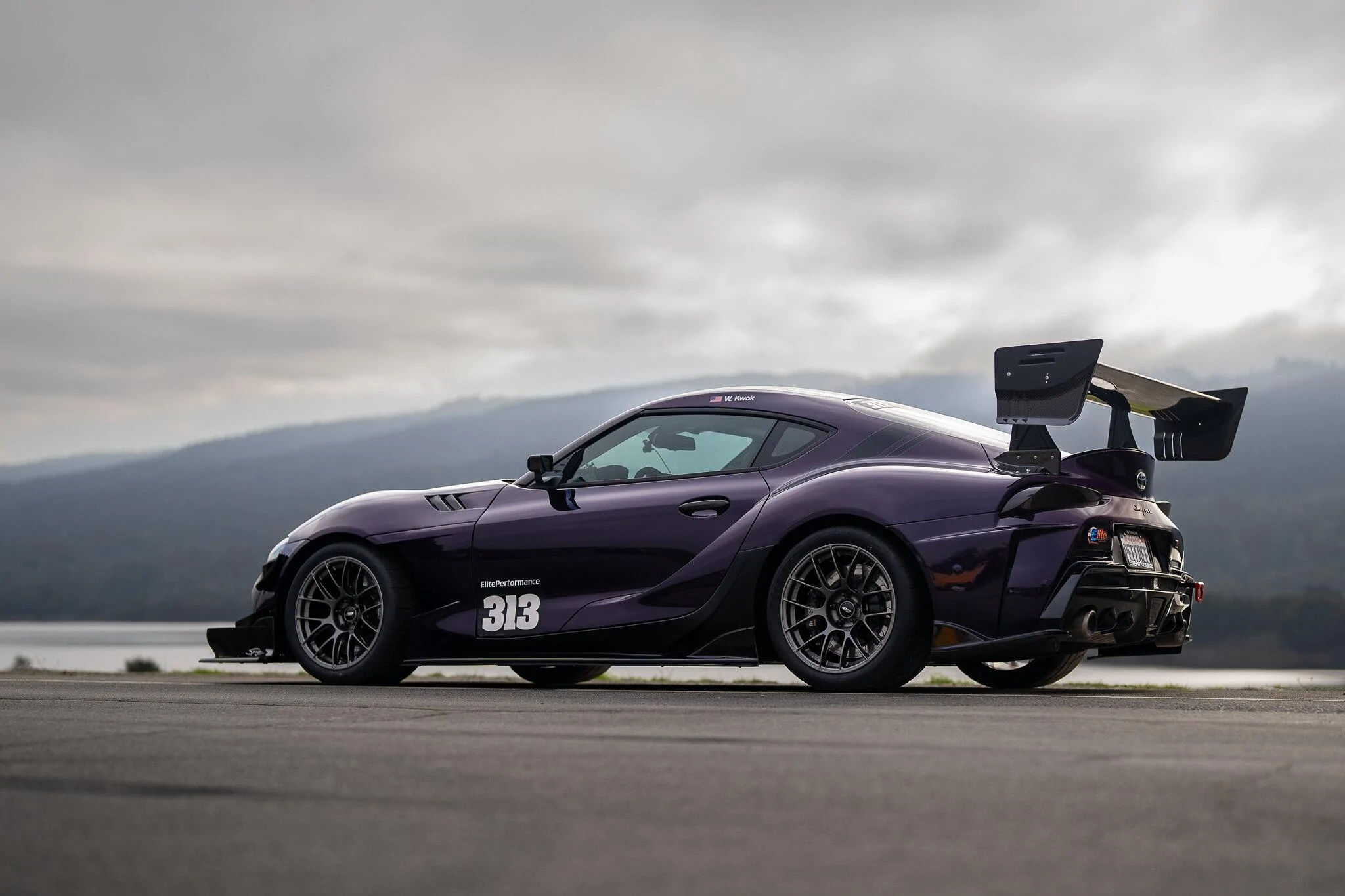

We recently had a chance to catch up with our friend Will to shoot his simply ridiculous 2021 Supra. The eye-catching purple wrap draws you in, but details abound on this track build and we hope that this thread helps to showcase this amazing build. Spage and Verus Aero catalogs are heavily represented and AP Racing Radi-Cal brakes haul the car down in the braking zones. As you would expect, the suspension is also heavily modified with MCS 3-way dampers and SPL Parts sprinkled throughout to give Will and Elite Performance, Will's performance shop of choice, complete control over his setup. The full mod list can be found below the images on this thread and Will's full build thread is located here: https://www.supramkv.com/threads/peefrees-a90-supra-build.6528/.
Power is next on the list with the supporting mods out of the way. I'm sure everyone on this forum knows the huge potential of the B58 in these cars, but with such a heavily modified and capable platform Will plans to begin pushing out some serious power while maintaining reliability once more options open up for locked ECUs.

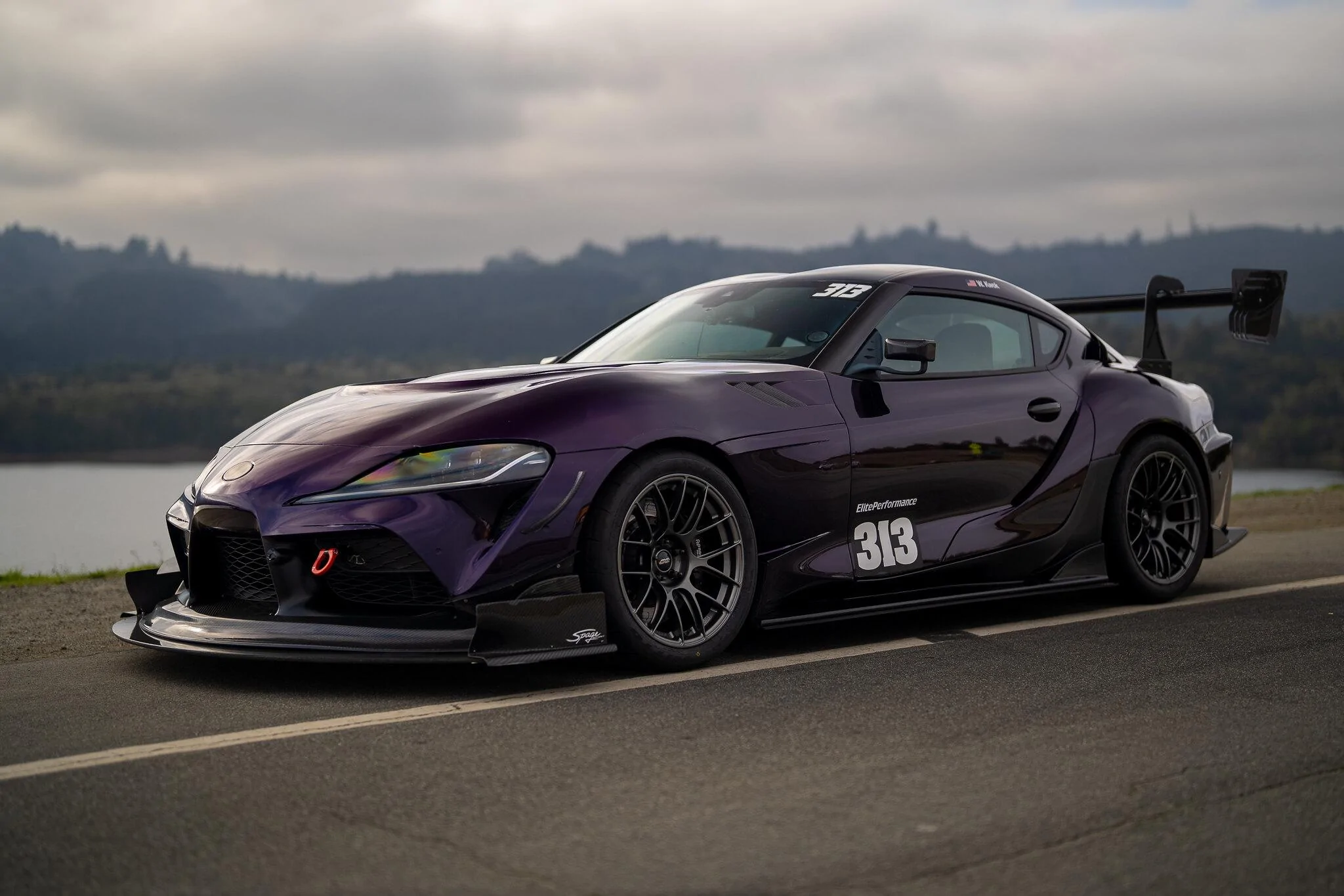

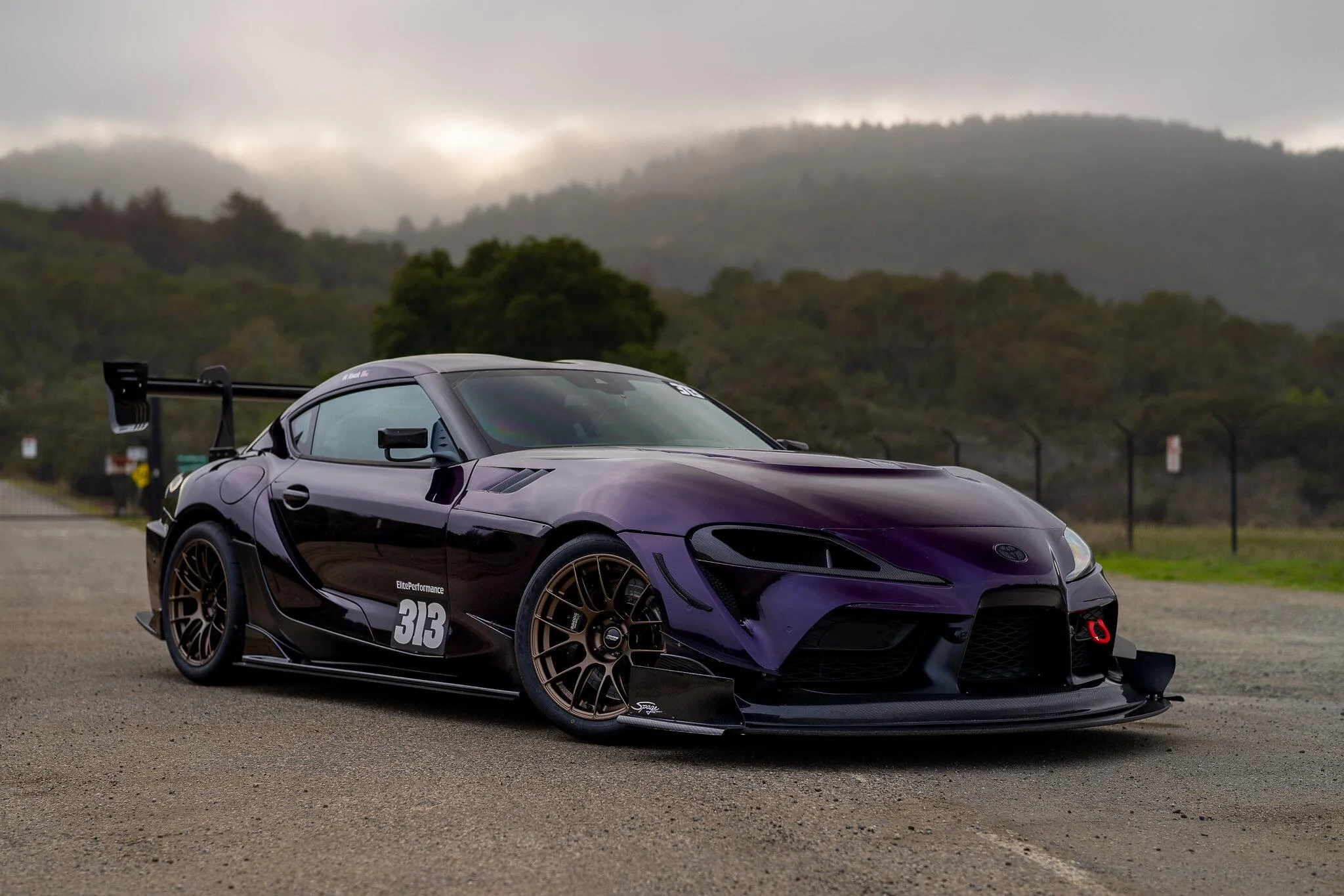

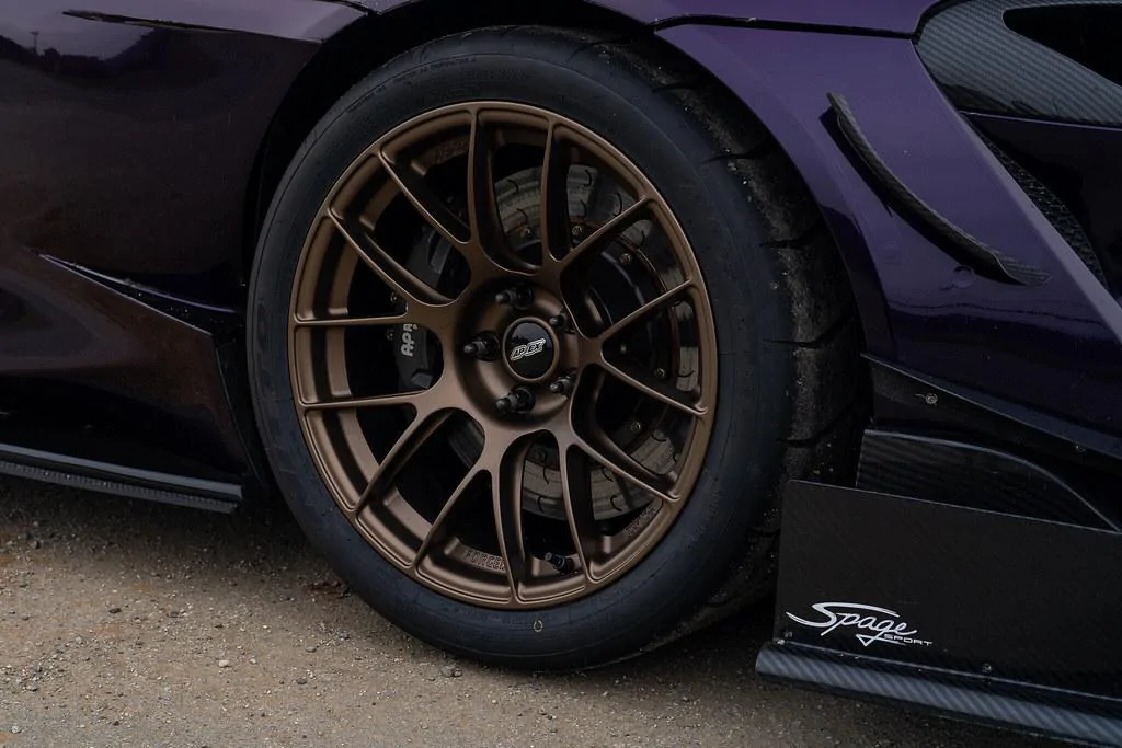

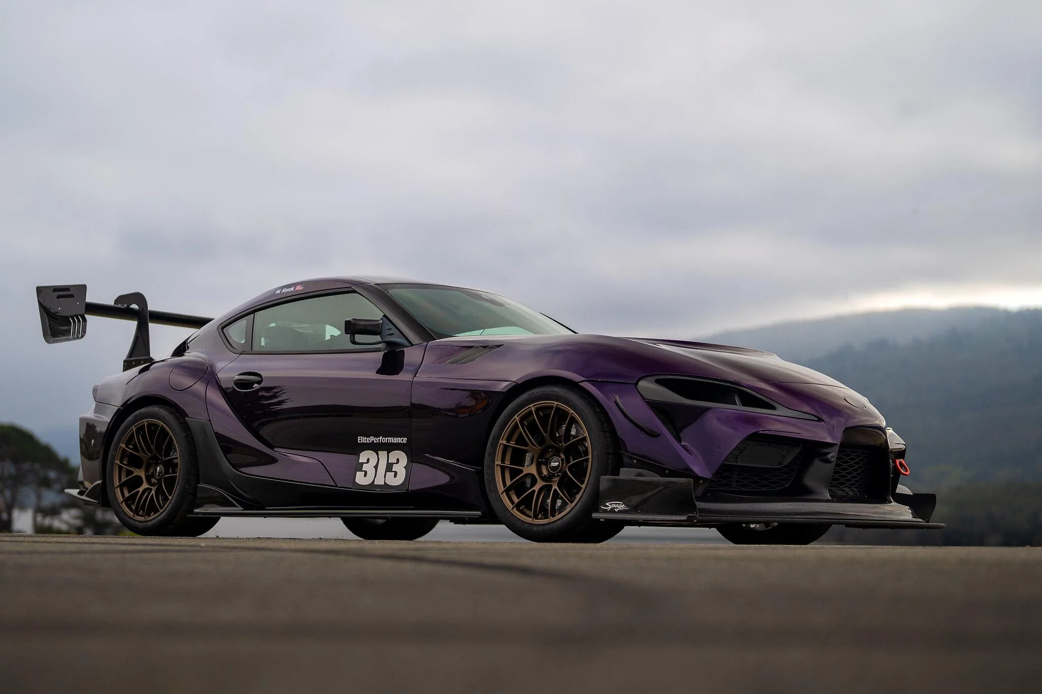

Our Sprint™ Line EC-7RS wheels are featured in this photoshoot. Will's car gave us the perfect opportunity to showcase our aggressive 18x11 ET40 square fitment but this fitment is just the beginning of APEX forged wheels on the A90 Supra platform. We have less aggressive square and staggered fitments arriving in the future.
This 18x11 ET40 fitment is the widest square wheel and tire package we recommend for the Supra. Aftermarket suspension and additional negative camber are required for front clearance, but the ability to run up to a 315 section front tire allows track-enthusiasts to rotate wheels and tires between the front and rear axles and provides an enormous increase in overall front-end grip.
With a headlight sacrificed in the name of speed, this Supra's days of getting the groceries and quick errands have for the most part been exchanged for fast laps and chasing that final few tenths along with Porsche GT cars. Not everyone may like the sound of that, but we love the sounds of warning messages in the morning.
Wheels & Tires:
Wheels:
Front & Rear: 18x11 ET40
Tires: Nitto NT01
Front & Rear: 315/30-18
Alignment:
Front: -3.5° Camber
Rear: -2.2° Camber

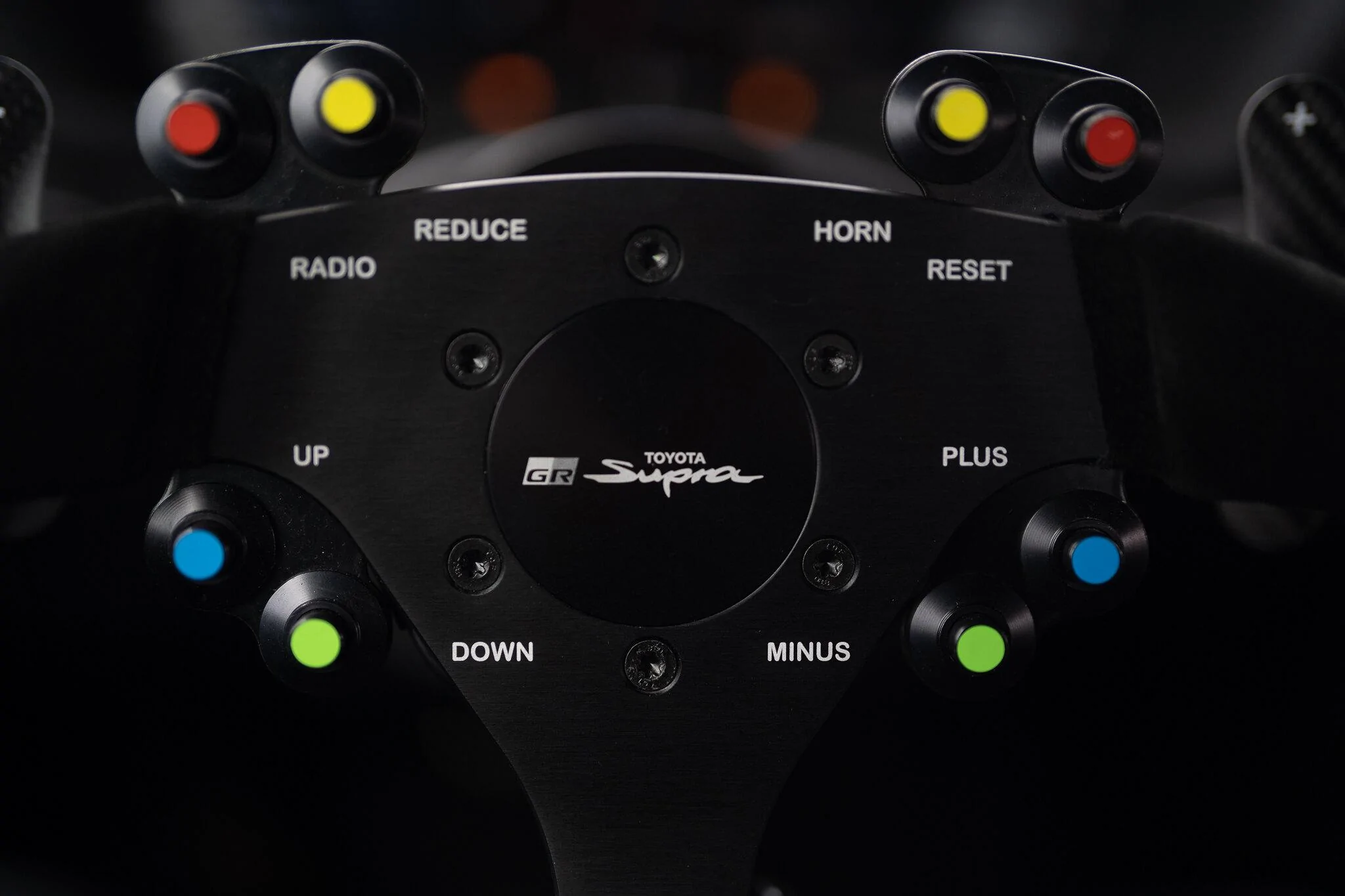

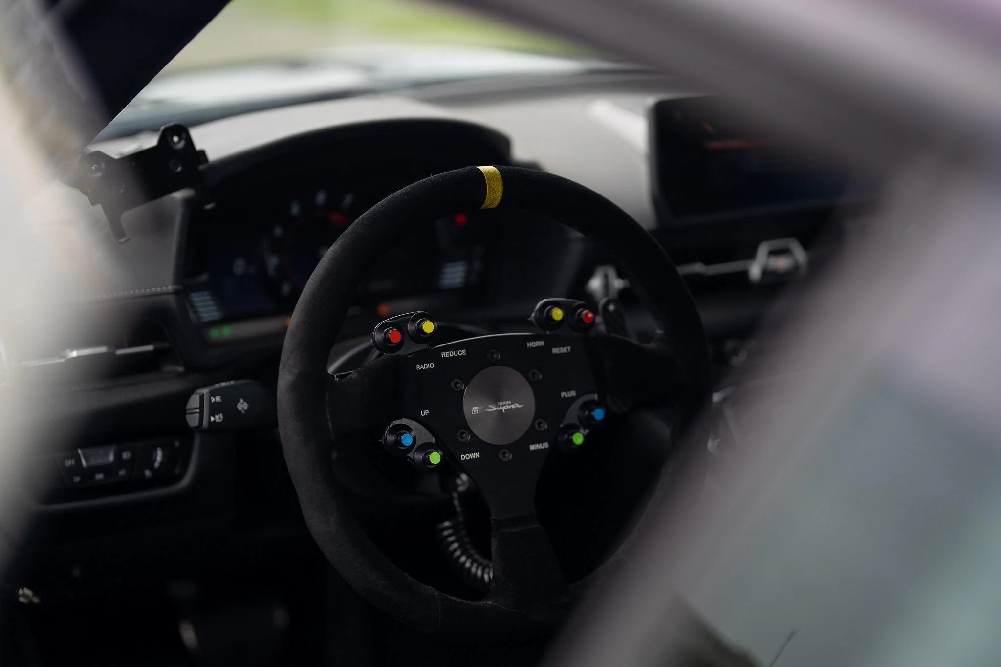

  • EastcoastSupra custom steering wheel w/ shift indicator
  • Autotechnic Carbon shifter paddles

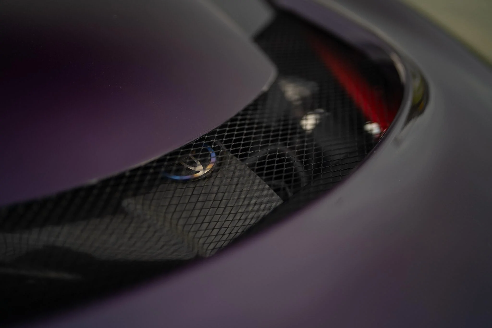

There's actually a tiny light light installed on the inside of the intake duct so the thing is TECHNICALLY still legal to fetch groceries. :p
