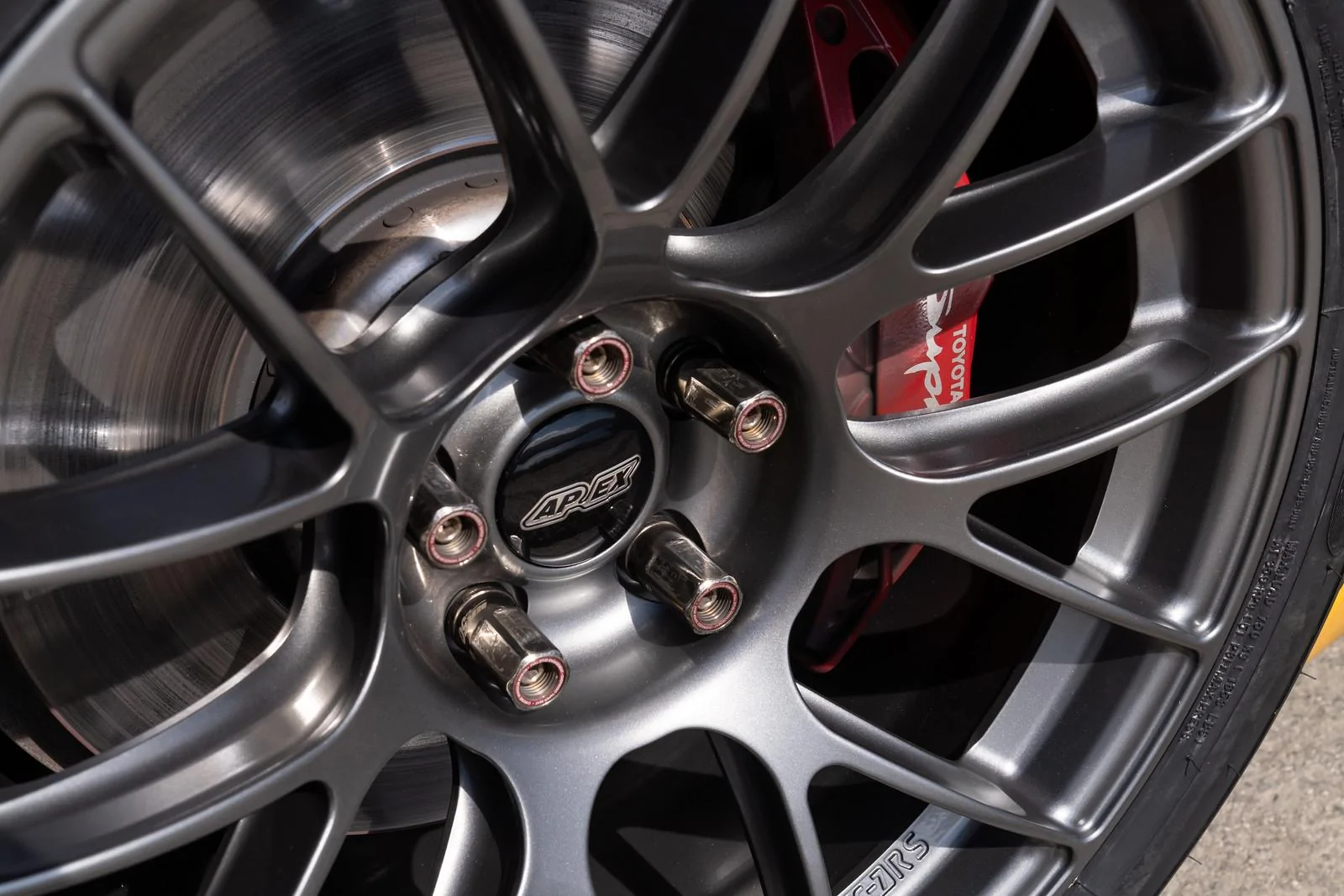

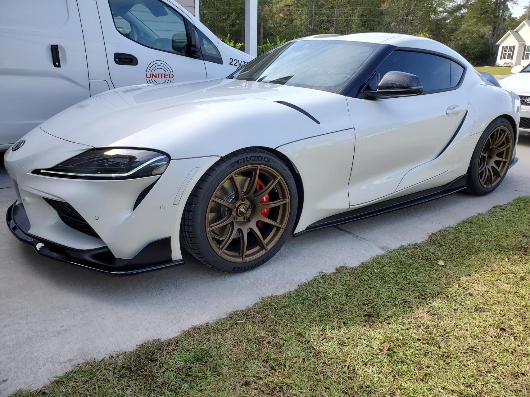

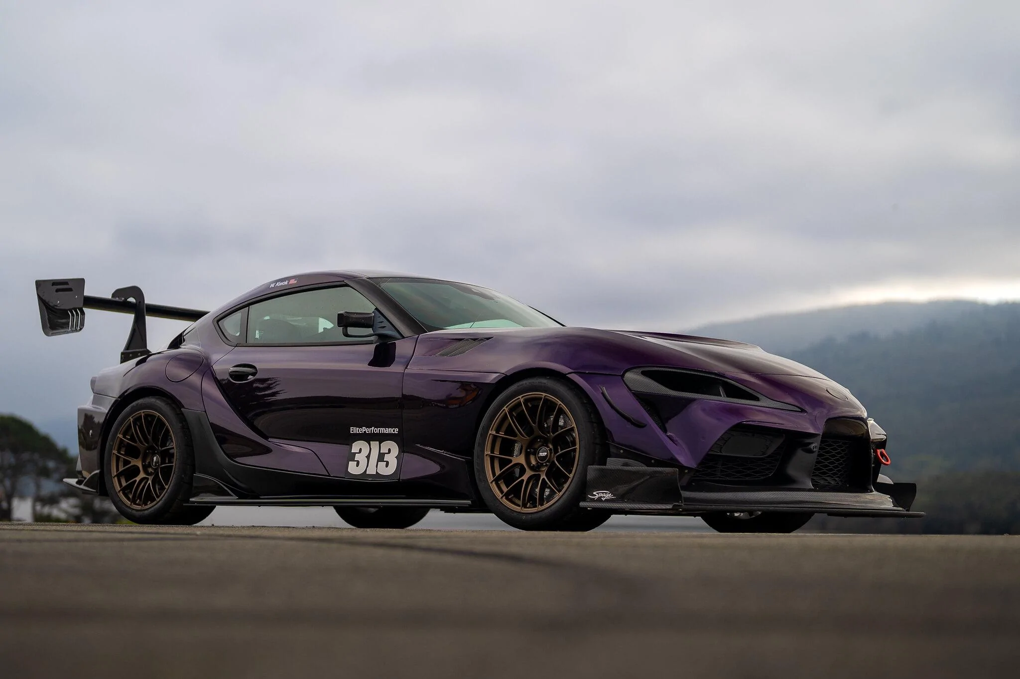

We are very excited to have officially launched our GR Supra wheel program! The purpose of this thread is to compile on-car photography of APEX forged and flow formed wheels on GR Supra’s, while providing the community with detailed information surrounding wheel and tire fitment, alignment settings, brake and suspension clearances, and more. Please feel free to ask questions along the way, we have experts ready to provide technical support. If you would like to learn more about our Forged and Flow Formed Supra wheels, please visit our introduction thread.

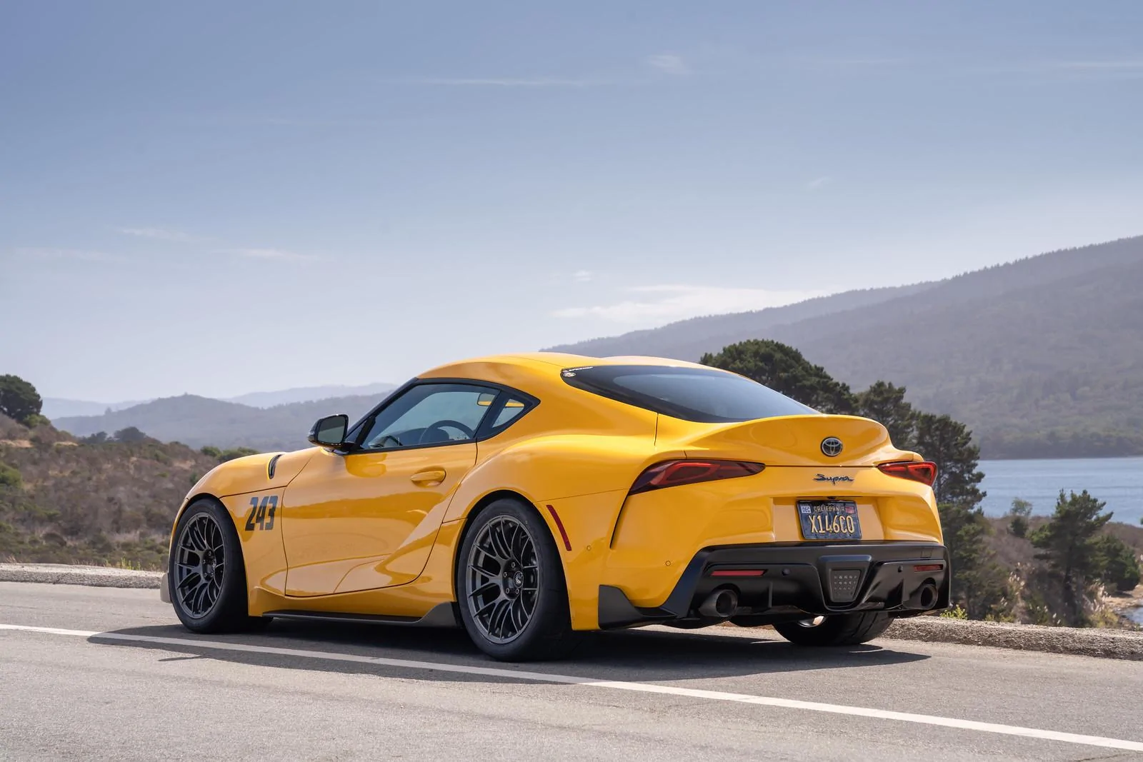

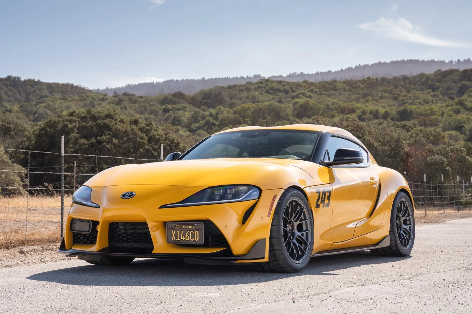

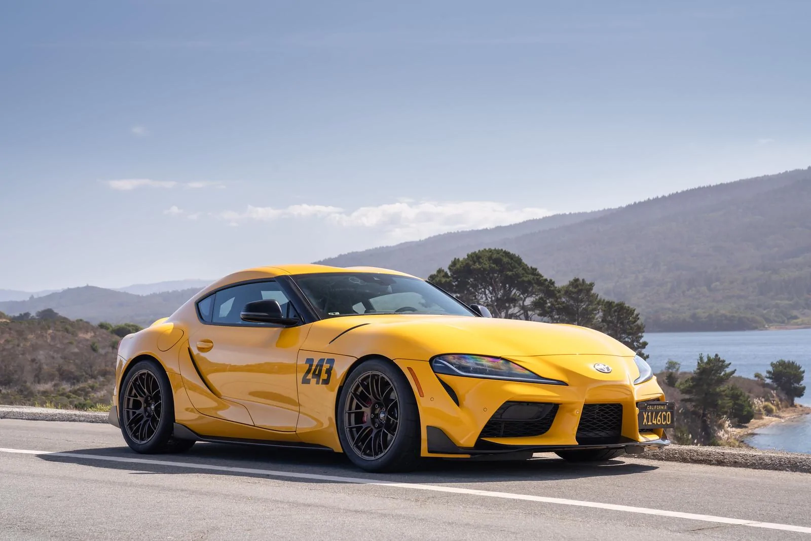

We'll go ahead kick things off by showing off a favorite photo of each of our available designs:
18" Forged EC-7R
click here to learn more
APEX Forged EC-7R in Brushed Clear
F&R. 18x10.5” ET38 - 295/35-18 Yokohama A052
MCS 3-Way Suspension - True Rear Coilovers
SPL Lower Control Arms and other suspension bits

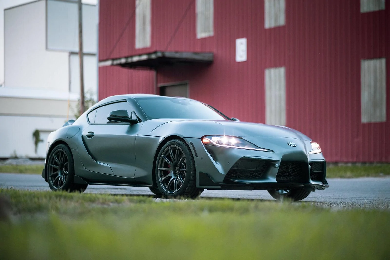

18" SM-10
APEX SM-10 in Anthracite
F: 18x10” ET30 - 275/40-18 Yokohama A052
R. 18x11” ET40 - 295/35-18 Yokohama A052
Megan Racing Coilovers

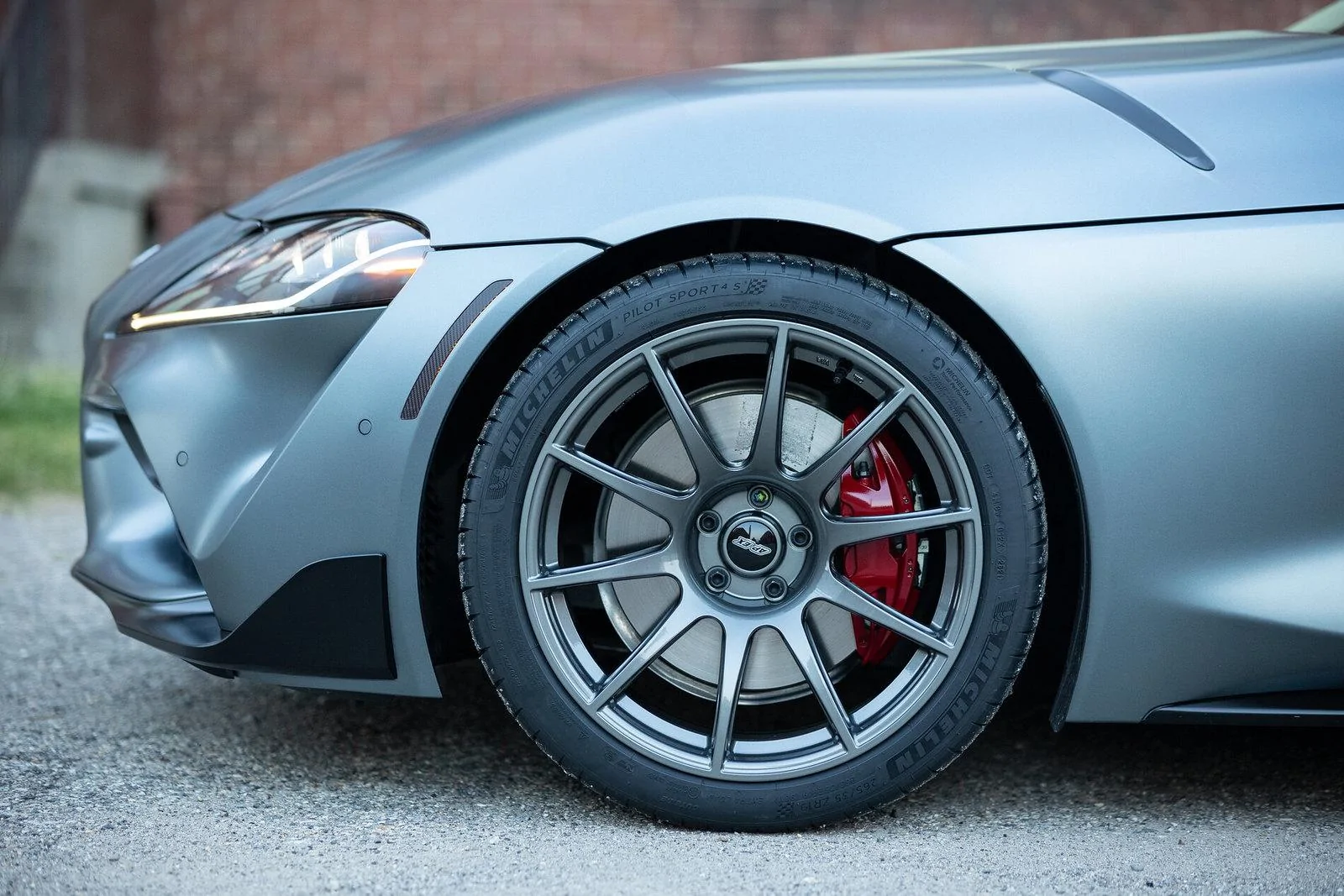

19" SM-10
APEX SM-10 in Satin Bronze
F: 19x9.5” ET25 - 275/30-19 Michelin Pilot Sport 4S
R. 19x11” ET40 - 305/30-19 Michelin Pilot Sport 4S
- Ryan

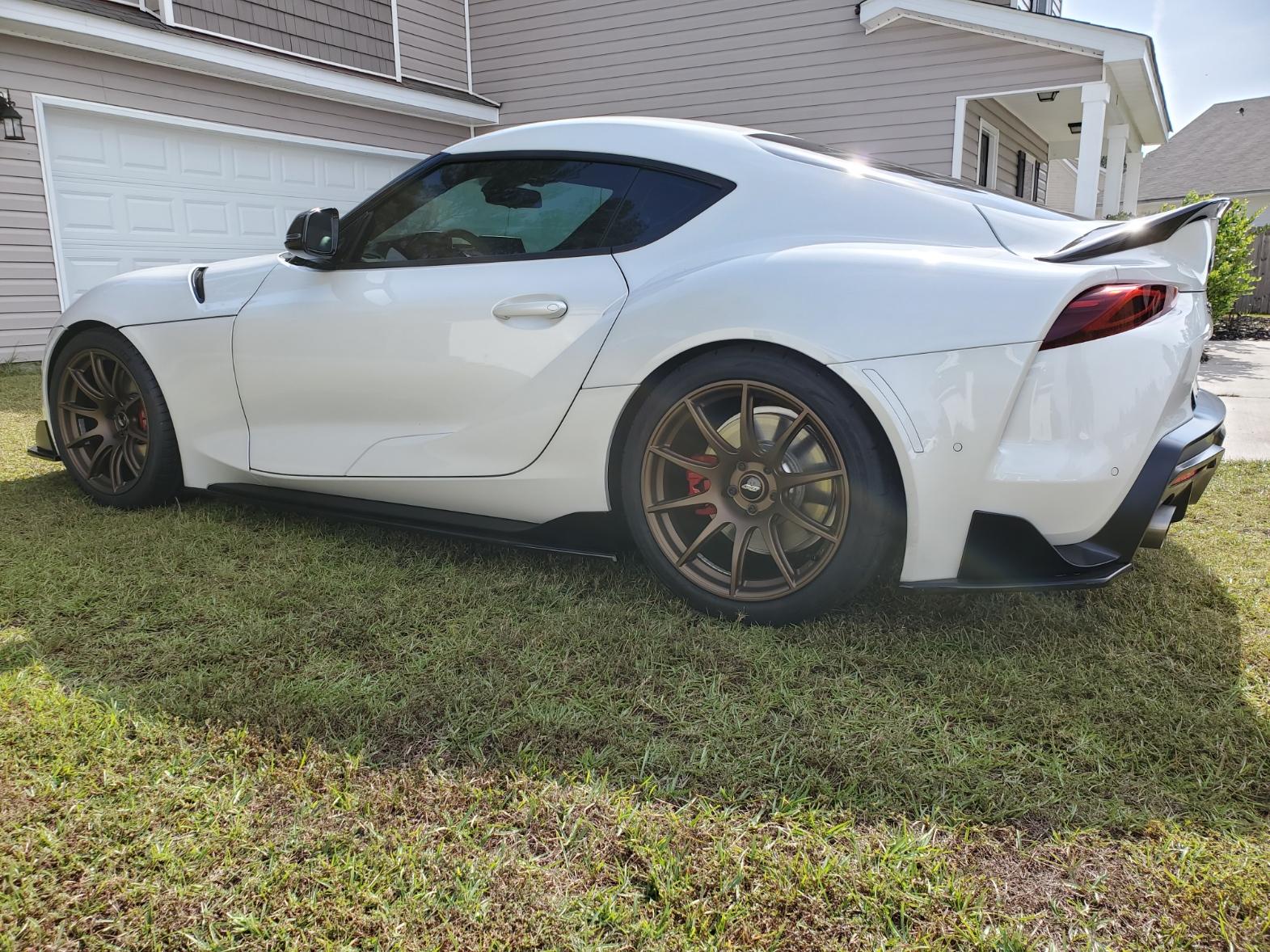

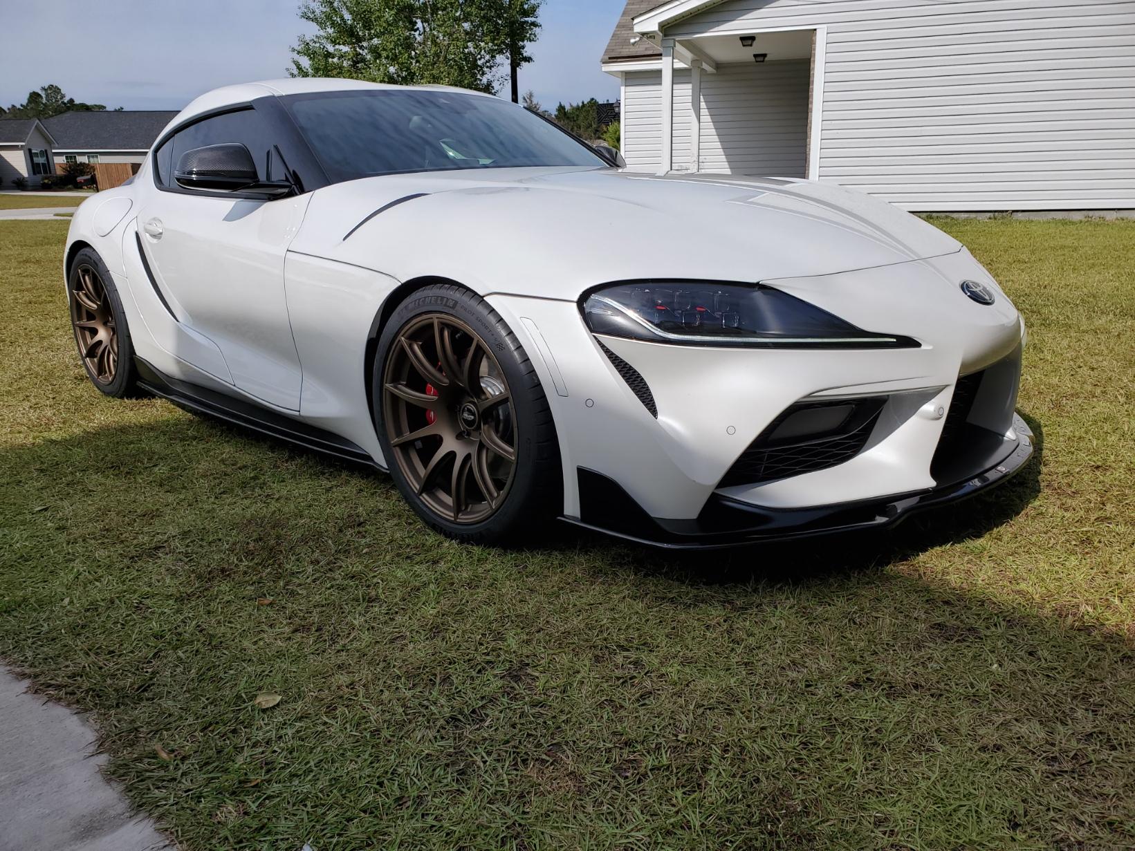

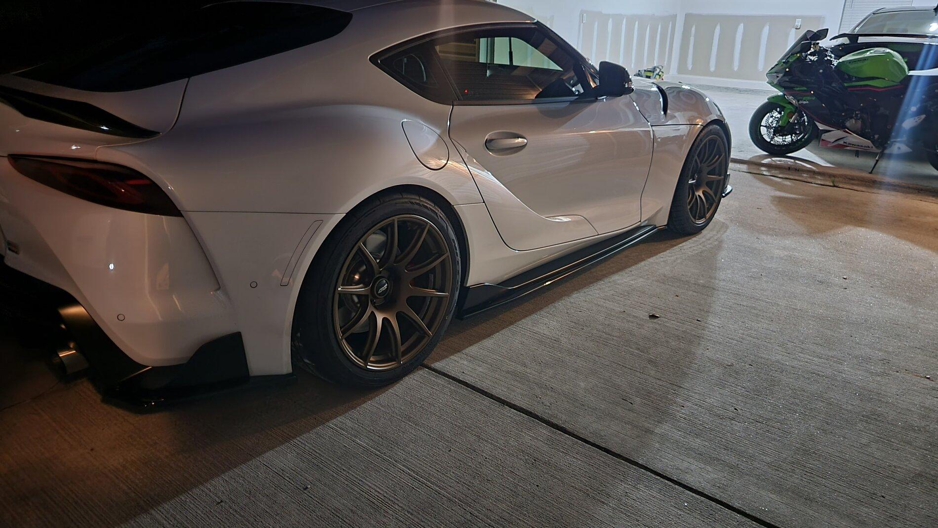

I ordered a set of the 19 " Staggered wheels in Satin Bronze today. They will be going on an Absolute zero 2021 supra thats lowered on the EU spec Z4 springs, a .8" drop front and rear. Can't wait to get these wheels.

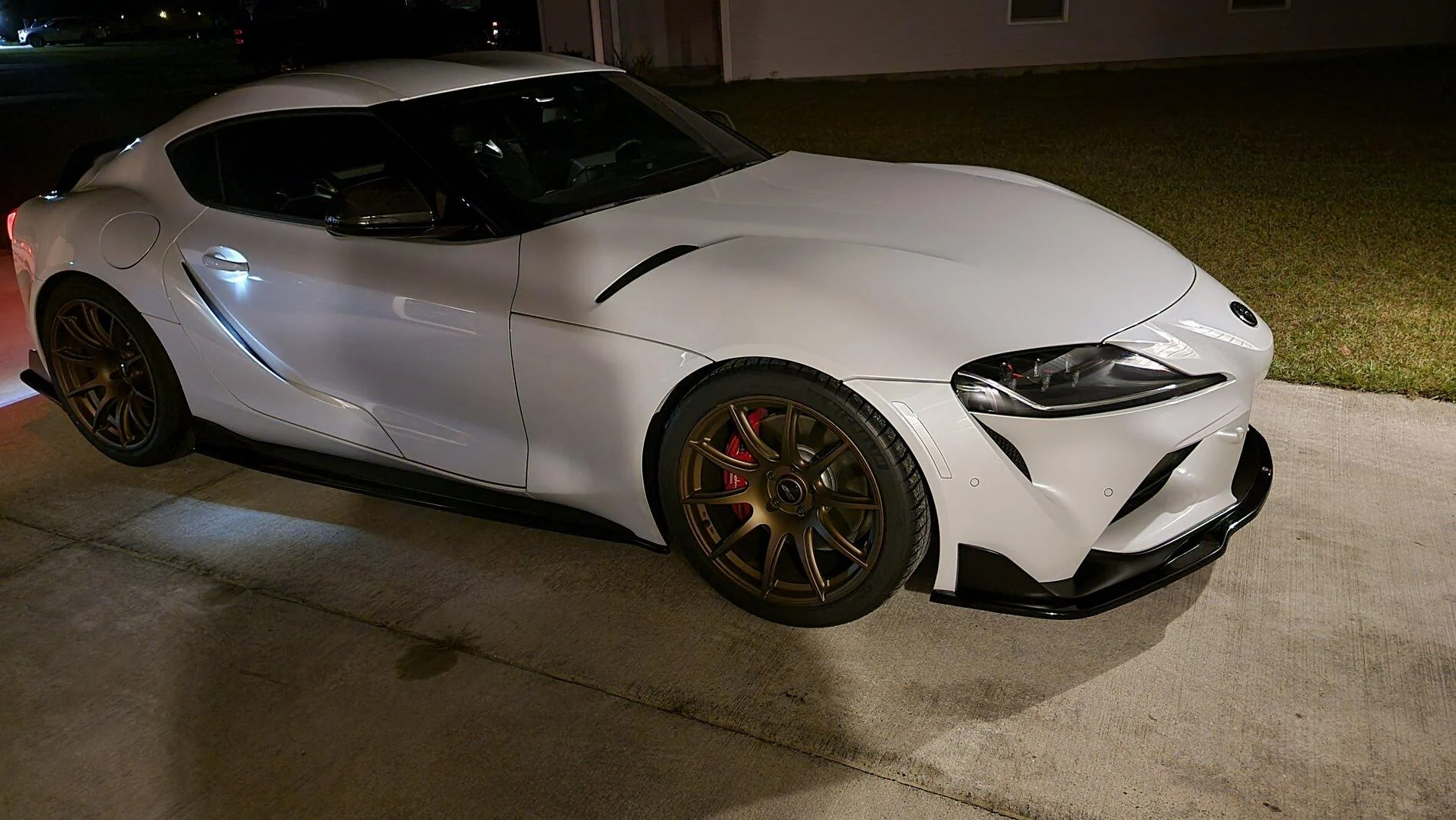

Has anyone had any issues with Michelin PS4S tires not wanting to seal properly at the bead on the Apex SM-10s? My local performance shop got my Nitto 555R2s seated perfectly fine but the PS4S's had a very slow leak from the bead. They ended up having to use Bead Sealer. Does this sound right at all?? I should note this was on the backside of the wheel/tire, not the front side. I'm kind of worried to drive the car like this.
The wheels are the Apex 19x9.5 and 19x11 setup and the tires are PS4S 265/35/19 for the front and Nitto 555R2s in 285/35/19 for the rear.
Both the inner and outer portions of our SM-10 wheels have knurling along the bead seats. These are small machined cuts that run along the surface of the seat:
This knurling helps keep your wheels and tires balanced on track or in situations where you are braking heavily or accelerating rapidly. On a standard smooth bead, the tire can slide along the surface over time which gradually unbalances the wheel and tire. The knurling helps reduce this slippage ensuring your drive home from the track is smooth.
These small cuts can make getting a seal at the bead when initially mounting the tires more difficult. We generally recommend airing up the tire that is leaking to the maximum pressure specified on the sidewall for a few minutes to help seat the bead. You can drive slowly around the block if needed at the higher pressure to help them seat as well. After a few minutes, deflate the tire to the recommended PSI for your car. This fixes the leaking beads without the need for any bead sealer in the cases we've seen so far. Your car should be safe to drive and you can monitor the tire pressures as needed for the first week or so just to be sure.
Let us know if you have any other questions!

Thank you for this information. I recognized the knurled section on the front section of the wheel but didn't notice the knurled section on the back section of the wheel. I informed the shop of the front knurled edge but didn't tell them it was like that on the back side. I'm hoping this was the issue. The shop did end up putting 40lbs of air in the tires when they mounted them the second time, as well as the bead sealer, and so far the wheels have been sitting in my garage and haven't leaked any air.
I just wonder why the Nittos went on so effortlessly with no bead issue and the PS4S had the issue. Ohh well, like I said, thanks for reaching out and I will make sure to update once the wheels have been installed on thr car and its been driven some.

So update to my last post. Wheels and tires are on the car and so far the PS4S's are holding air just fine at 42 PSI, no leaks so far and I went for a 15 minute drive. Car looks amazing with these SM-10's. I will be getting better pics in the day light later on.

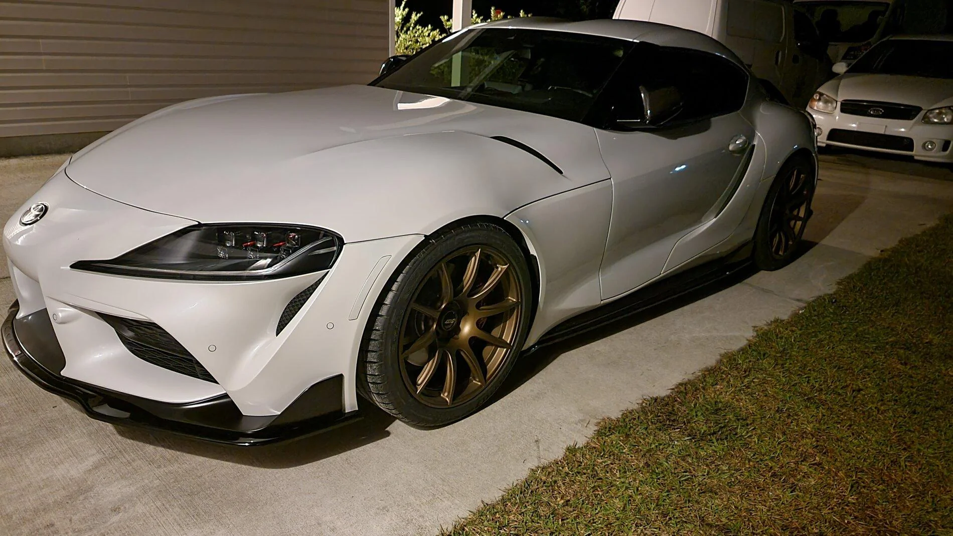

Satin Bronze has been getting a ton of love and rightfully so, but I thought I'd share these customer photos of some 19" Anthracite SM-10s.
Wheels:
Front:
19x9.5 ET25
Rear: 19x11 ET40
Tires:
Front:
255/35-19 Michelin Super Sports
Rear: 305/30-19 Toyo R888Rs
Additional notes:
Lowered on coilovers
Owner's IG: @SUPRAJHAY
- Tom -​

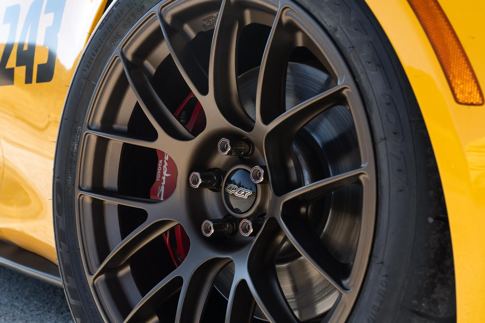

APEX Sprint Line EC-7RS on Nitro Yellow
Wheels:
Satin Bronze and Anthracite EC-7RS
Front & Rear: 18x11 ET40
Tires: Nitto NT01
Front & Rear: 315/30-18
Additional notes:
Minor rubbing noted at full lock up front
Suspension:
HKS height-adjustable sleeve kit
SPL Caster Bushings
Alignment:
-3.4° front, -2.4° rear
More Info / Group Buy
- Tom -​

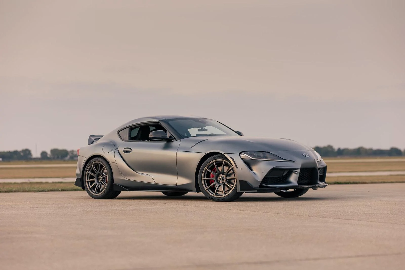

That is correct. It should be a bolt on fitment for you! Here are some photos to give you an idea of that it looks like:
Wheels: Anthracite SM-10s
Front: 19x9.5 ET25
Rear: 19x11 ET40
Tires: Michelin PS4S
Front: 265/35-19
Rear: 305/30-19
Additional notes:
Stock suspension, Factory alignment.
Customer IG : @jeisfoto
-Tom-​

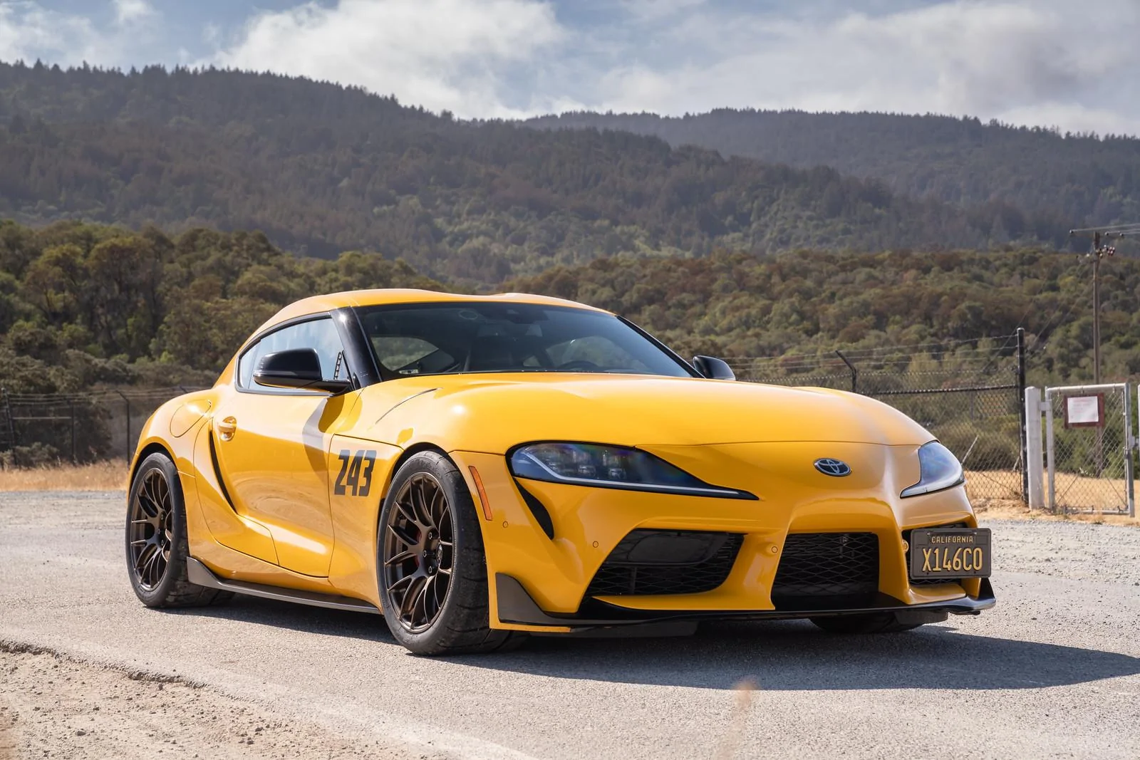

Wheels & Tires:
Wheels:
Tires: Nitto NT01
Alignment:
Front: -3.5° Camber
Rear: -2.2° Camber
A full Feature Thread is live in our sponsored section, but we figured we'd drop in the video taken during our photoshoot as a teaser. Head over to the full thread to view more photos and a full mod list!
