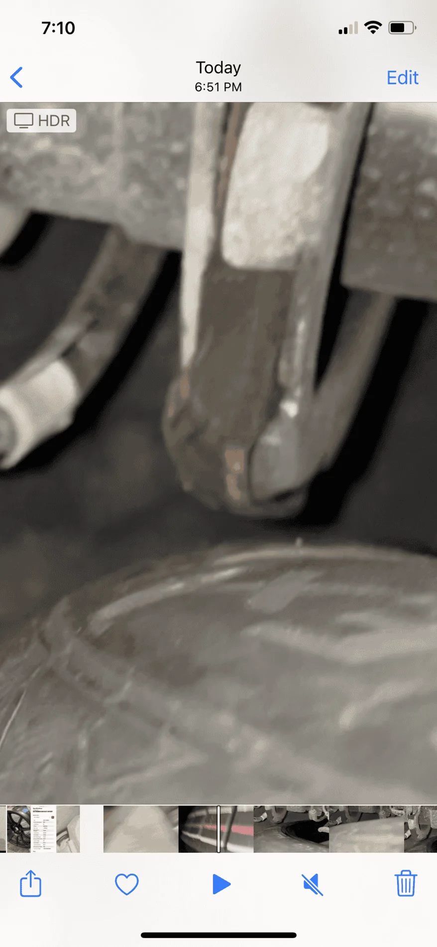

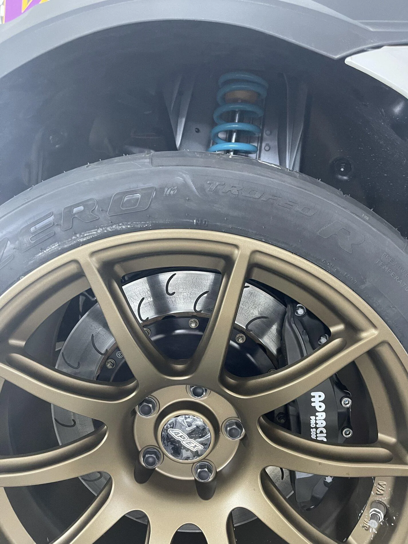

I would be interested to hear how much room the 5mm gave you clear after installing them. Based on Tirerack.com, your tire had a section width of 11.6”, and your overall diameter is 26.0”.
here’s a photo I took earlier of the OEM clearance, it may be closer to 1/2”, hard to tell.
More details on some of the tire sizes we've seen on the 18x10 ET30s can be found here with fitment photos and tire details as well. Feedback from the testfit this weekend: the A052s do not actually clear the front spring perches without spacers. It looks like that tight front clearance was missed during the initial testfit and photo sessions which led to a bad data point on our end.
-Tom

Ok. Continental 265/40r18 appear to fit, if only by few mm.
You just beat me with my second post by a minute! Good to know the Continentals clear. Do you mind if we incorporate this into the article I just linked?
-Tom

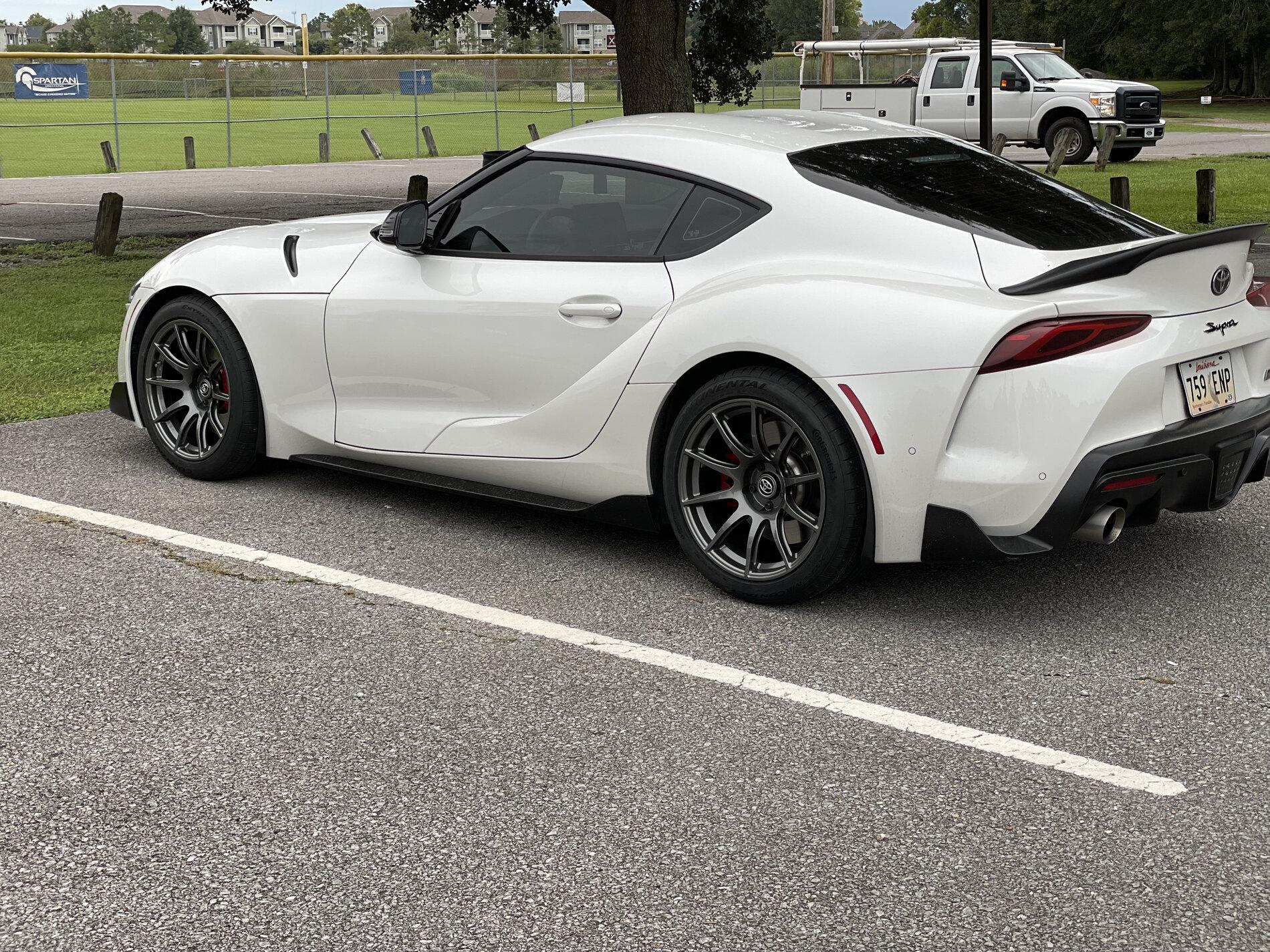

Ok. Wheels on, mud flaps on, no rubbing.
Stock suspension
Front. Continental Extreme Contact Sport 265/40r18
Rear Continental Extreme Contact Sport 295/35r18

Thanks for the fitment confirmation and the image! The car looks great on the SM-10s.
-Tom
