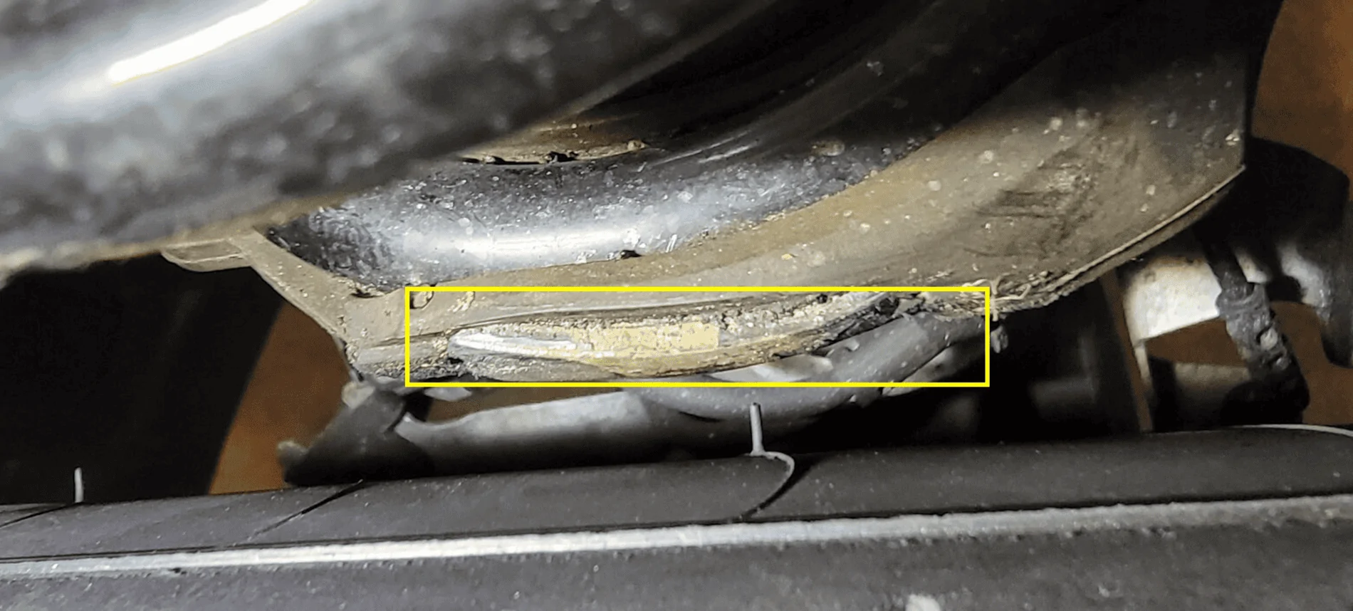

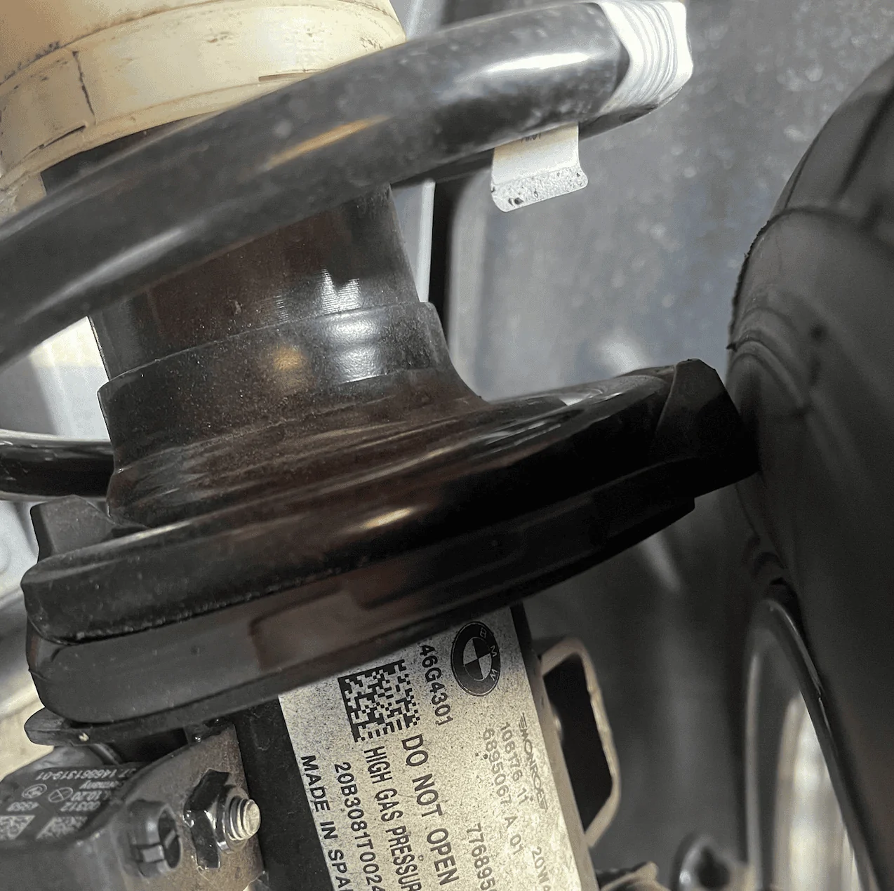

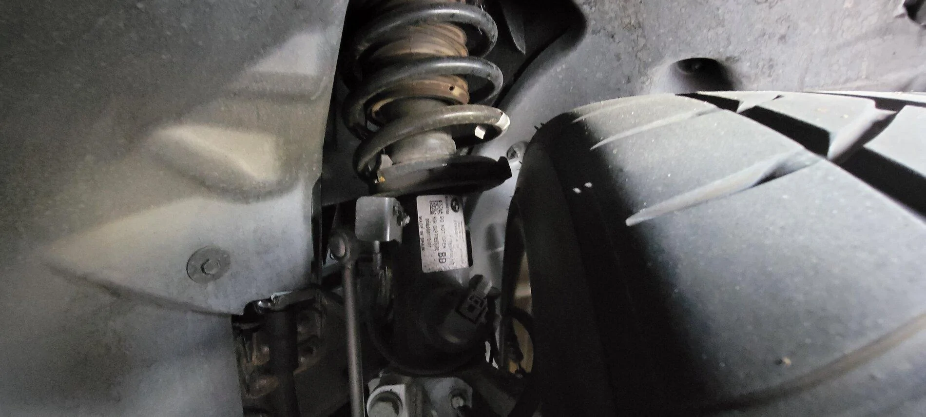

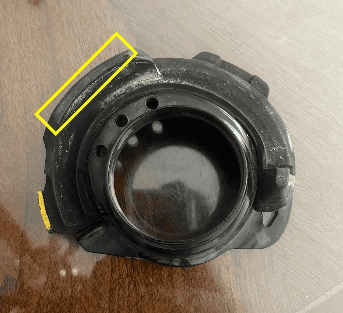

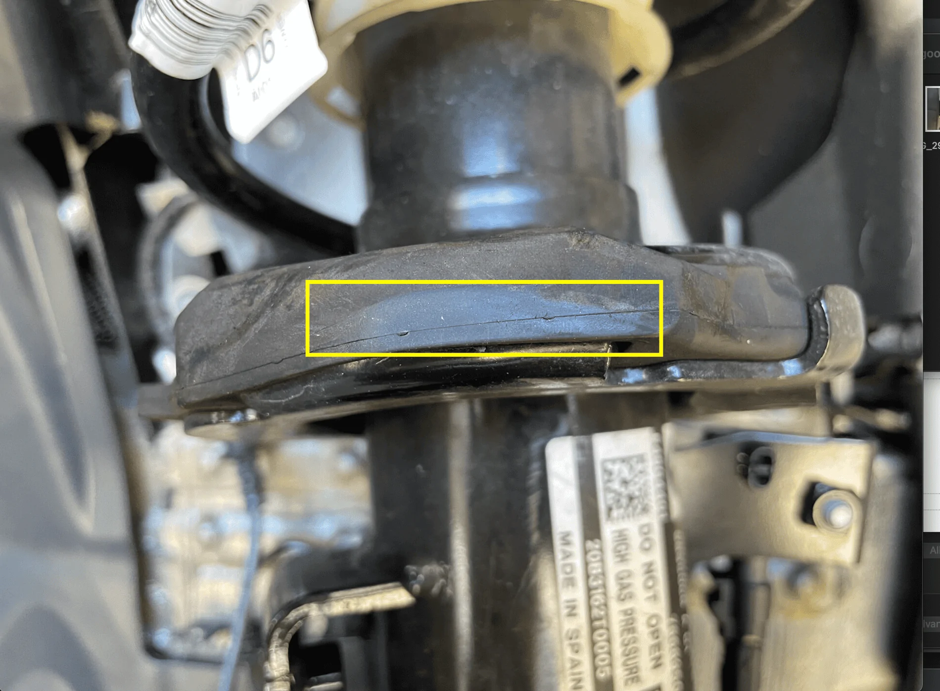

The front OE spring perch within the A90 Supra wheel wells is the limiting factor when it comes to tire clearance with this chassis. The perch captures the lower end of the spring and consists of a metal plate and rubber isolator pad. The portion of the pad that comes into contact with a wide wheel and tire package can be trimmed or allowed to "self-clearance" to gain a few more mm of clearance on the inner edge but the plate would have to be ground down slightly to improve any clearance if the steel perch is contacting the tire. Aggressive tire models that run wide in taller 18" fitments like 275/40-18 can contact not only the rubber isolator on the spring perch but also the metal perch beneath. Here are some images of the strut assembly and perch itself with the potential areas that might experience rubbing highlighted:

This limited clearance with the OE suspension affects the models and sizes of front tires you can run on these wheels as a direct fit. This will also inherently limit your rear tire size if your goal is to run these wheels and tires as a rotatable fitment. There are several options to improve inner clearance that do not involve the tires themselves:
  • Upgrading to aftermarket suspension with better inner clearance
    • Upgrading to a coilover with a smaller overall diameter than the OE spring and perch configuration or a reduced stack height that moves the springs up and away from the tire will improve inner clearance. Motorsport-oriented coilovers like MCS or JRZ will tend to have a more compact design and a slimmer overall silhouette that will maximize inner clearance on most applications.​
    • This is obviously the most expensive option and should be done for improved suspension performance with better inner clearances being a secondary benefit of the upgrade.​
    • Certain HAS (height adjustable spring) kits we've tested have increased inner clearance. We have a customer running an HKS HAS kit with 19x11 ET40 wheels up front without spacers. Not all HAS kits will increase inner clearance though so purchase with care.​
  • Running a front spacer
    • This is the simplest option for customers looking to run taller tire configurations in aggressive models of tire that run wide.
    • Spacers move the wheel and tire package away from the strut and spring perch. 5mm spacers have typically been enough to resolve any rubbing issues with the tires we've seen and leave enough of the OE hubcentric ring exposed to keep the wheels hubcentric and prevent vibrations.
    • Be sure to run extended-length bolts or a stud conversion kit with any wheel spacers.
    • The spacer may move the wheel and tire out enough to create contact between the upper portion of the tire on the outside edge and the fender during heavy suspension compression. This can be dialed out with additional negative camber.
  • Trimming of the rubber isolator pad and grinding of the OE steel spring perch
    • This is the cheapest option but it is also the most invasive for obvious reasons.
    • There is enough rubber material on the outer edge of the strut to remove some of it and grind away a portion of the perch to improve clearances, but this should be done with care.

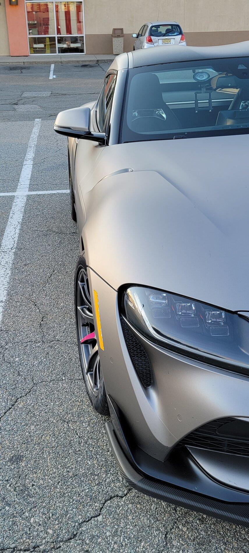

Front wheels pictured are 18x10 ET30, rears are 18x11 ET40. No spacers were used in any of these photos.

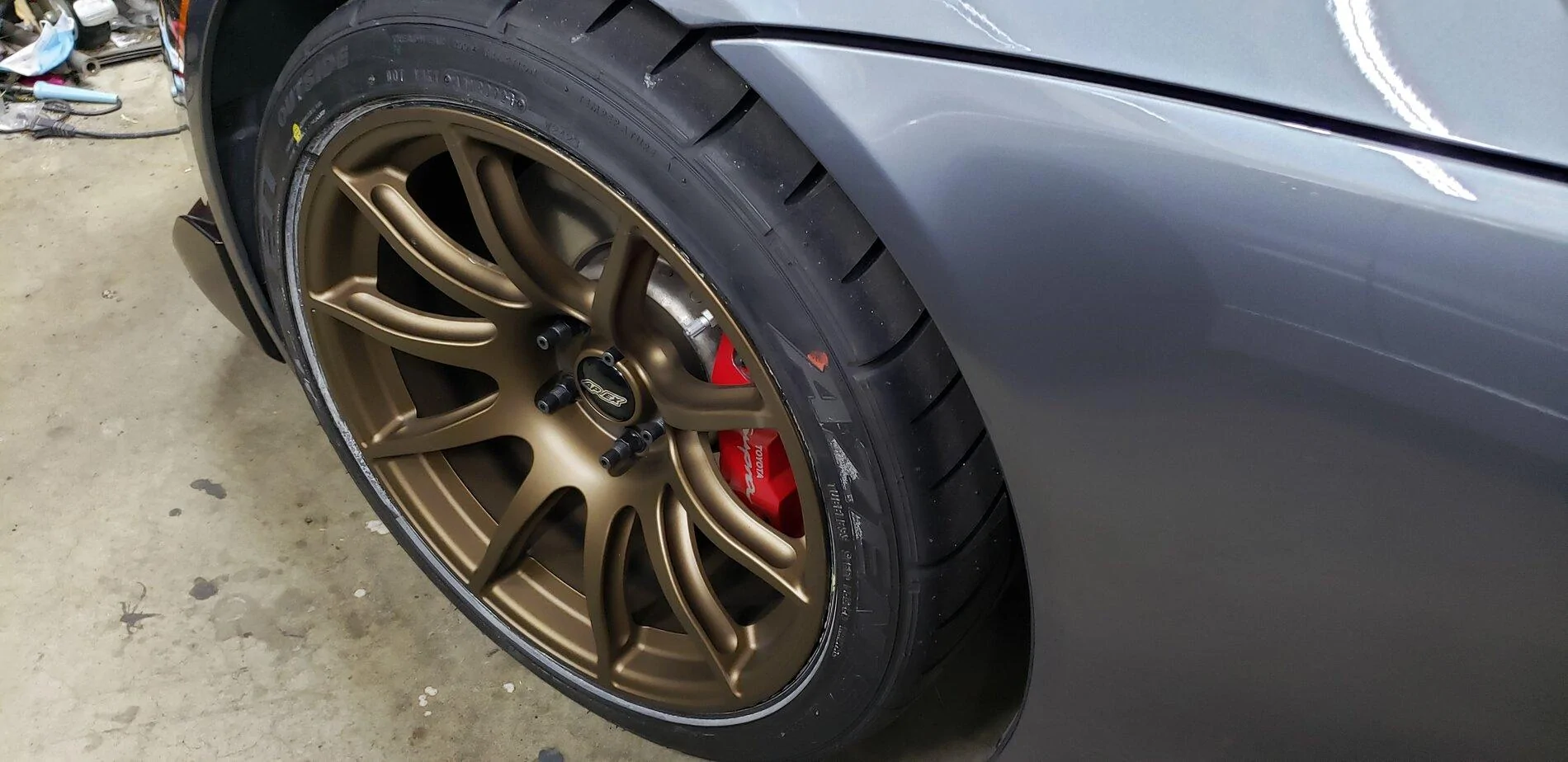

275/40-18
Tire model:
Yokohama Advan A052s (200TW)
Section Width: 11"
Tread Width: 9.8"
Overall Diameter: 26.7"

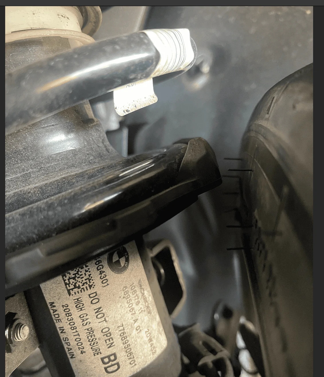

APEX Notes: Mods required.
This tire was used for our initial testfit and photoshoots. At the time, we thought they were a direct fit as the cars tested drove fine without signs of rubbing or witness marks on the tire sidewalls, but after a second testfit we noted that the tire touches the rubber isolator and would not be a direct fit. Corrections will be made to our previous posts and we have updated our fitment guide with this new information. 5mm spacers should allow these tires to clear, but they will not be a direct fit. These tires do run wider than many other tire models in this size. Less aggressive tires with narrower section widths may clear without a spacer in this size.

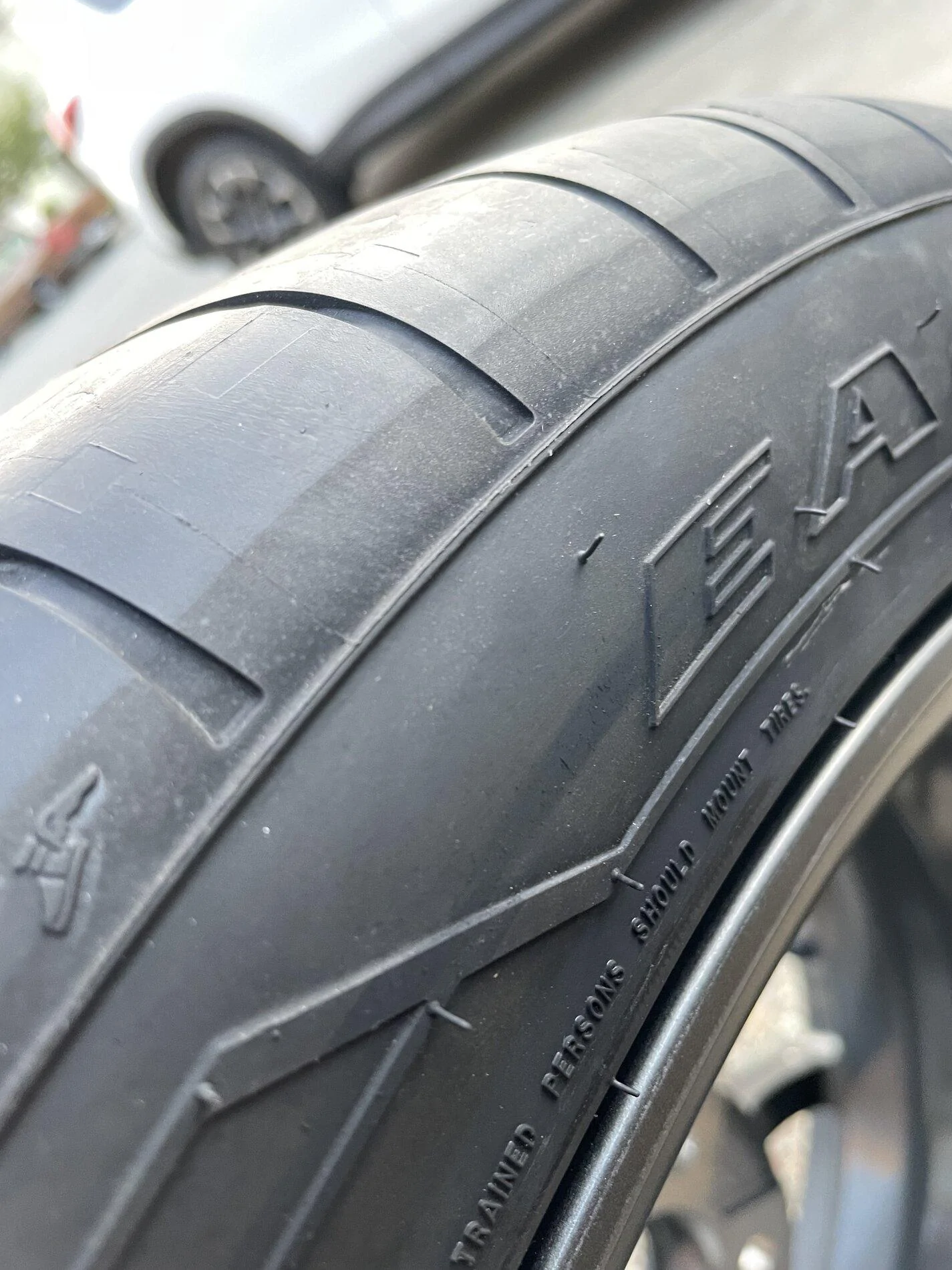

275/40-18
Tire model: Goodyear Eagle F1 Supercar 3 (220TW)
Section Width: Unlisted
Tread Width: 9.4"

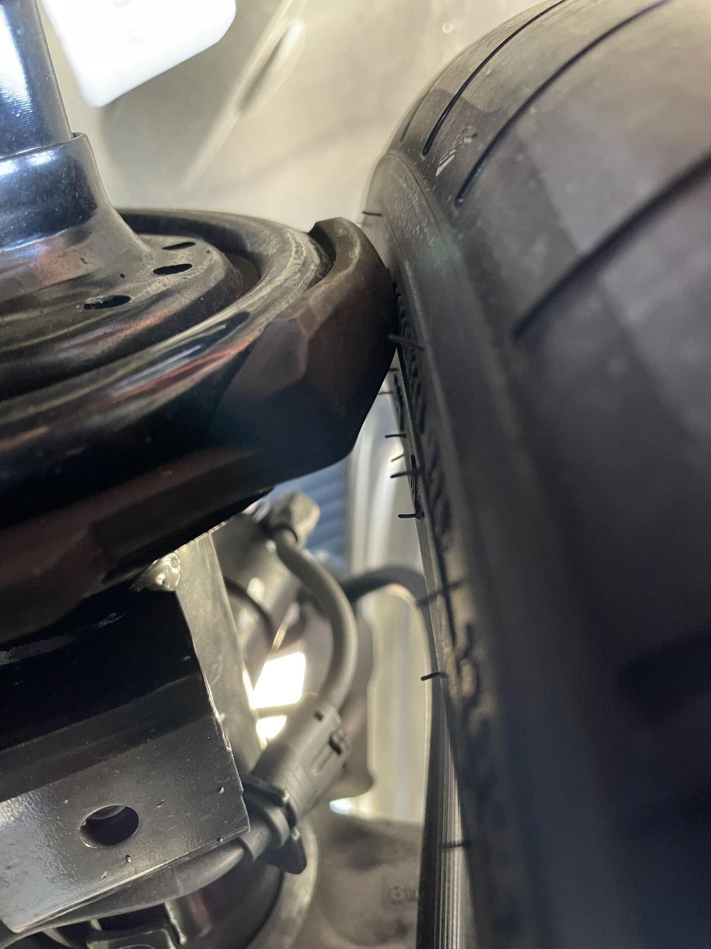

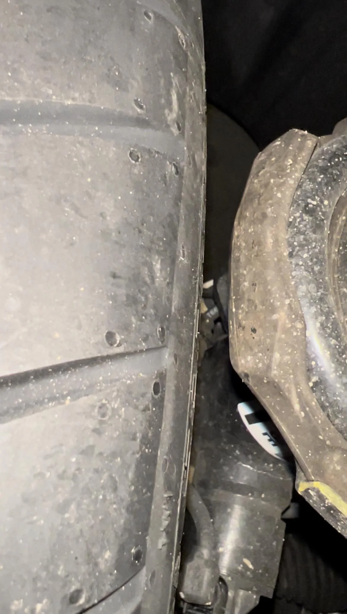

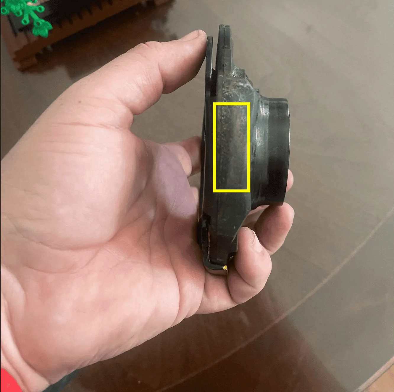

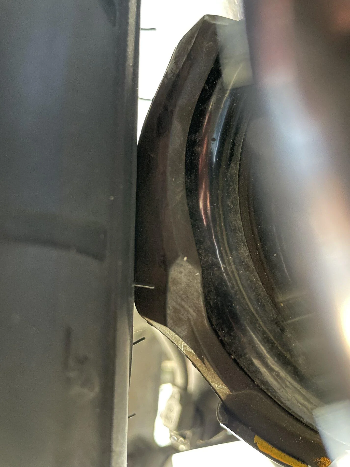

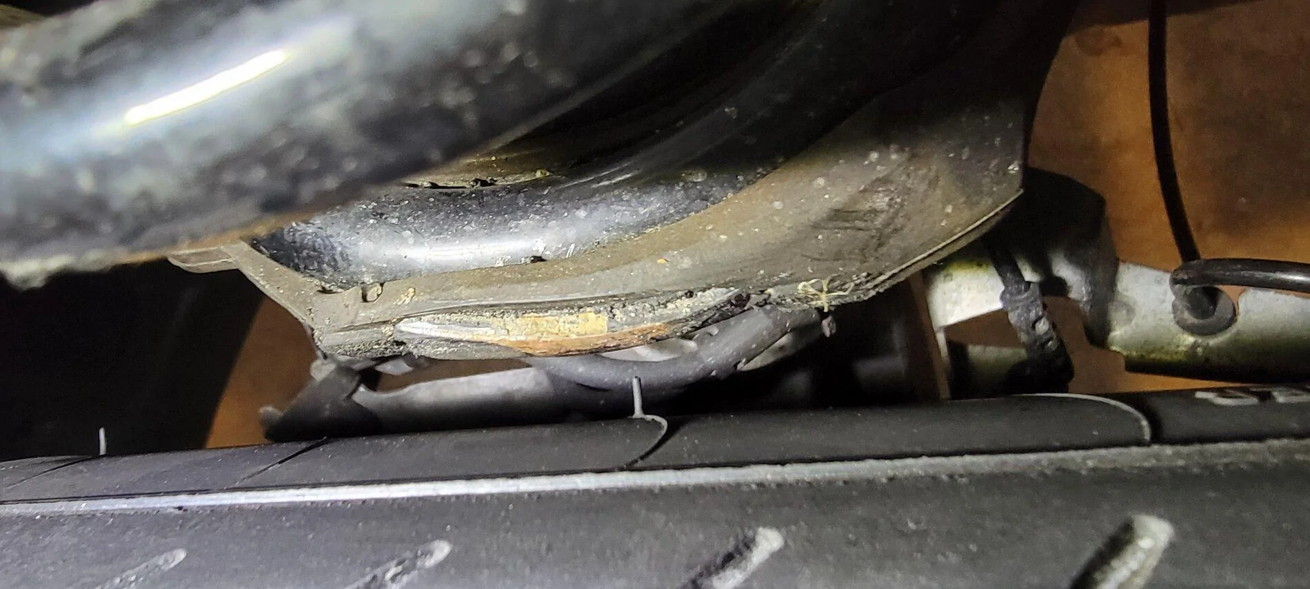

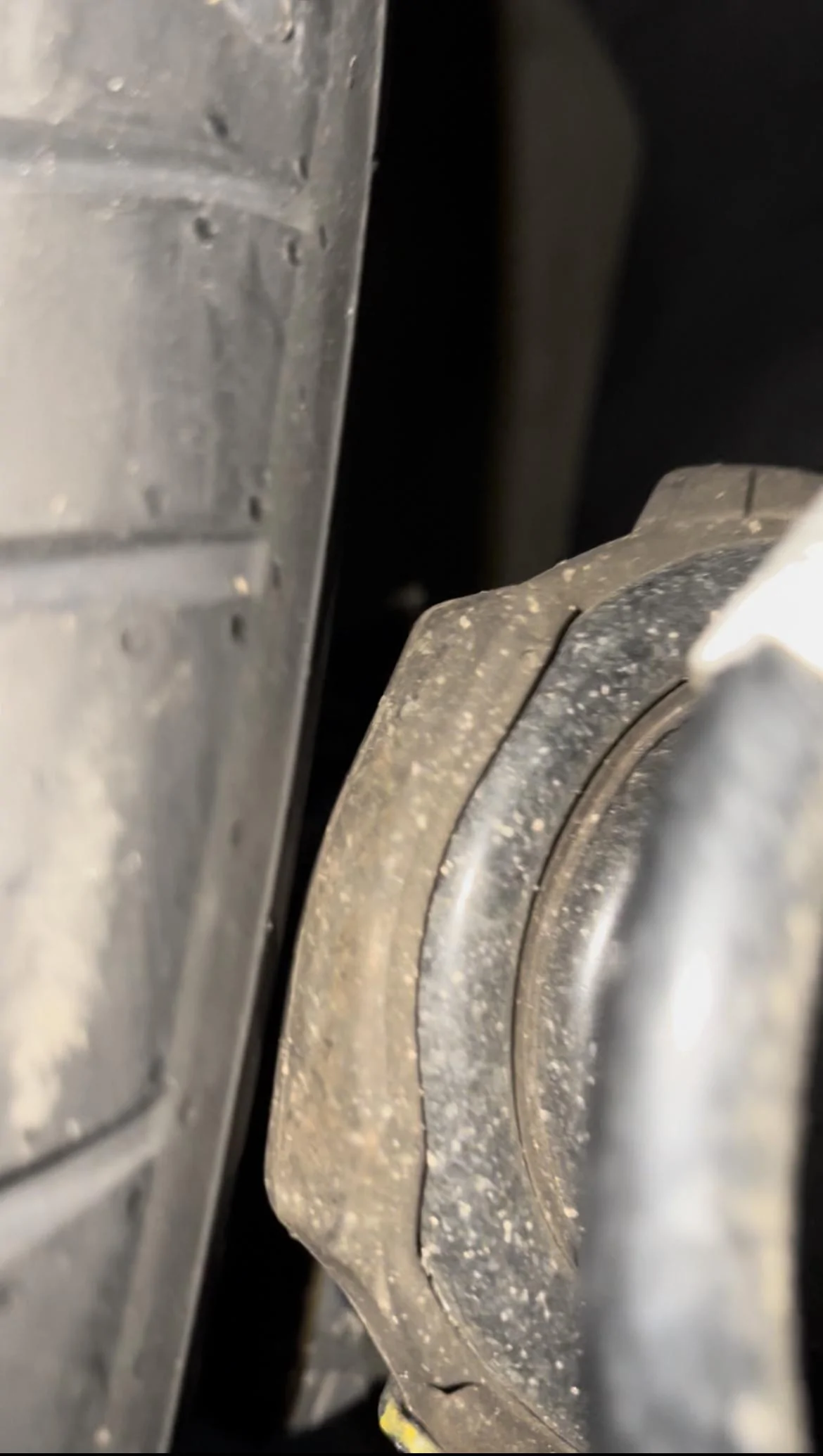

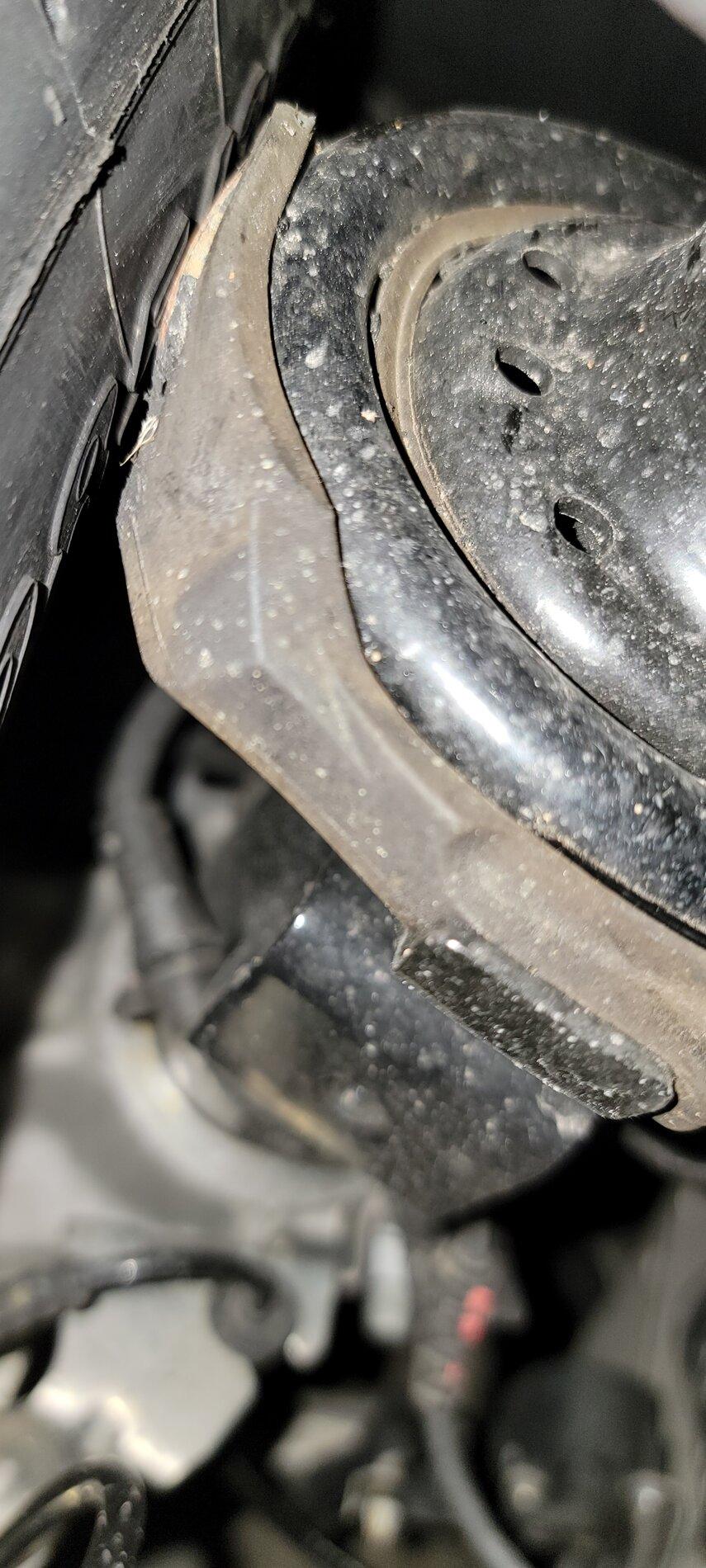

These tires rubbed the rubber isolator and metal portion of the perch. Based on our test fitment of the A052s in the same size, we suspect that their section width is wider than 11" based on their fitment compared to the Yokohamas despite a narrower listed treadwidth on Goodyear's site. Neither Goodyear's site nor Tire Rack list a section width for these tires, but they are quite wide. Photo Credit: @gcmak, Joe McGuigan.
Without Spacers:
With a 5mm spacer:

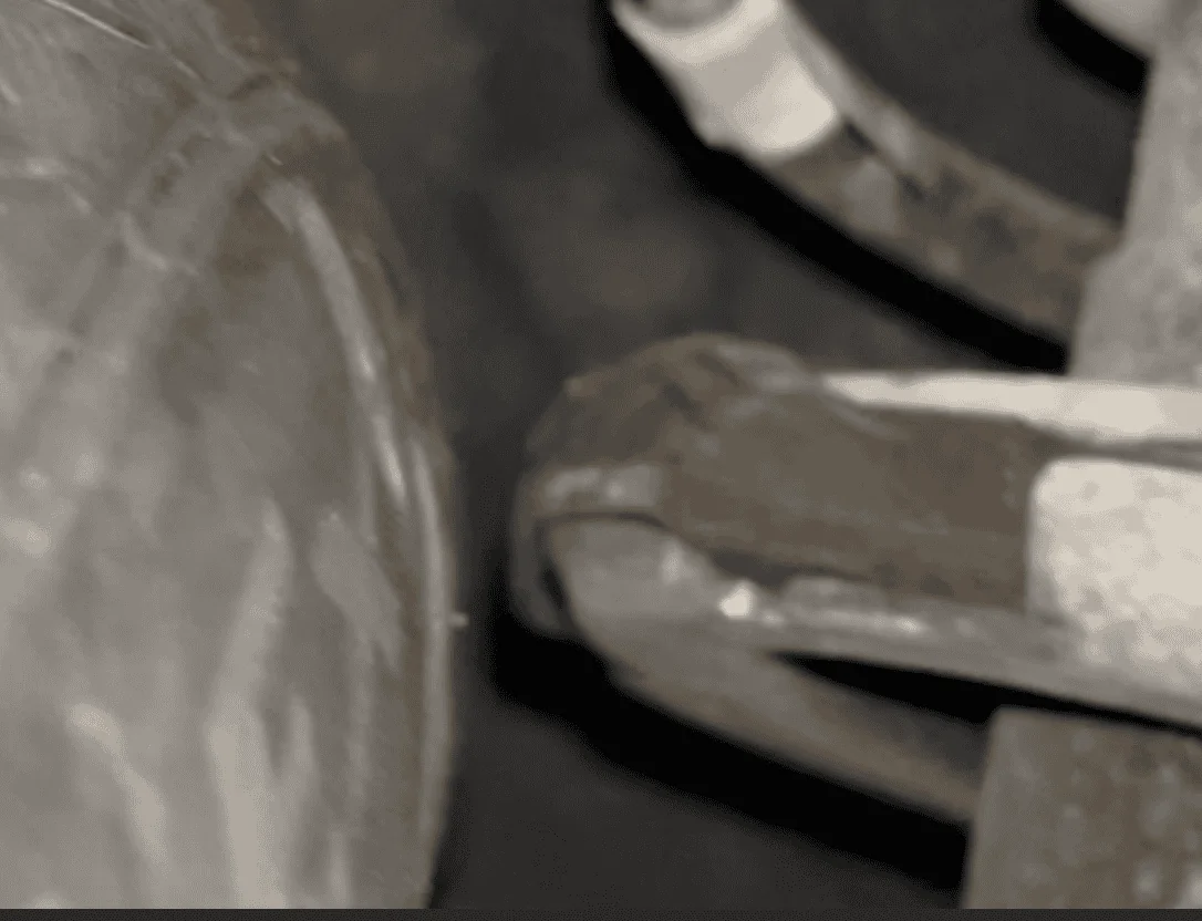

285/35-18
Tire model: Pirelli P Zero (220 TW)
Section Width: 11.6"
Tread Width: 10"

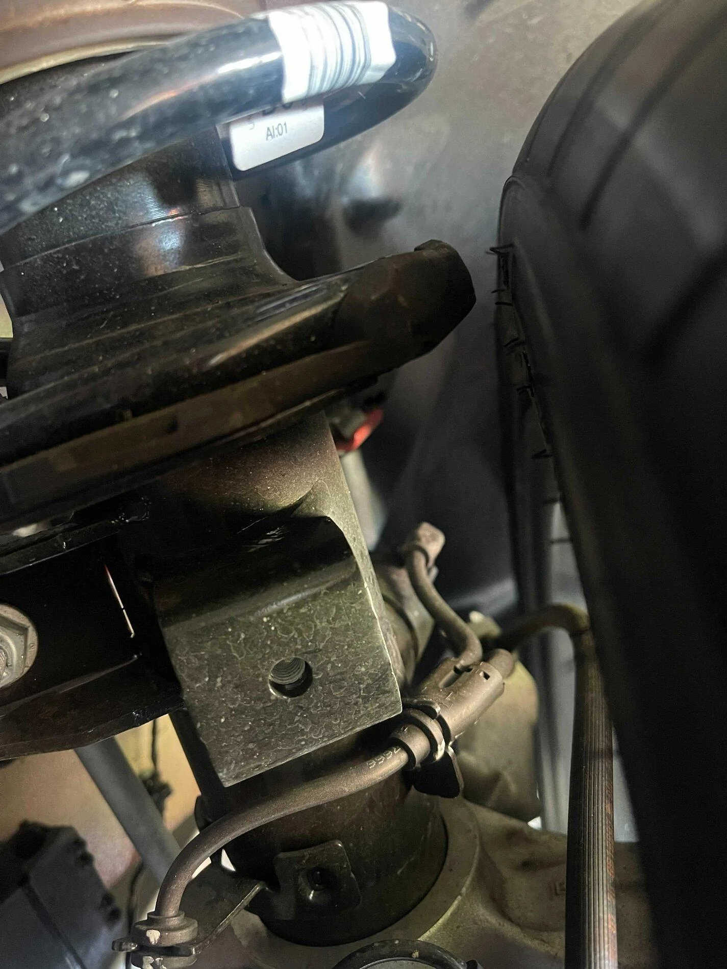

These tires are the widest size we recommend for the 18x10 ET30 wheels but even with the shorter sidewall, they are not a direct fit. 5mm spacers will be required with most tires in this size with wider tire models requiring thicker spacers. Additional negative camber can help increase outer tire/fender clearance when spacers are used but alignment adjustments aren't always necessary. Photo/Car Credit: @nibble
Without Spacers:
With 5mm Front Spacers:
Isolator wear caused by fitment prior to the addition of spacers.

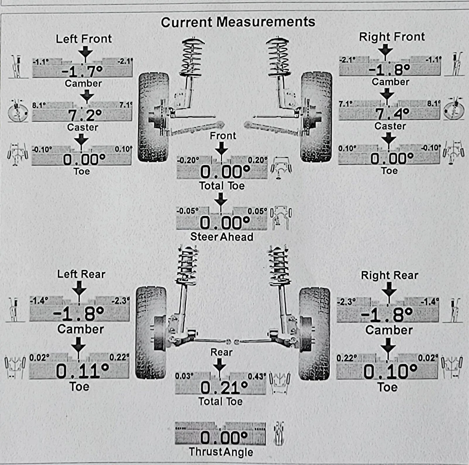

Alignment notes for this setup:

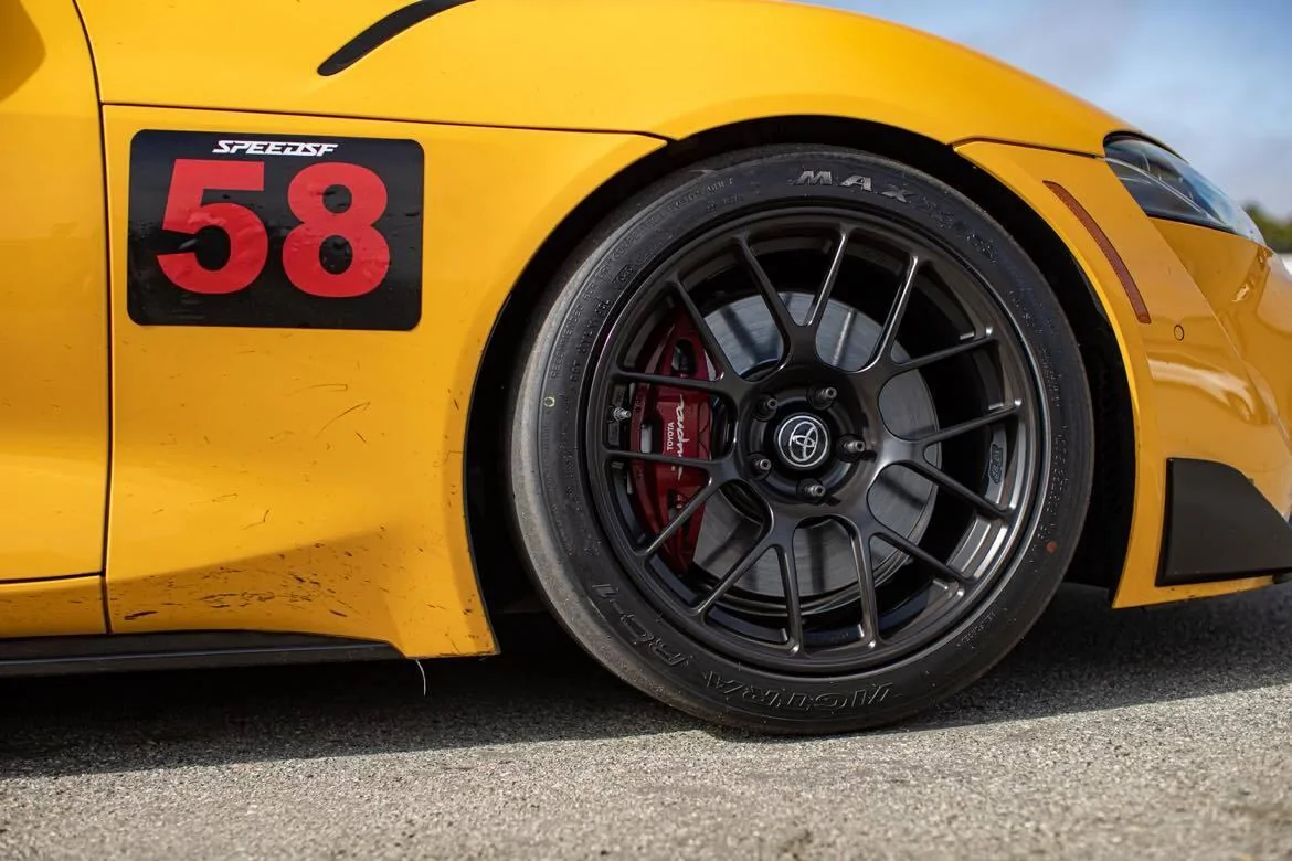

275/35-18 Maxxis Victra RC-1s on our 18x10.5 et38 EC-7Rs
Lastly, with the true width of some of these aggressive 275/40-18 tires, a wider wheel is really the more ideal choice for overall sidewall support and tire performance. R compound tires with thick sidewalls benefit from the additional sidewall support a wider wheel provides and 275/40-18 is an extremely common size to see on our 18x10.5 ET38 square EC-7Rs:
18x10.5 et38 EC-7Rs with 275/40-18 Yokohama A052s front & rear. 12mm front spacers required. Owner's IG: @tim.onetime

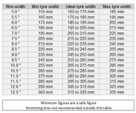

Wow! Thank you thank you! Your inputs are spot-on and very much appreciated! Hoping this setup will be a blast to drive. I opted to go for PS4S thus my tire specs for front and rear. I understand the tire wall concern but I think PS4S sidewalls are durable (also base from experience) since these were the upgrades for the Super Sport and should probably hold well for street setup. I’m using this guide also for tire and wheel setup.
The Michelins will probably be fine on those wheels, but as the chart above shows, the wheel sizes you have in mind aren't ideal for the width of tire you plan on using. The tires will mount on the wheels without issues and probably be safe to drive but if you move to a more aggressive tire model that runs wider in the future, I would recommend wider wheels to better support the sidewalls of the tire.
