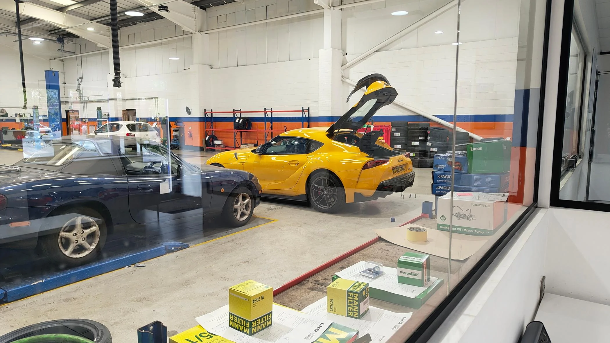

Car rear is "floating" after putting new tyres

I got annoyed yesterday after trying anything. Ordered pilot super sports and will fit them on Saturday. Hopefully the problem will be gone 🙏

Drop the pressure on the crappy ones and do some burnouts.

Too much psi. Drop them to 32. When I replaced my stock rears I had that issue and dropped the psi down and issue went away

I tried to cheap out and replaced only the rears at 20k miles, went with Continental "Extreme Contacts". As soon as they went on, I experienced the traction control pulsing the brakes for the rear on sweeping turns, not even that fast, stuff I could do in the mini van, seriously. I lowered the pressure to about 28-psi and it went away but it didn't feel as good as the OEM PSS. Last week I had a flat on the rear, after pumping in the fix-a-flat goo that they give you I went to the tire store. They said the fronts were down to cords on the inside (27K miles), I know now to examine the full tread. I went to Michelin PS4S all the way around, it feels much better, fun to drive again. I'm sticking with Michelin's from now on.

The OEM setup is a compromise just like anything else you change in the car. If you want what the engineers intended, then stick to OE tires.
The OE tires are a bit dated and there are better options out there. Remember development of the car started back in 2014ish.
personally I would choose the 4s or extreme contact 02 over the OE tires.

i had this issue on my corvette before so i called the tire manufacturer and he informed me that the tires i purchased were for a much heavier car so he told me to run less tire pressure than i was and it remedied the problem

All problems gone. I put back Super Pilot Sport tyres and the car feels normal!
On previous tyres it didn't really matter whether I do 2.6 bar or 2.1, although on lower pressure it was a bit better. I was still getting quite a lot of traction control issues and car felt unstable at higher speeds. Horrible experience.
Never in my life I would say that tyres could make such a massive difference.
