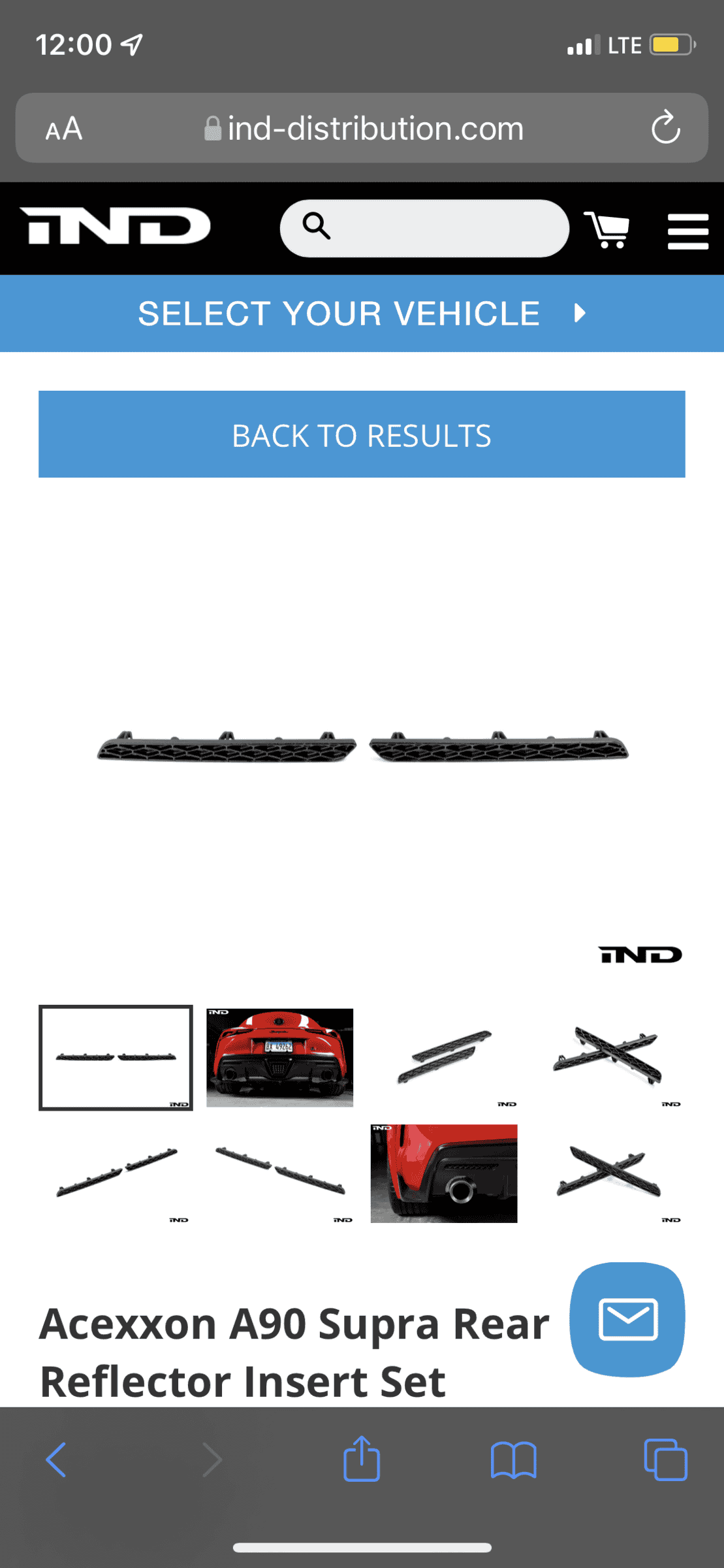

As per the title, is there a guide on how to put these in, I assume looking at them they are pop out pop in type of thing but just wanted to make sure

Those are not what I’m talking about

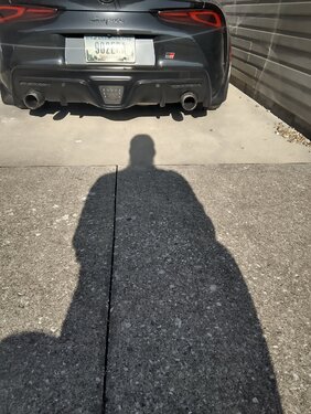

Anyone know if you can get at the back clips without having to take off the rear diffuser/bumper?
79
8,437
13,835
The clips on the back have to be compressed though?
Fake news. They're standard automotive plastic clips. A trim toll under it, microfiber in between the trim tool and the paint, pop those motherfuckers right out.
I jacked car up in Back and undid some of the hear shield bolts and compressed clips. Didn't try the tuck tool trick, may have been a lot easier.
Yup did the same, I tried just the pry tool at first but it sketched me out.
