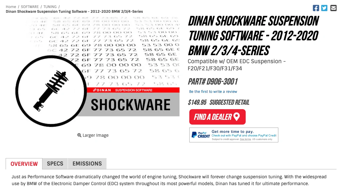

I heard some Bimmers tune their EDC while lowering the spring.

The lowering spring has higher spring rate. I feel like it's higher than the stock damping rate and not doing very well in the mountain roads here. I found a BMW tuner change the active-suspension with 30% more compression and 44% more rate for the rebound. Also increased the active differential torque limit from 1500NM to 2000NM. It's so much better. I can't tell if the difference from the damping adjustment or the differential.It's much stable and it can corner faster with higher G.

Is this flash DME tuning or is this something that can be coded in chassis via Bimmercode or another more professional software requiring dealership-like chassis computer access? I like my HKS springs but they could be better.
It needs the chassis computer access. I saw the tuner use it to make the adjustment in the workshop. That's a BMW place. They do the coding on BMW for a long time.
