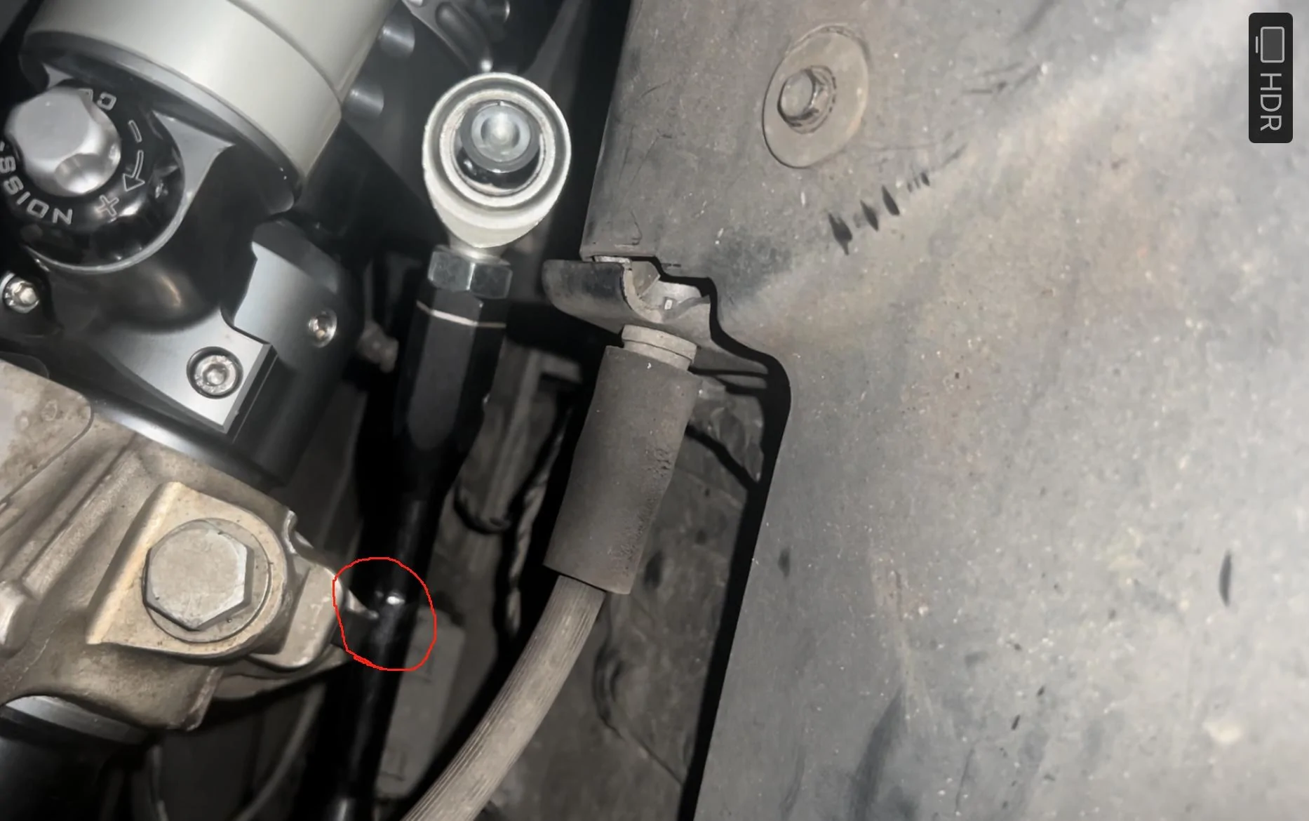

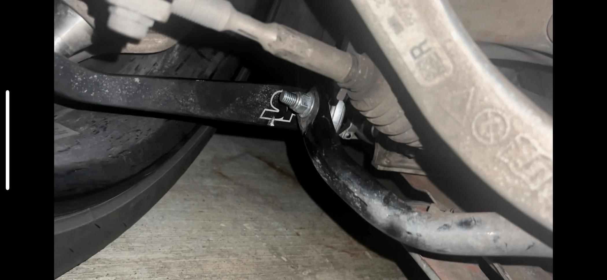

Hey guys, new in thread here. I got issue with the Front Endlink with NTR R3. The front endlink does not have enough clearance to the wheel hub, so its damaged by the bracket on the wheelhub, is this an installation issue? Do i need to change the direction of the endlink mount on the suspenstion?
I saw some successful application of this set up online so wondering if the installation is wrong.
Thank you so much guys

Sway link is installed wrong on both ends. The joint that is mounted on the damper should have the stud facing towards the front of the car. The joint that mounts to the sway bar should have the stud facing away the chassis. Nitrons sway bracket is adjustable as well if you’re still having clearance issues you can rotate the bracket till the link is perpendicular to the damper.

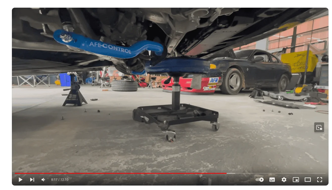

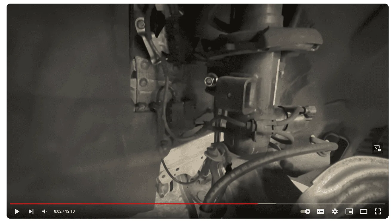

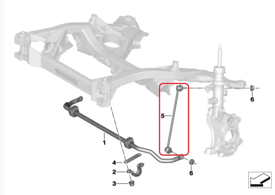

Thank you for your reply, I tried to follow the graph here when installing:
and I watched a few youtube video they all installed like this
I tried to do the bottom with stud into the chasis, it seems worth because there is less clearance.

No caffeine yet, I’m taking a closer look at your first photo, it looks like you the joint is facing forward. Rotate the bracket and you should be good.
