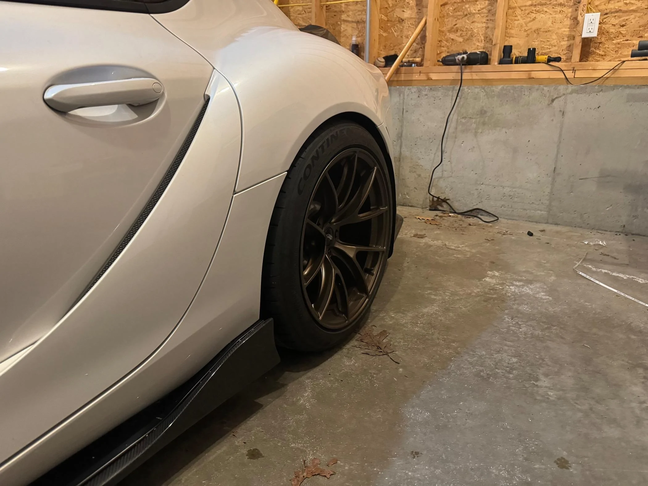

15mm feels a little too close to the fender, may try the 13mm on the rear.

Remember that the rear suspension cambers in under compression (gains negative camber) so you will have more clearance to fender than you think.
Good point! It looks pretty ā€˜flushā€™ to the rock guards I have. I would rather try a 5mm spacer but I have a 13mm on hand so here we are. Will drive it around tomorrow and see if the noise is still there. Also made sure to really get a nice layer of anti seize in there too.
If this helps the noise Iā€™ll order some 5mm from @APEXRaceParts and longer bolts.
