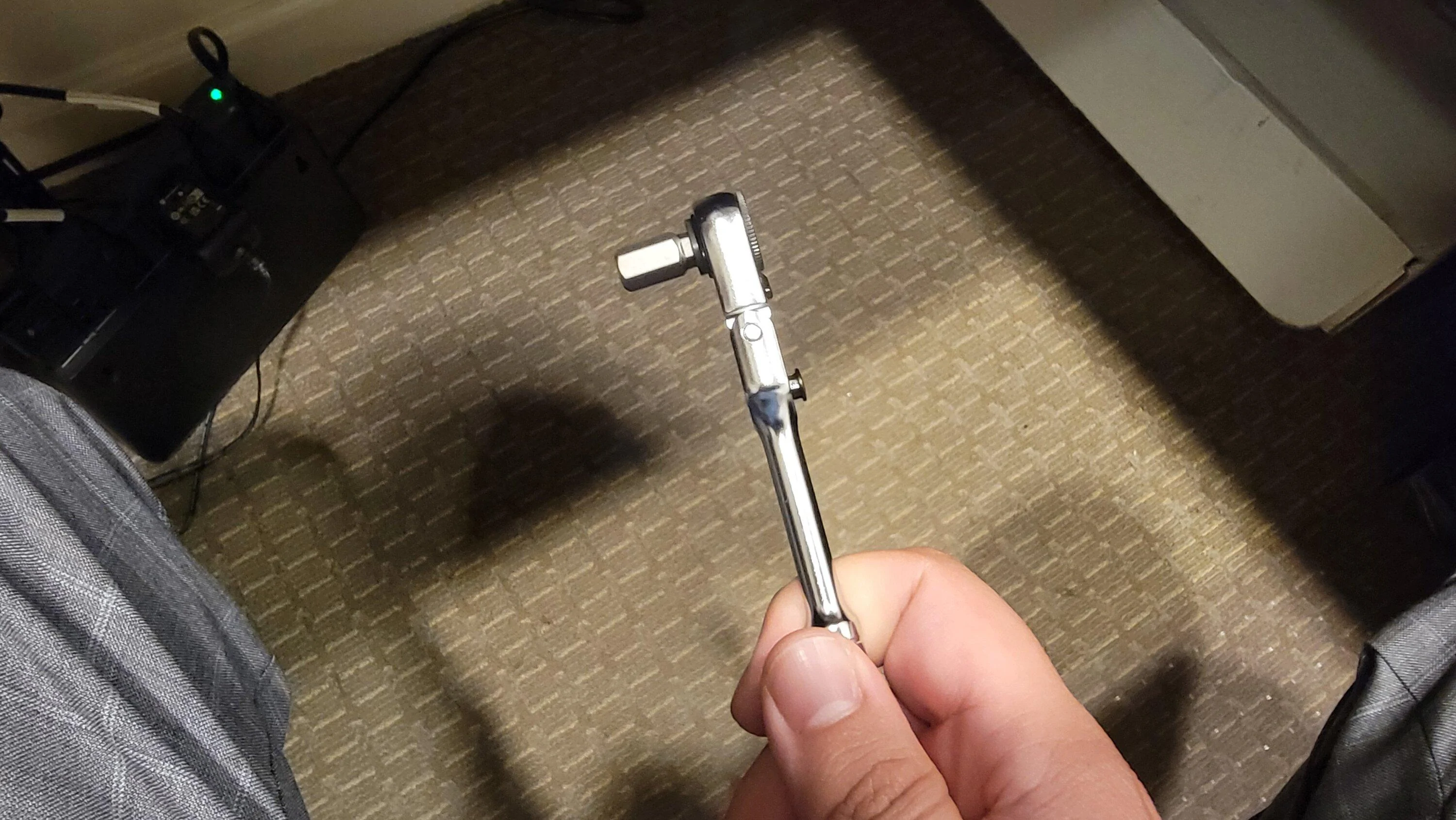

Hey all, this is a bump from hell. Just got under the car to do the trans service I don't see a way to access the fill plug. I tried using a Allen socket which was too long and a regular L shaped Allen wrench is also too long to fit between the chassis and the side of the trans. Help!
I am going to try this bad boy this weekend and see if he fits/works...

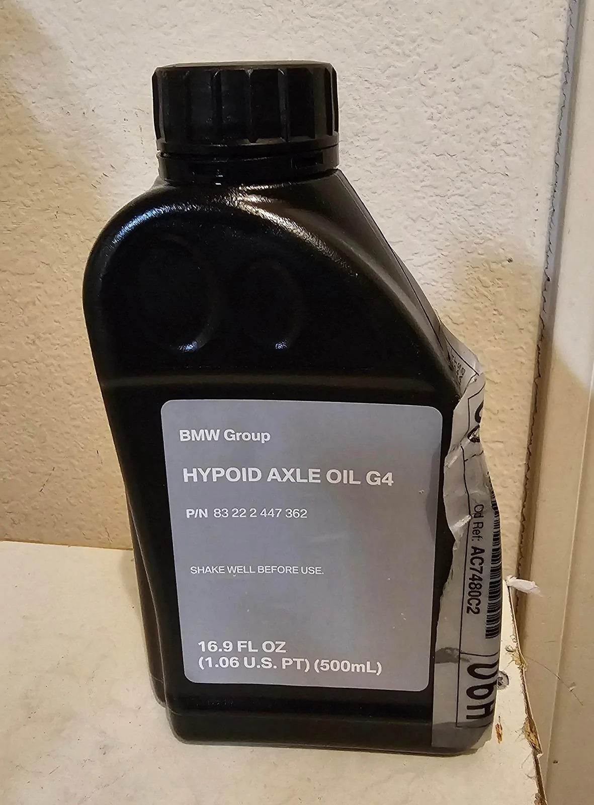

Is this p/n now discontinued? Does anyone know if there is an updated p/n?
I just bought a bottle, last month. Sadly, I had to get it at a Toyota dealership. All the BMW dealerships had bulk oil, only.

What did that set you back? I'm tempted to just run Liqui Molly or Redline.

Motul Gear 300 75w90 or Liqui moly you linked. Donā€™t pay $80 for oem, thatā€™s insanity. Especially since it actually costs $45.

Our cars supposedly need G4 Diff Fluid, the Motul stuff you linked is GL-4, is that the same?
