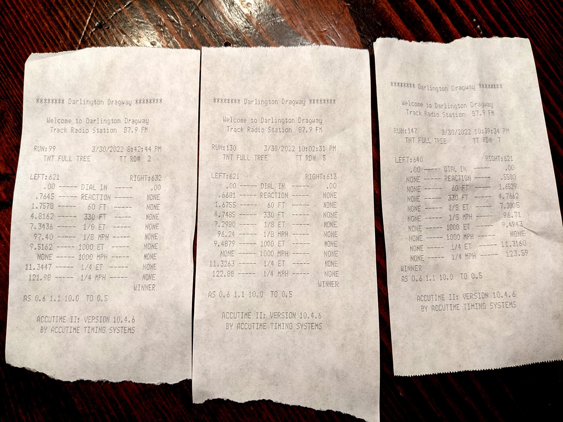

I hit up another TnT at a different track to see if I could make some improvements. The only change being a @Jesse DaBears custom map 6. Initially I had issues with maxing the fuel trims due to high E content and abnormally cool weather so we had very little time to get things dialed in advance. In short order he got me setup with a MUCH safer map just in time. Now that we have a good baseline there's some headroom for more boost next time out. It's been said a thousand times, but if you have a JB4 you need a Jesse tune.
No PB on ET or MPH but I did get the launch sorted out with the new map. Unlike my first trip out where the track was empty and I had all the time I wanted to get the car cooled, etc.. This was the polar opposite -- only 3 runs over the course of 3.5hrs -- and no way to mitigate heatsoak because of the staging lane situation.
1st run: Left in 2nd gear with essentially no boost. I was trying to cut a light and failed at that and the launch.. ? I'm not sure what's up with the trap speed; dragy reported 124.24 but wutev.
2nd run: Car totally heatsoaked because of staging lane issues. Otherwise a good pass and got the 60' where it needs to be. IATs were toasty.
3rd run: the woulda-coulda-shoulda pass.... I accidently left it in Auto mode :banghead: I shifted into 2nd after staging but it dropped itself back into 1st as soon as I started to footbrake. It left HARD and then shifted into 2nd at 5000RPM. It caught me so off guard that my brain side 'push the stick into Manual' but what I actually did was short-shift into 3rd :crazy:
There's another TnT in two weeks so that will probably be my last outing before doing more mods. Debating whether to do some weight reduction to see how deep it'll go.

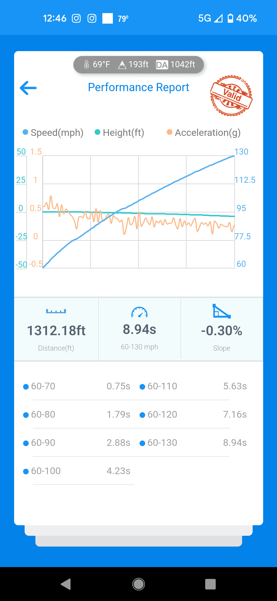

60-130 since that was asked about before:
This is riding out 5th gear. I believe this will come down considerably with a timely shift into 6th.
