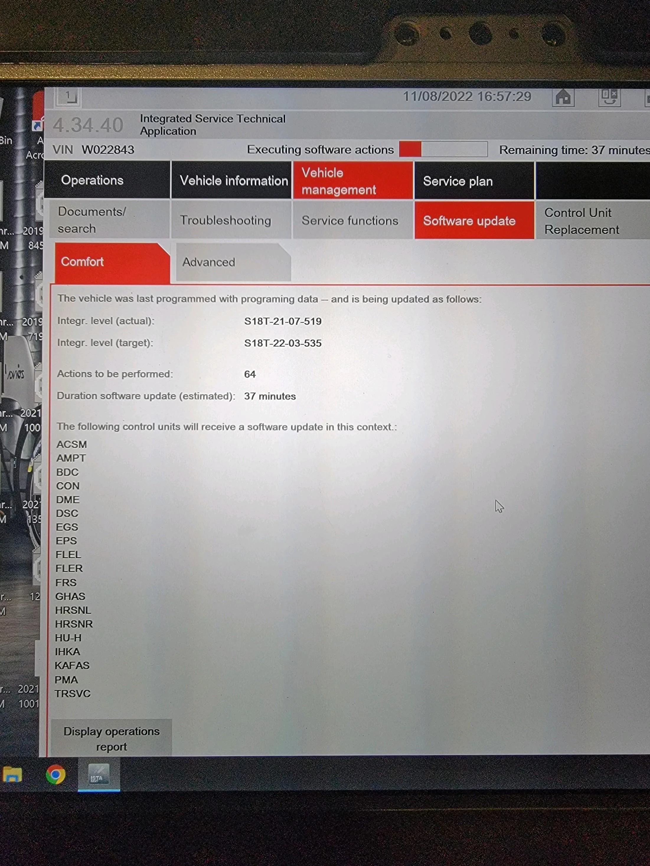

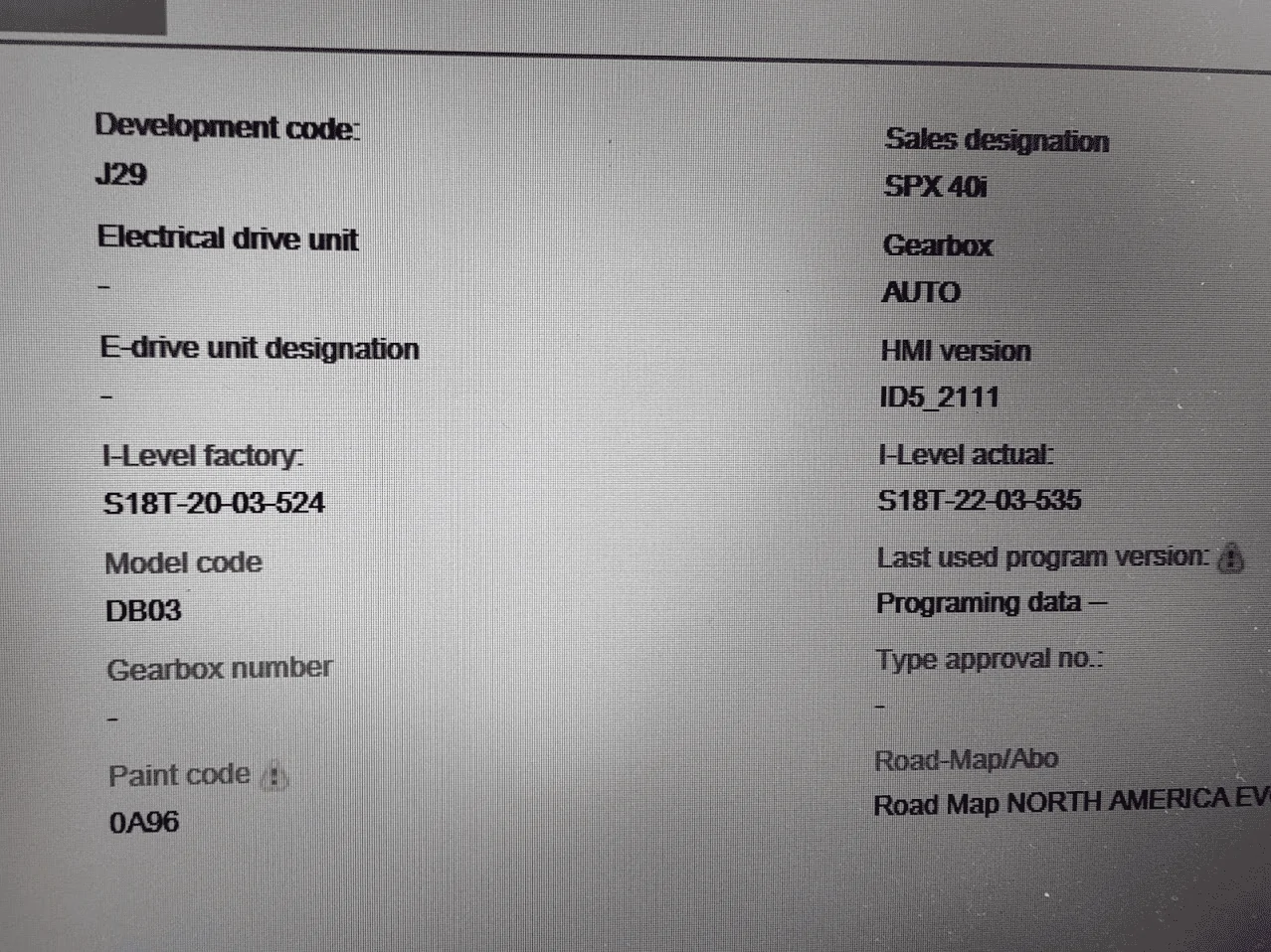

Woot, just successfully updated:
To: S18T-22-03-535 (March 2022)
From: S18T-20-03-524 (March 2020)
2years of i-Steps, throttle hesitation fix, and brake recall done!
No issues other than needing to calibrate EPS at the end.

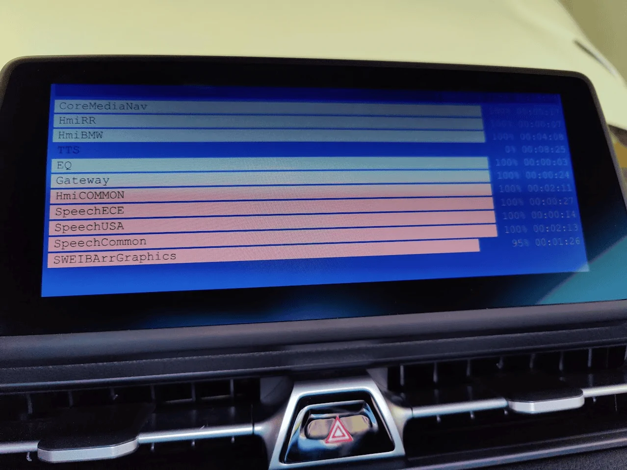

Headunit (HU-H) took the longest.
ISTA estimate was ~48mins, acutal was ~1hr.

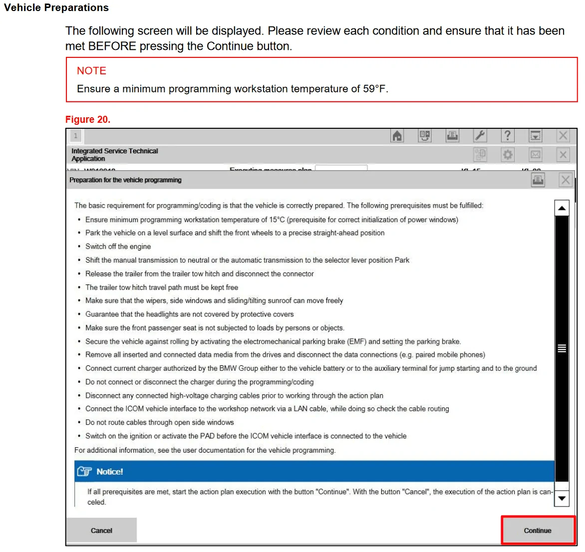

My dealer won’t do the iStep update (after being there twice and asking them specifically to do it to hopefully get rid of throttle hesitation) because “there isn’t a service bulletin”, so I’m pretty much set on doing this myself.
Any gotcha’s or particular vehicle setup requirements? The ISTA papers say “precisely straight, level, etc.”, how true is that?
Tsuki8
May 28, 2022
246
298
21 3.0 AZ BM3 E50 WMI
Nice! Notice any difference when driving?
Also curious why you didn't have the dealer preform recall so its documented?
I haven't had a chance to drive it and partially from the weather.
My dealer refused and wanted 0 codes before the update. (Understandable from liability)
I had a few codes outstanding from the previous owner tweaking through Bimmercode.
(Disabled ASD (engine noise), door chime, auto-start/stop, sport-mode default, etc.)
Found myself in a catch-22 situation, since updating would restore/undo-all those settings/codes.
I decided to proceed without the dealer since I didn't have a backup of the Bimmercode changes to undo the codes.
It is very straight forward, more or less a click-through process.
ISTA will take care of the dependencies and update in-order automatically.
I treated the vehicle prep as best-practices, followed as closely as possible.
It is known that a few headunits were bricking during updating, I decided to have a floor fan pointed at the dash/headunit during the flash. Not sure if it did anything, but everything made it over safely.
