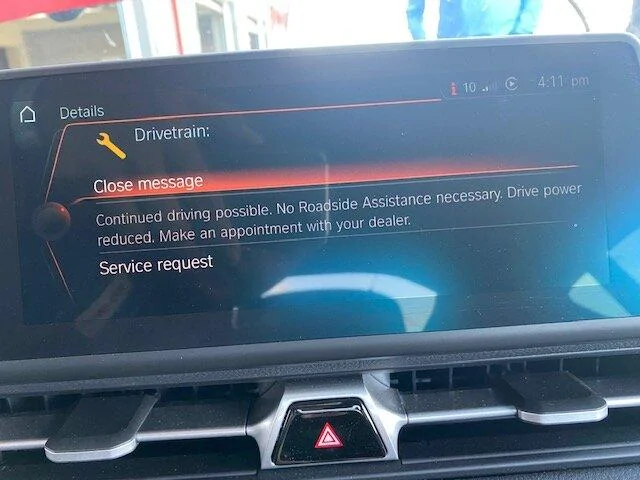

Update and new limp mode -
Added the Verus Engineering rear diff plate and haven't seen anymore rear axel errors although the ambient temp is in the 70's, not in the mid-90's.
Over the weekend, while on Thunderbolt (NJMP), the car went into limp on one session and the error i received was: "Drivetrain: "
The error went away after a quick restart and never came back.
Any idea what this means?

Are you driving sport manual or sport auto? Is the car tuned or is it on the stock tune file? Are you keeping VSC Traction control on, 1-Click off, or Hold-Off completely? Lots of variables could be causing this. Do you have any ways to track the temps you're seeing for oil, coolant, transmission etc etc?
I've only really seen people complain about this issue when the transmission isn't happy with the torque vectoring via tuning, or if the car spends to much time at or near redline. I myself have had this issue on an OTS Ethanol blend tune, anytime the car would reach limiter, or damn near 7k RPM's, it would go into limp mode and display this exact error. This has since been fixed with a revised tune, but when this was occuring, I used my tuner scan tool and it gave me a readout something like "Not enough fueling for performance level". Are you by chance running the car damn near empty when this is occuring? If so, it could be an issue with the fuel pump potentially having to work to hard to scavenge fuel.
How hard would you say you're pushing the car? Are you driving it 10/10's at it's limit, or 10/10's at your limit? I know several guys on here track their Supra and I haven't seen any of them complain about issues like this.

Only happened once in 30 track days or more. Happened when I was trying to keep up with an actual race car that is on a different planet. I was abusing the car and sliding all over the place.
The car is stock aside from Camber plates and Brake pads. Running on Sport and letting the trans shifting automatically. Gas had 2 bars left and I was driving the car pretty hard.
