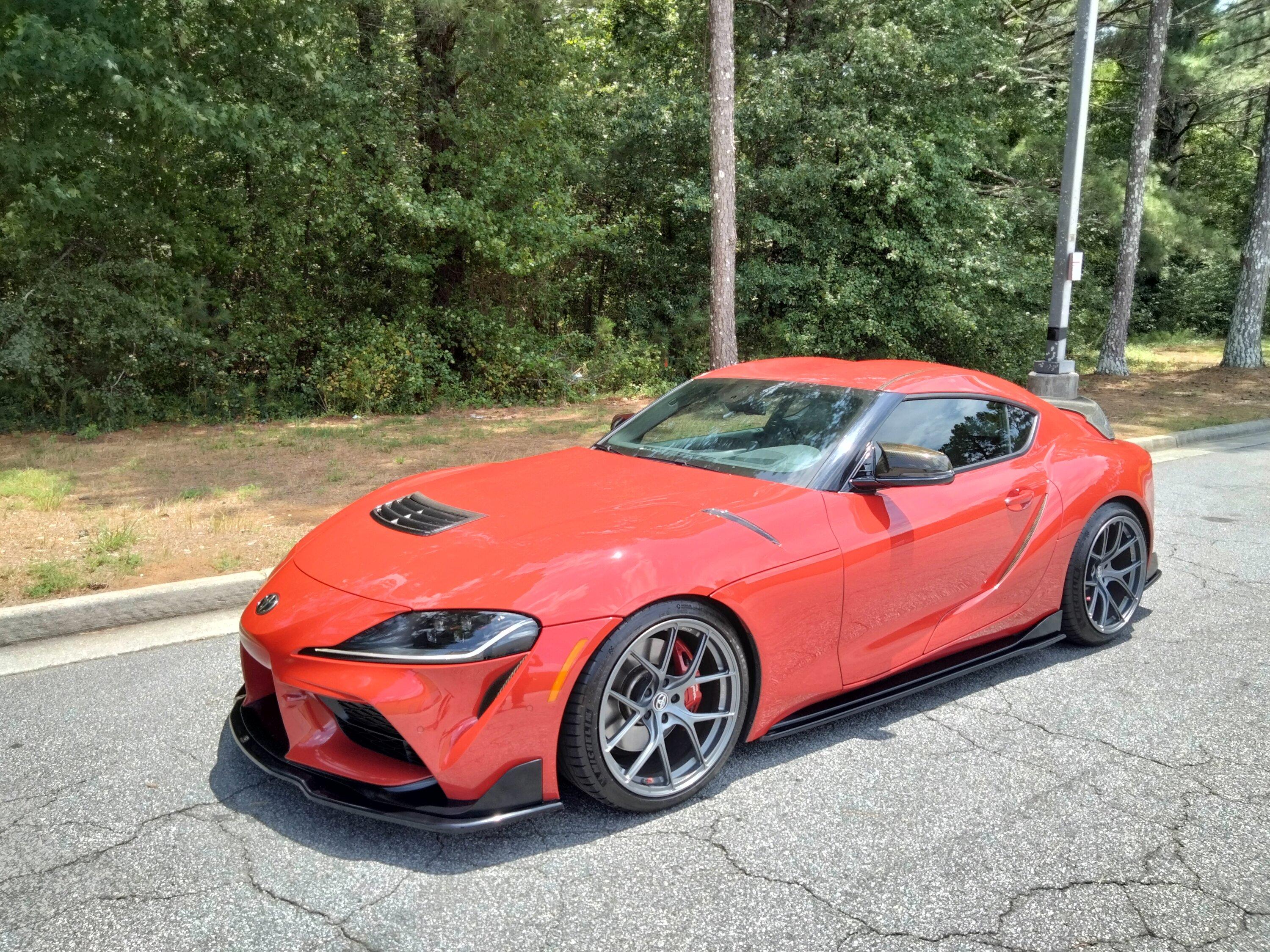

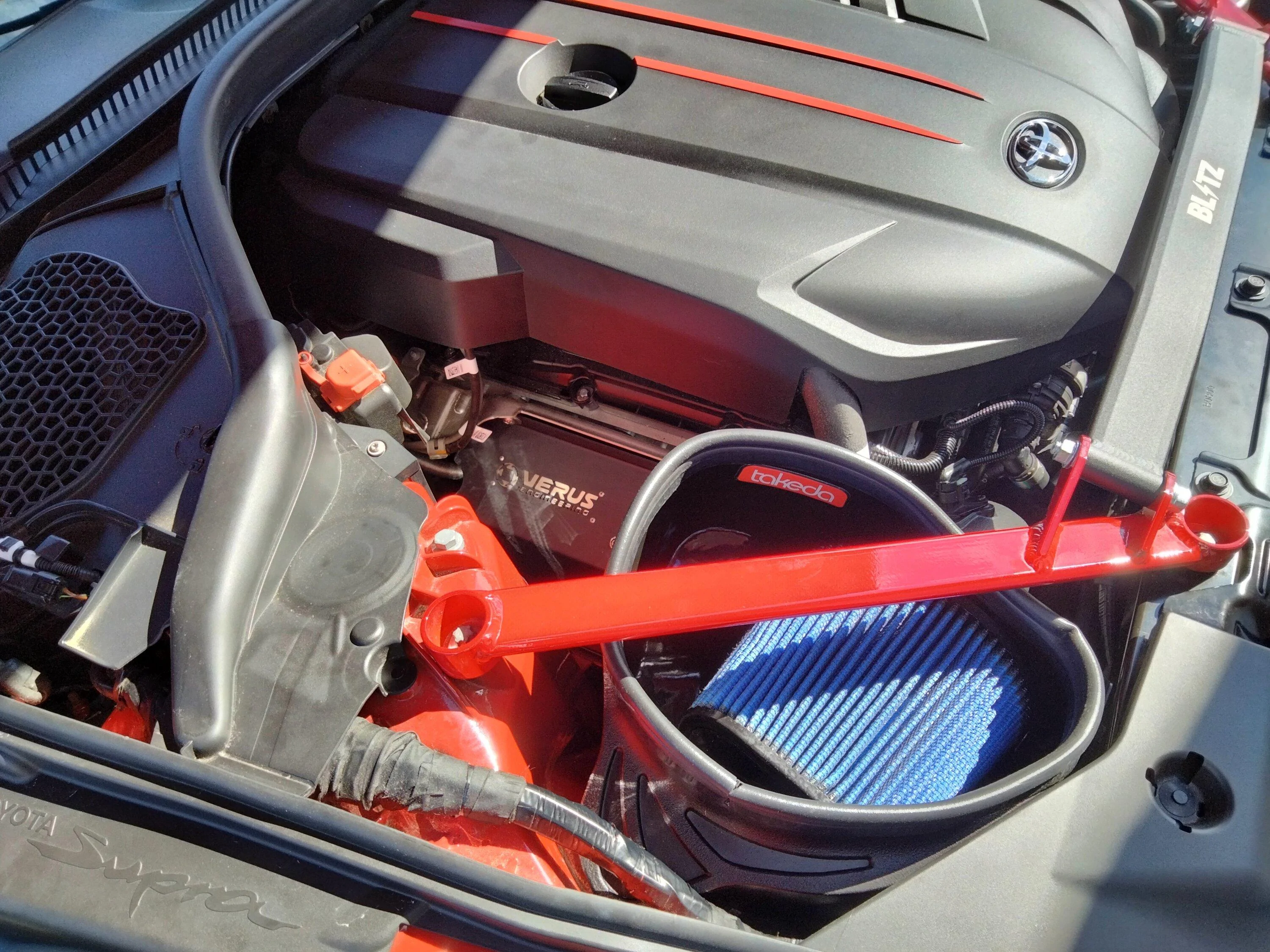

I have the same intake as OP albeit the non CF version but I never noticed a drop in power I think for two reasons. I have Verus heat shield and the Verus vented hood louver so IAT's are generally 10-20 degrees over the ambient temp outside.
