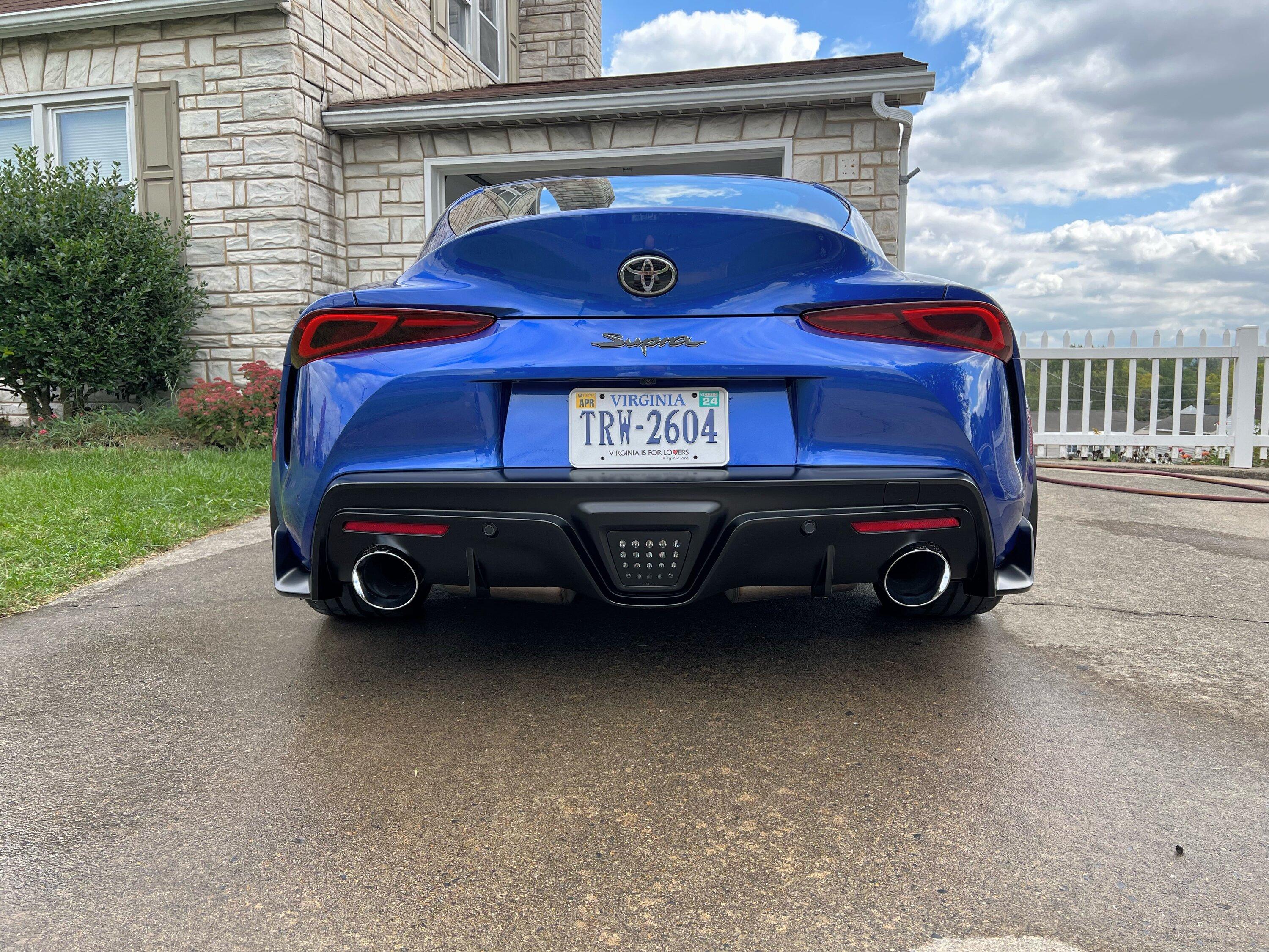

I installed it myself, all the hangers are parallel to the ground which is what I thought the indicator for proper installation was. Maybe things can rotating there a bit without changing the hangers much I dunno. Mind posting a picture of your tops from the same angles?
I just put mine on yesterday and this is what it looks like.

That fitment is excellent. Mine is about 1/2” lower than what I want (I want your fitment!). I’ll need to try the pipe rotation method you mentioned.
It's definitely a pain to get it adjusted right. It ends up being a balance of tightening/loosening the mid pipes, the AWE bracket and the muffler sections until you get it just right.

Yep. Those hard rubber grommets on the hangars also fool you…you think you’ve turned the pipe or muffler to the right spot, but then after tightening you realize all you did was scrunch the grommet and it expands right back where it was. Grrr.
