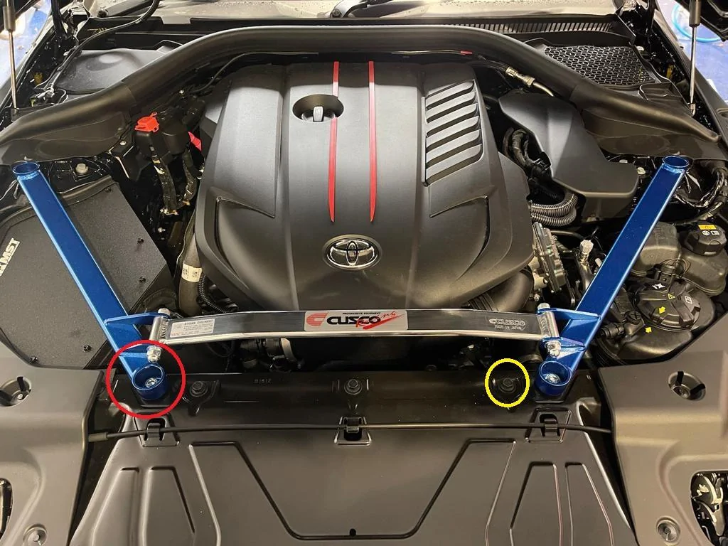

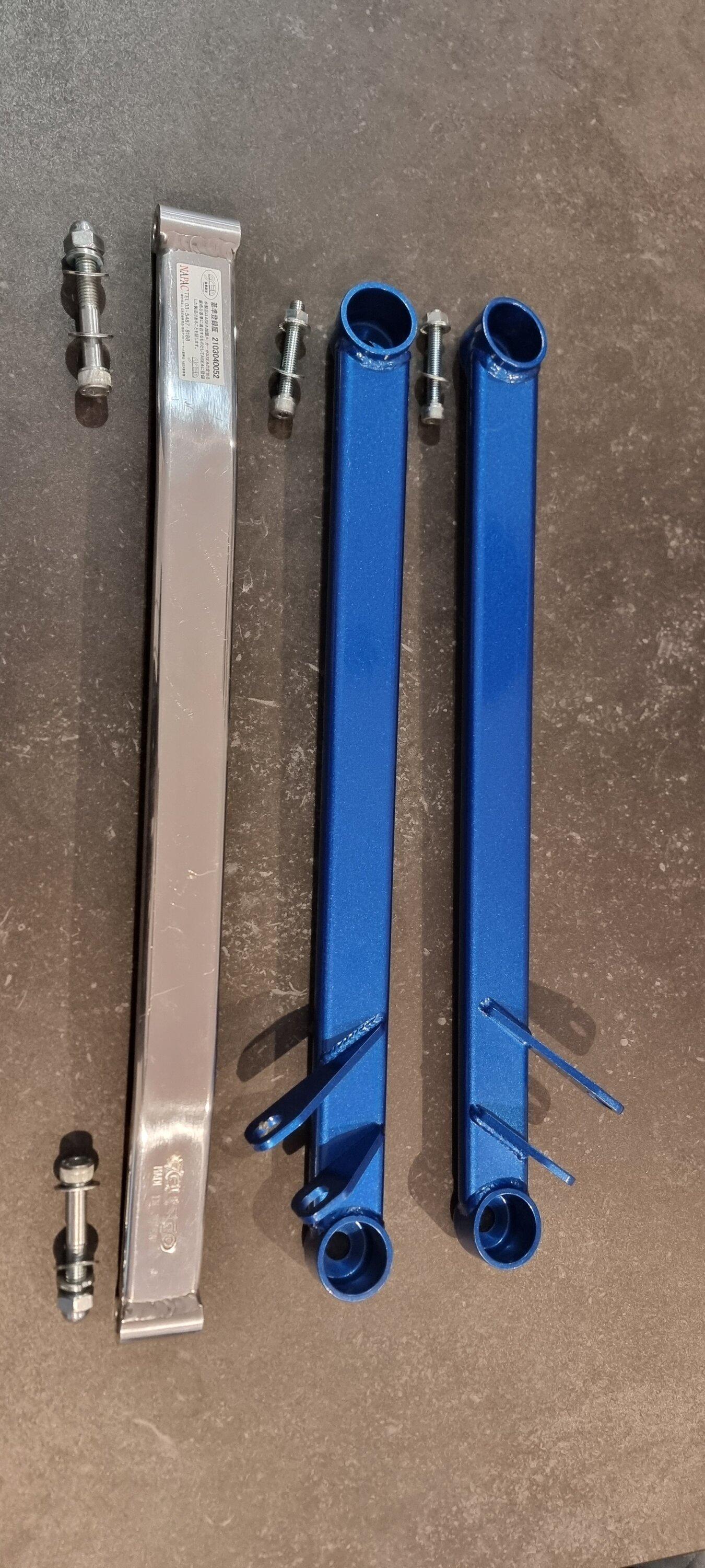

Bought a Cusco Strut Brace from a fellow Supra owner.
Unfortunately, two bolts are missing (see from pic).
Any know the exact details of the bolts I need and where I can order up in UK?
I know it should be v simple, bur I'm fitting to a 23 as well, so any advice on that would be much appreciated.

UK cars didn't come with a strut brace.
Looks like you are missing the front ones that mount it onto the radiator bar. (red)
My car is away having some work done, so can't measure up for you - but I'm assuming they are the same size/pitch as the inner ones (yellow) - so take one of those off, check it fits the outer hole, and order a pair. :cool: (Or if you have a decent local fastners place/screwfix/B&Q etc you should be able to just walk in and get what you need)

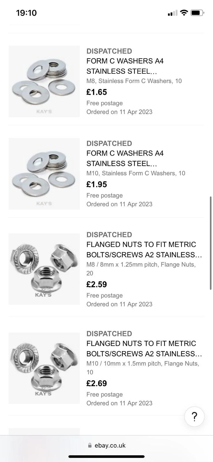

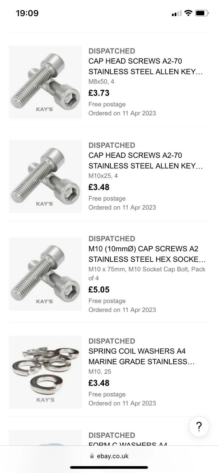

Great thank you.
Ordered up bolts etc now, so all good.
I'll post what I ordered on here, in case it helps anyone else for future reference.
