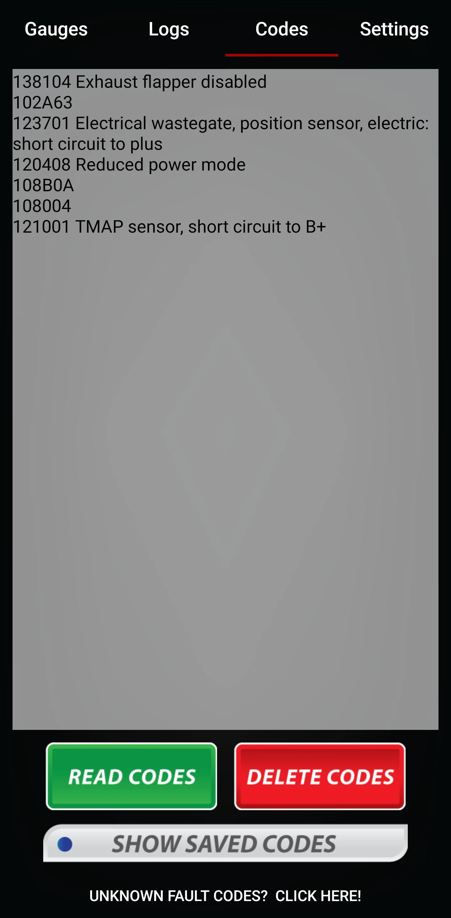

I dont know what to do here, do I check the pins?

yes
disc batt, check all connections, rec batt and try again. look at all the pins too for something bent or missing.
Okay I checked every single pin, they look fine. I guess now I just disconnect battery

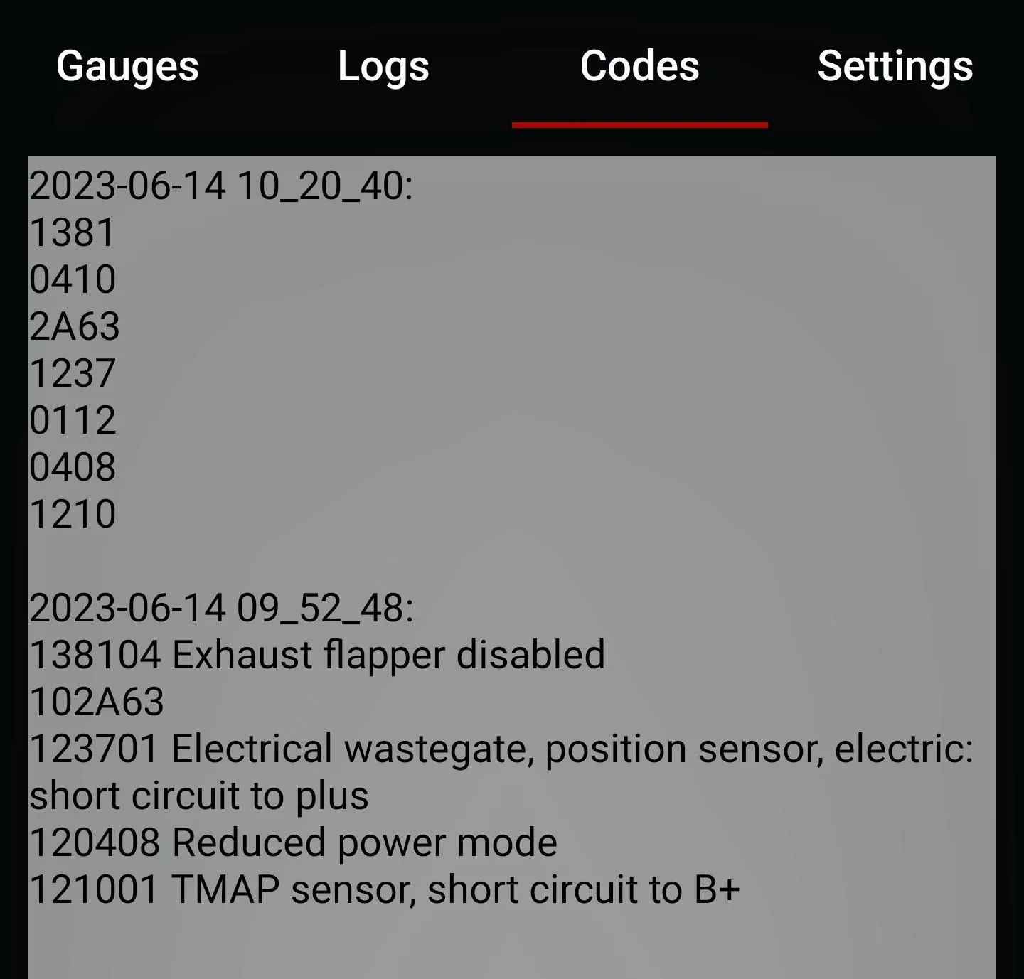

This looks better now. The top list of codes you have are faults/shadow codes.
I am honestly surprised at how fast I took apart everything, checked all ports and put it all back on. Took only 30 min. Anways im gonna disconnect the battery now and reconnect yeah?

So I haven't disconnected battery yet, but CEL is gone, should I delete these codes?

I would have disconnected the battery before you adjusted any sensors and left it disconnected while you were adjusting it.

Definitely check out the wastegate and MAP sensor connections. It looks like something(s) aren't quite right.
