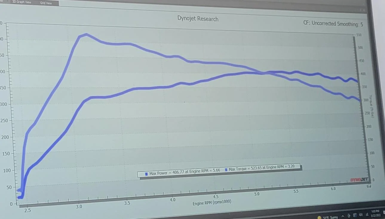

Results from Mike Botti's custom dyno tune on 93 with no other mods:

  • ECU unlocked and Stage 1 ECUTEK tune from Mike Botti (mainly done to eliminate the burbles), now making right around 400 at the wheels on 93 at near sea level.

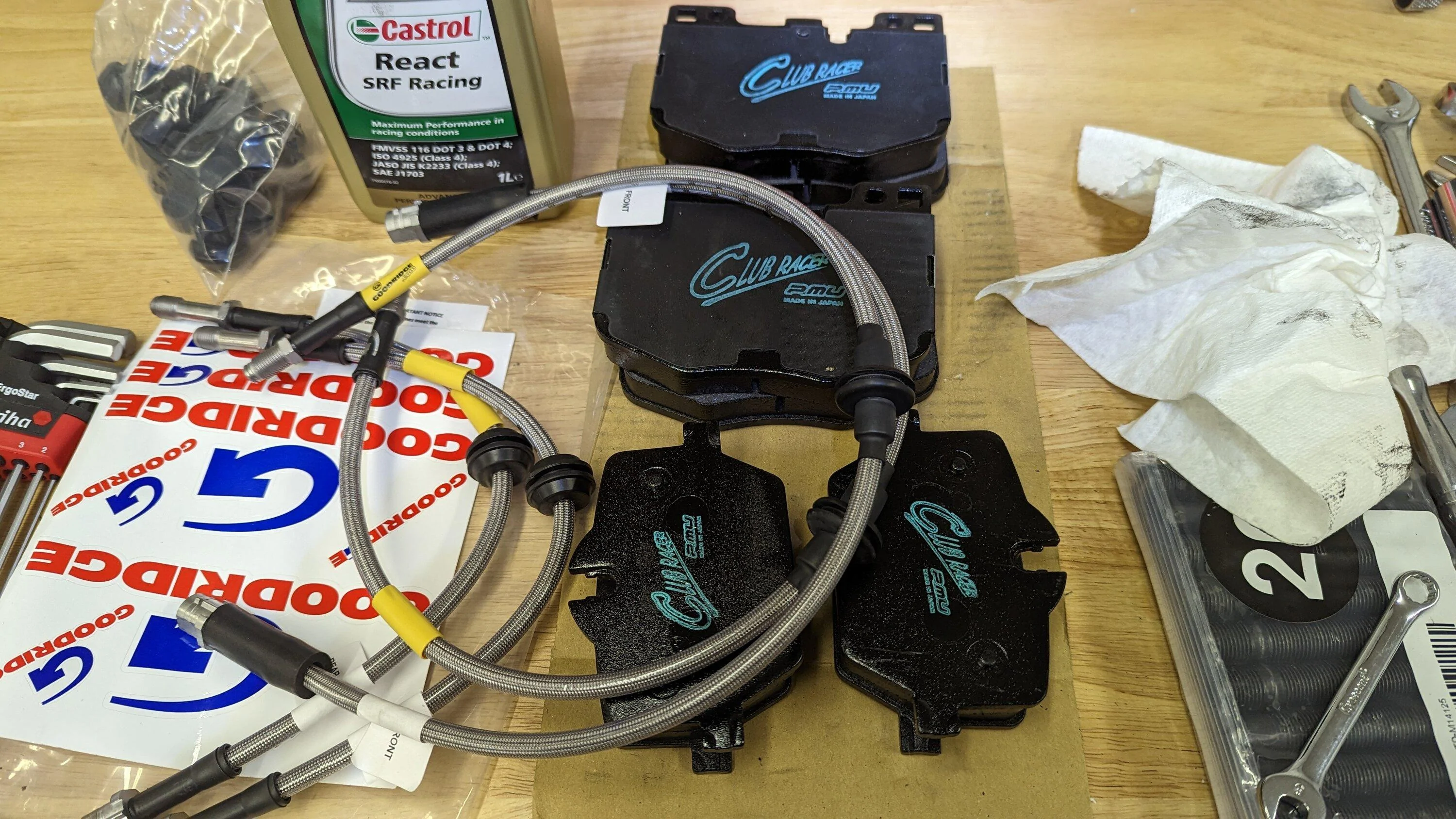

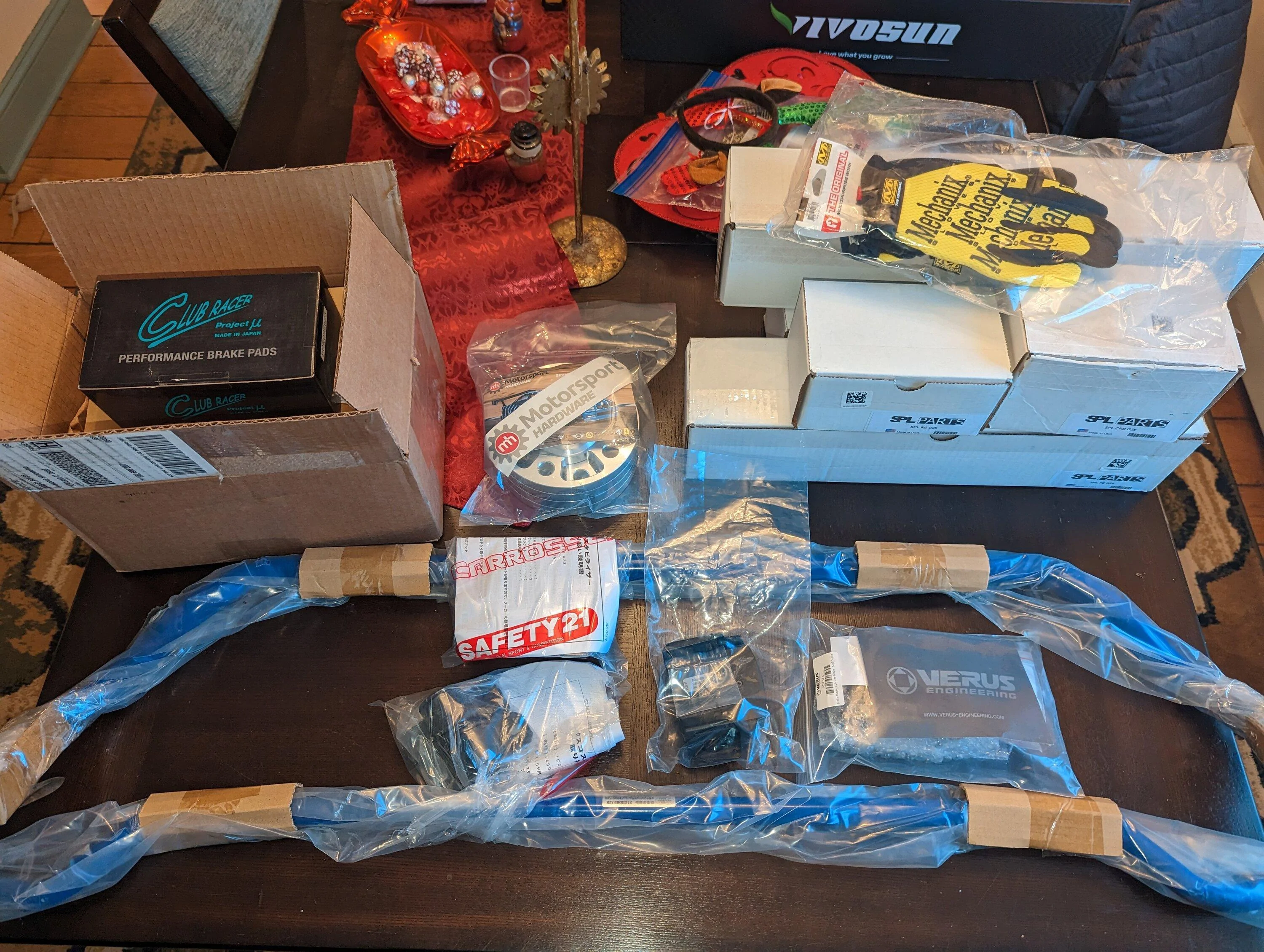

Brake Upgrades (Ordered):
  • Project-µ F+R Pads
  • Castrol SRF
  • Goodrich SS lines
  • Verus MC Brace
200 tw tires and supporting mods (Ordered)
  • Kumho Ecsta V730 275/35R18 (square)
  • Titan 7 T-R10 18"x10.7"
  • 15mm spacers front and rear (temporary until I upgrade to MCS 2-ways)

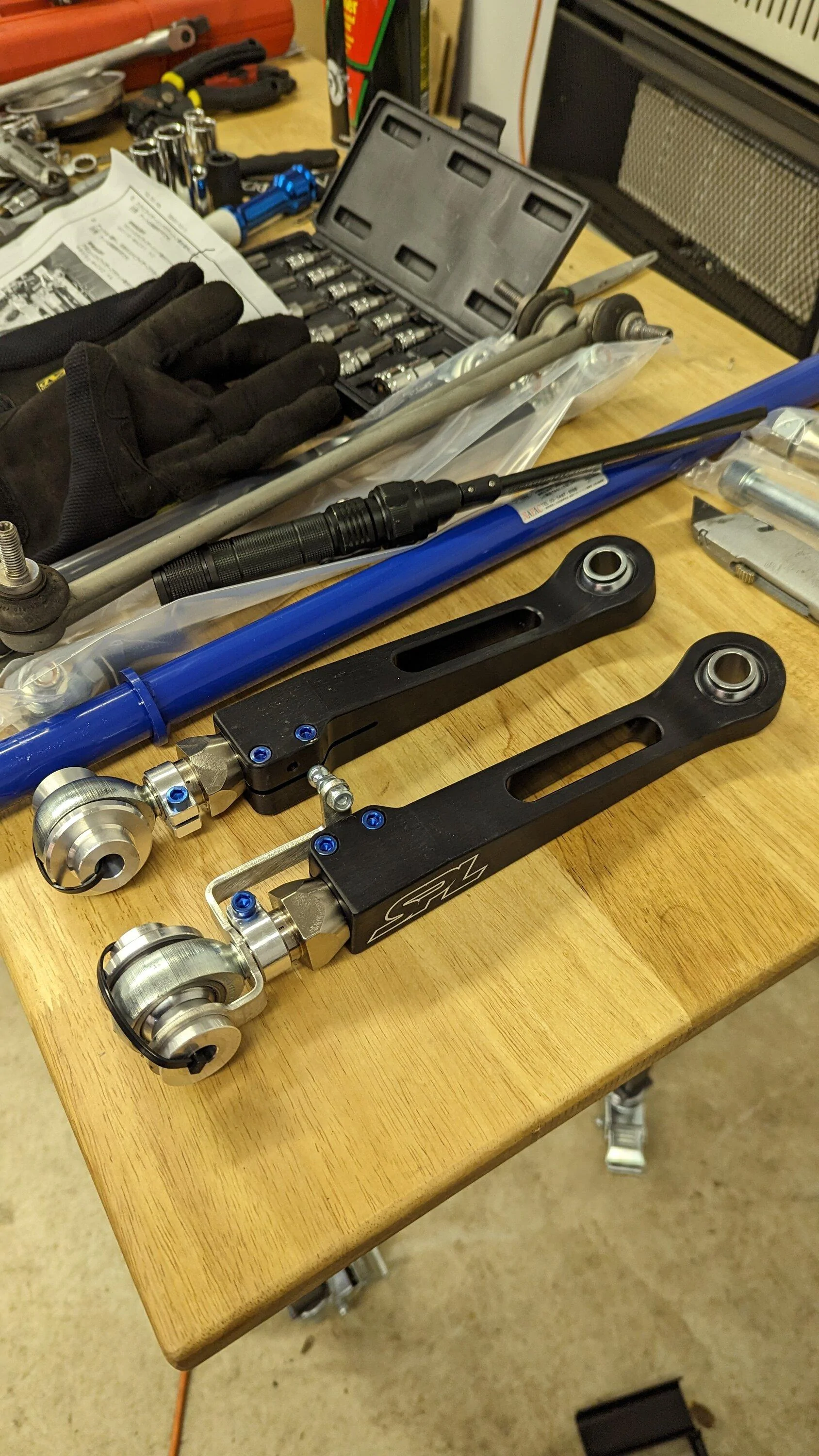

  • Cusco Sway Bars
  • Jackie Ding's Level 2 Handling Kit
    • SPL Front Lower Control Arms
    • SPL Adjustable Front Caster Rod Monoball Bushings
    • SPL Rear Toe Links + Eccentric Lockouts
    • SPL F&R Adjustable Swaybar links
    • PhD Racing Lab Setup Guide and Support
  • Wheel Stud Conversion with 90mm studs
  • TPMS for all 4 wheels

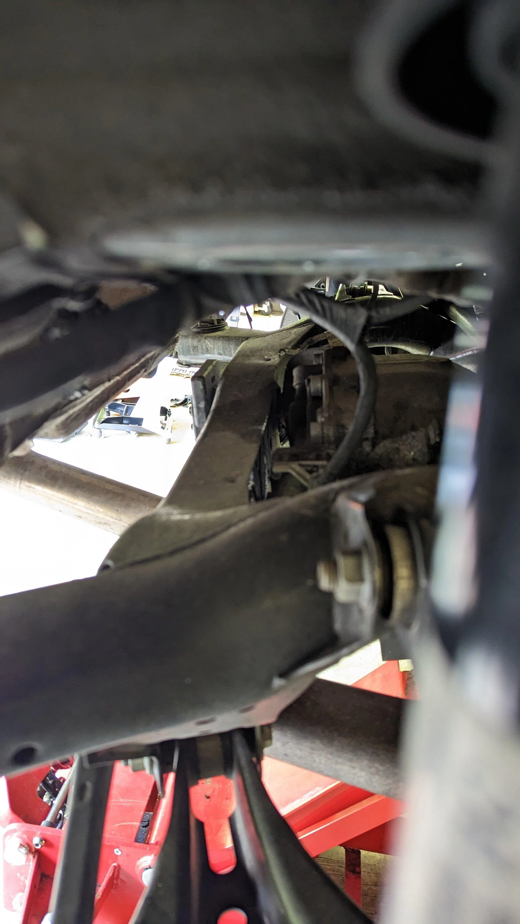

The only DIY install that doesn't look doable is the rear swaybar install. I don't have access to a lift and dropping the subframe without one seems like a royal PITA. I've done crazier stuff when I was younger and had able bodied friends willing to help, but being in my mid-40s with some health issues and doing this by myself it's a bit much.
After calling several shops in my area about the RSB install (and being outright rejected, even indy BMW shops) I found a "motorsports" shop near my work that can handle the install, alignment, and corner balancing when I upgrade to coilovers.

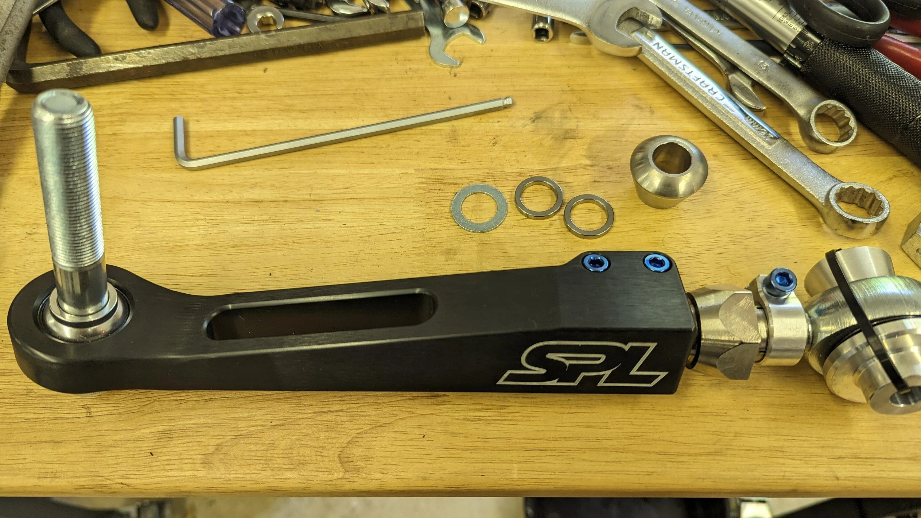

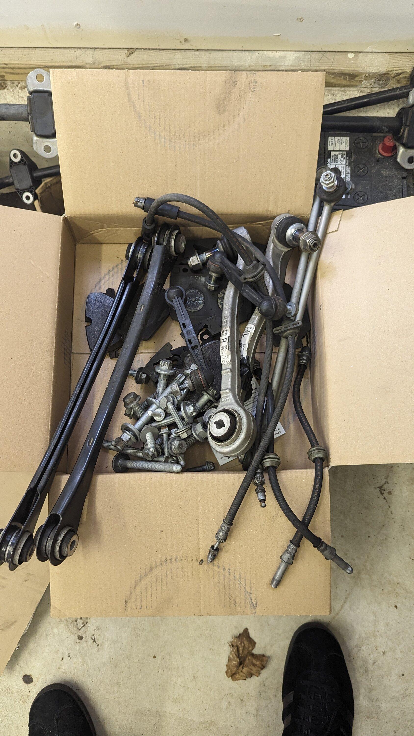

I found time to install a few parts, but took some time off from work and dug into the car. I really wanted to get the parts I purchased on the car before the season began.

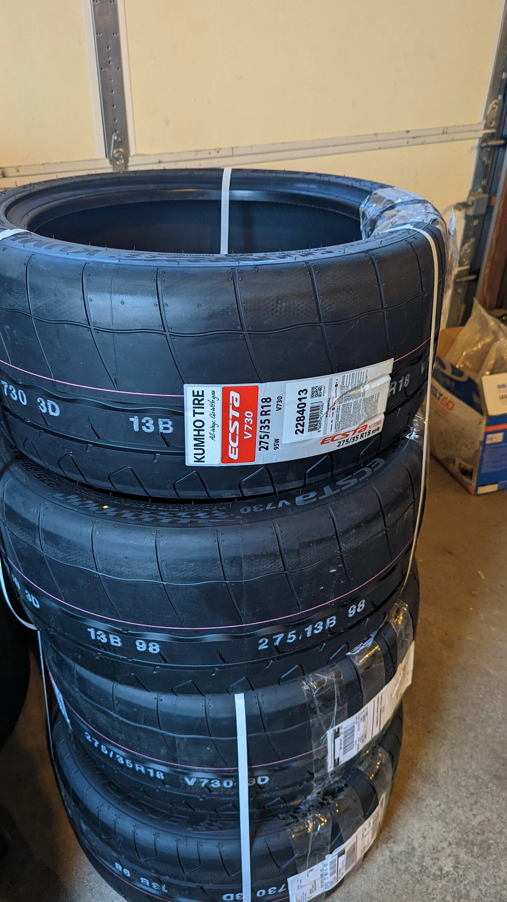

ETA Side note: the Titan-7 wheels I ordered took longer than expected to show up, so unfortunately I ended up driving the 12th on stock wheels with stock PSS. Good news is I have a set of 4X 275-35R18 Kumho Ecsta V730 tires waiting to go on the car and the wheels are supposed to arrive on the 17th! 😁

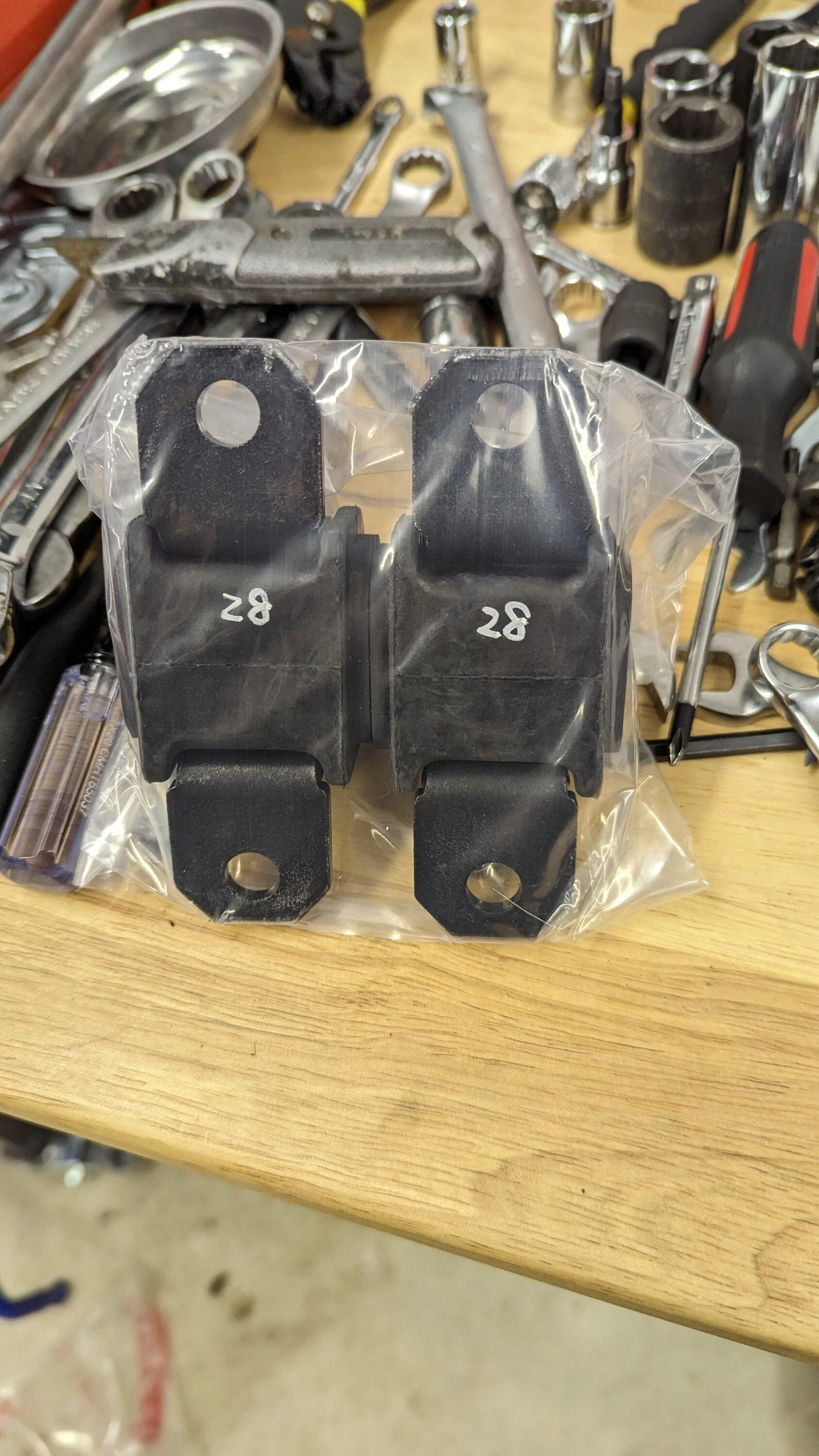

Here's a list of the parts I have installed:
Suspension:
  • SPL front LCAs
  • SPL front end links
  • SPL rear toe links
  • SPL rear toe lockout
  • SPL rear end links
  • Cusco 28mm front sway bar
  • Cusco 22mm rear sway bar

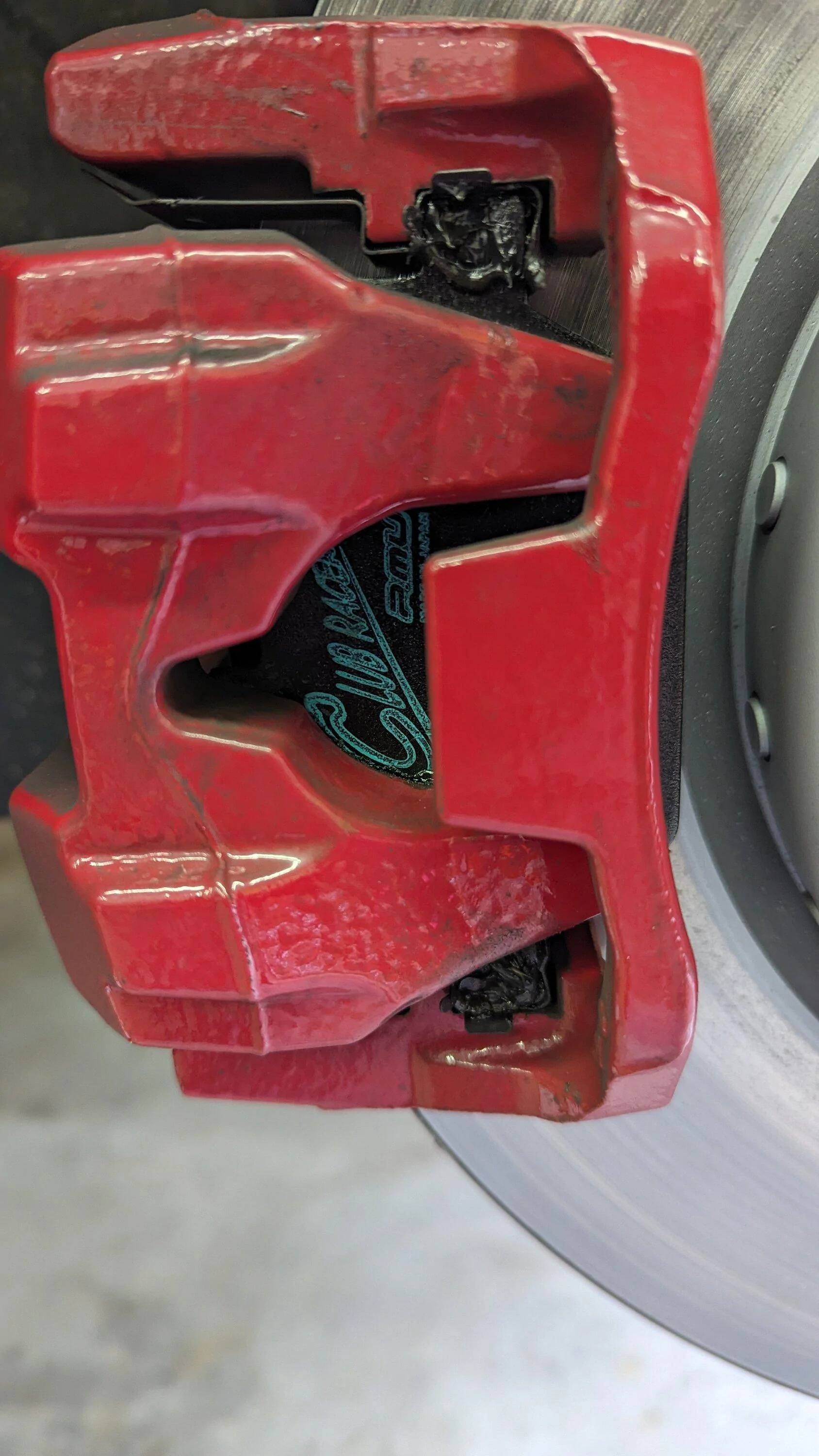

Brakes:
  • Zimmerman rotors
  • Project Mu Club Racer pads
  • Goodridge stainless lines
  • Castrol SRF brake fluid
  • Verus Engineering MC brace

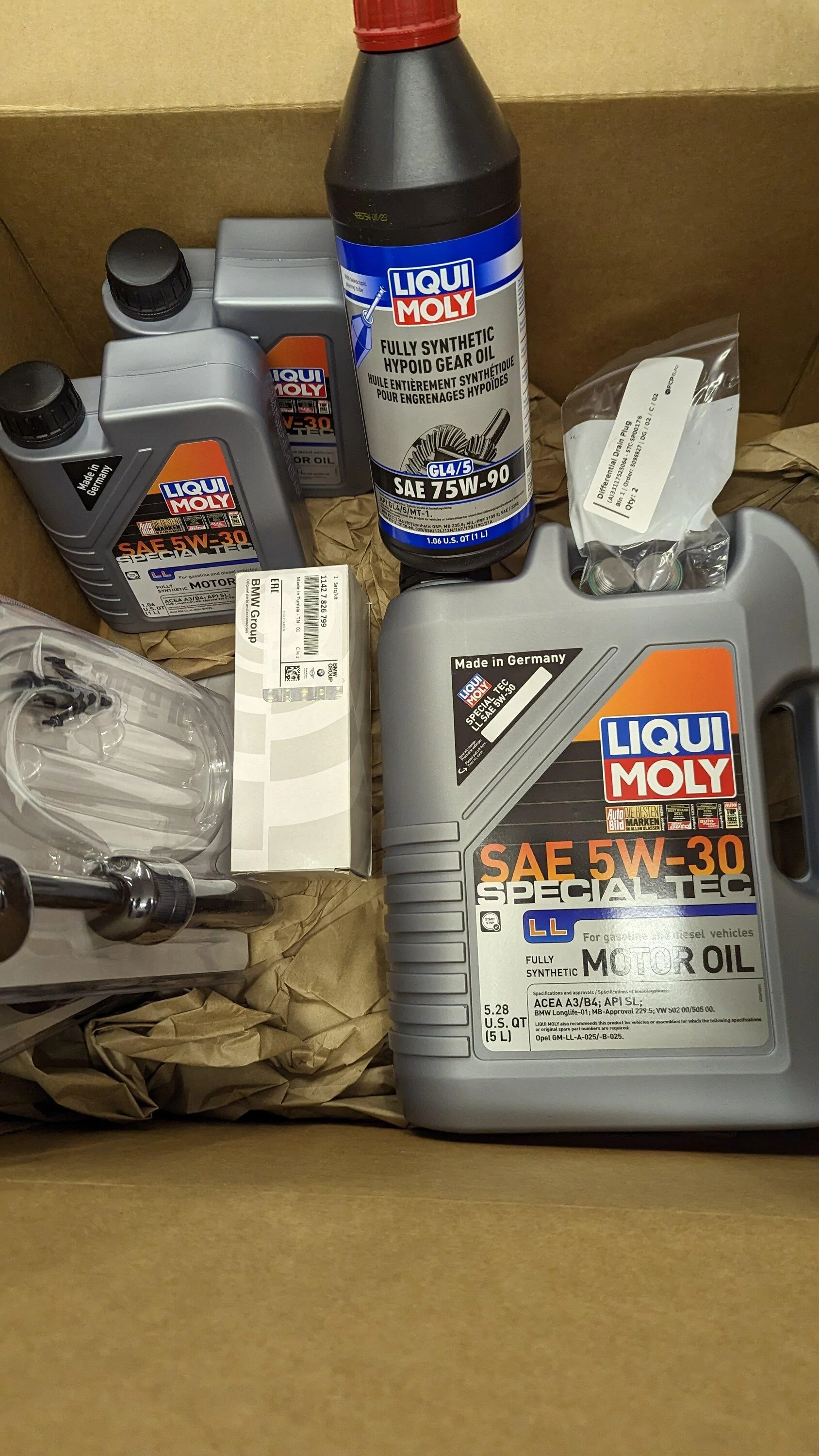

  • Engine oil change with Liquid Moly 5W-30 special tech
  • Rear differential fluid change with Liquid Moly 75W-90 Hypoid GL4/5

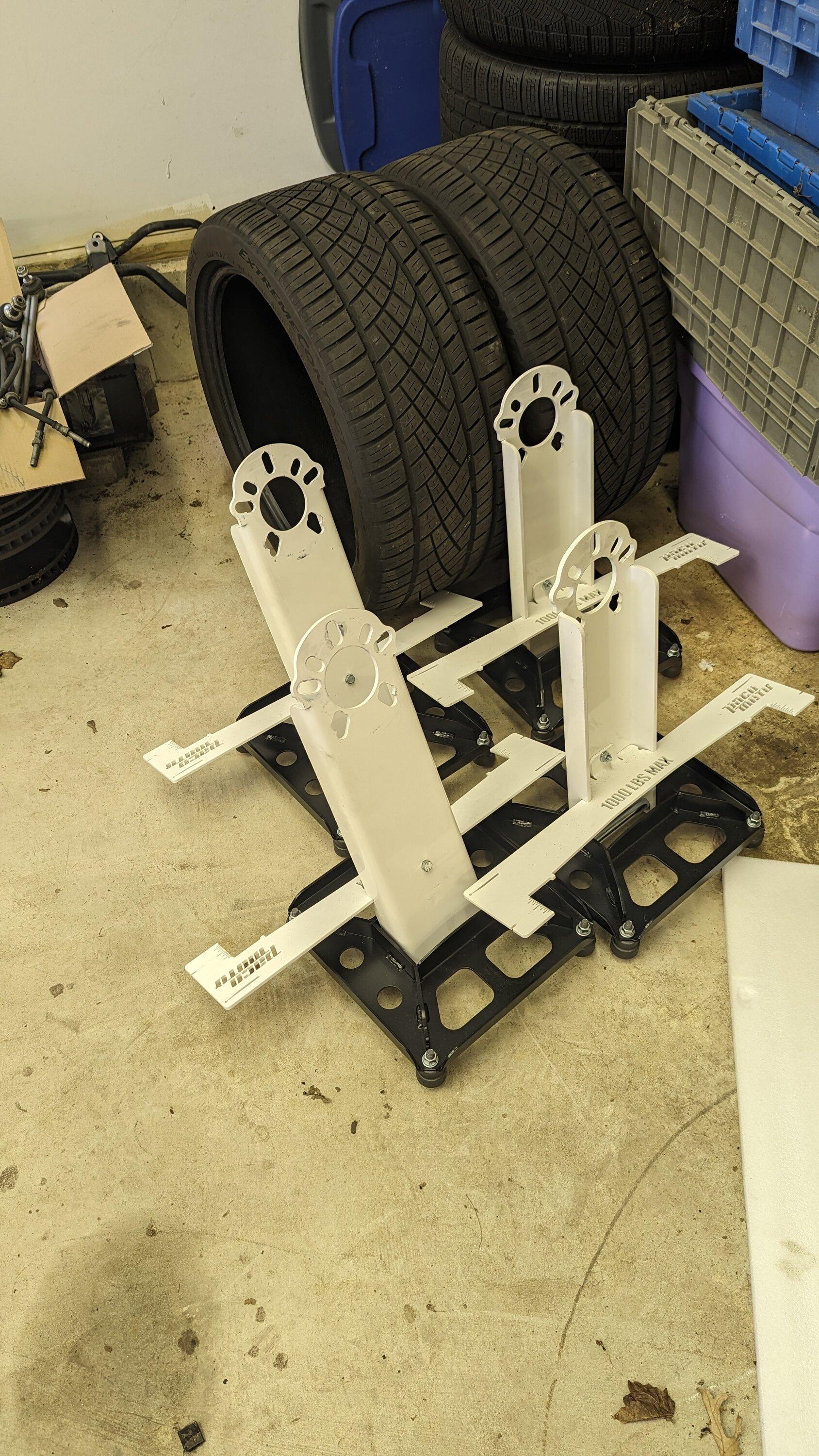

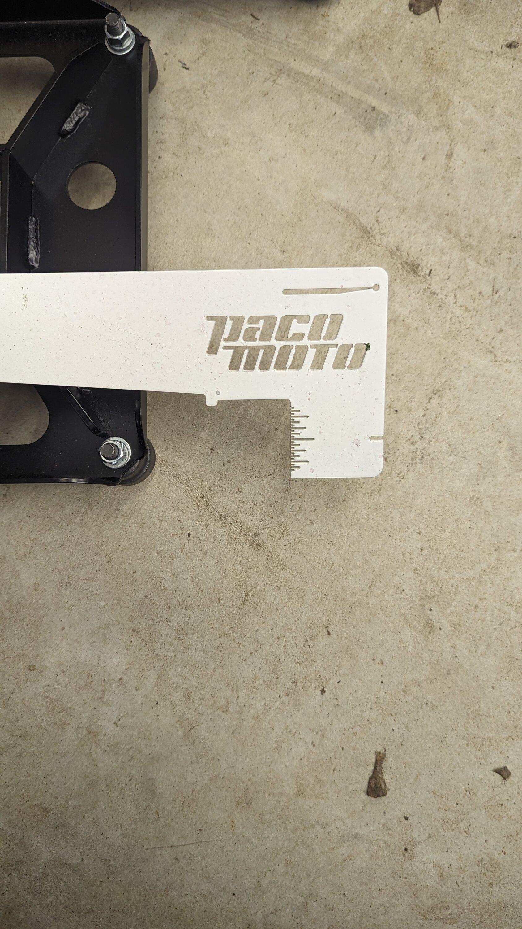

Last but not least, I did an alignment with my Paco Motorsports Hubstands, and let me tell you, it came out perfect and I can't recommend this product enough.
Final alignment specs:
Front: zero toe, -2.8 degrees of negative camber (caster not adjustable so it wasn't checked)
Rear: 1/32" toe in on either side, 1/16" total toe (camber not adjustable so it wasn't checked)

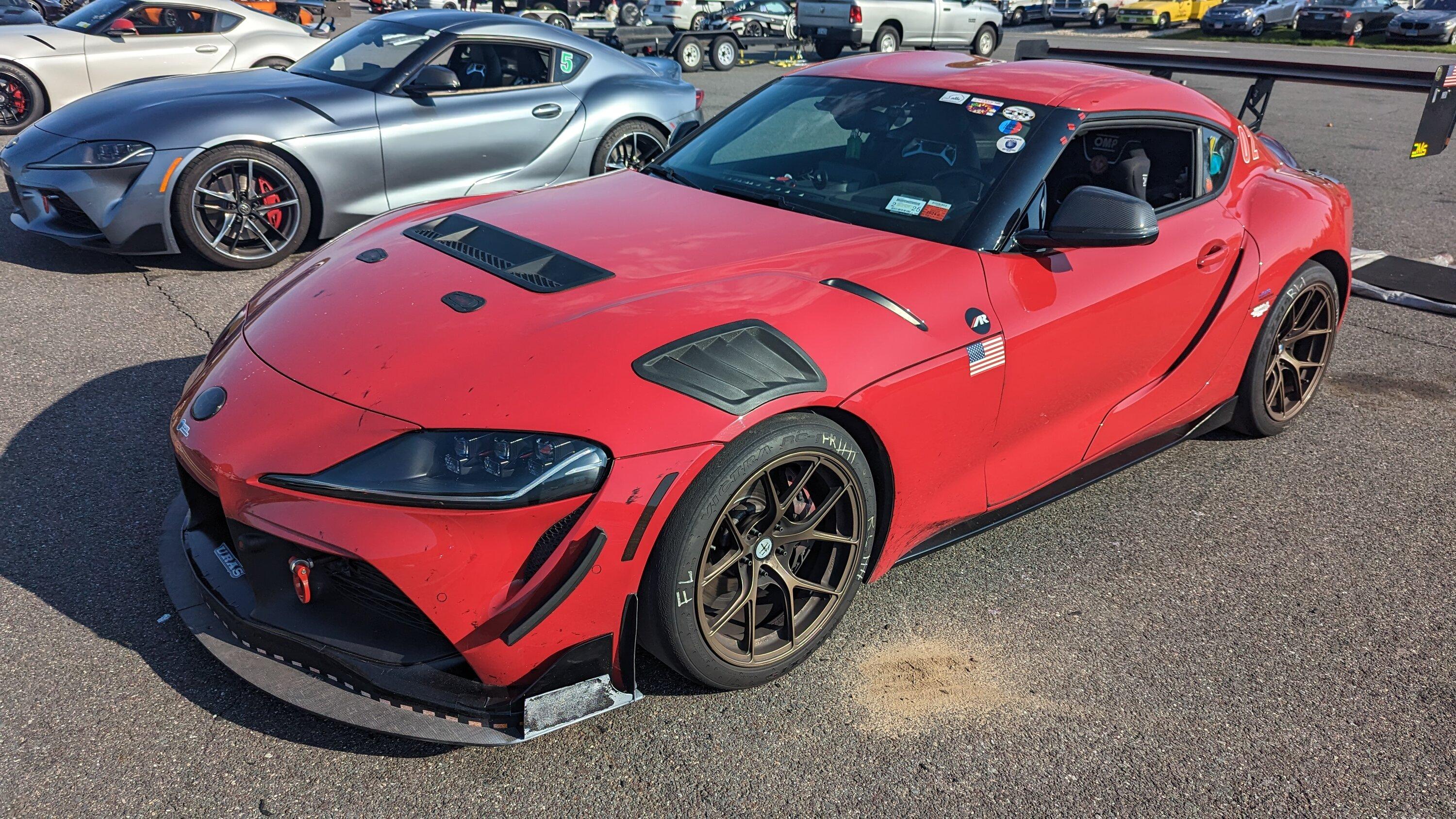

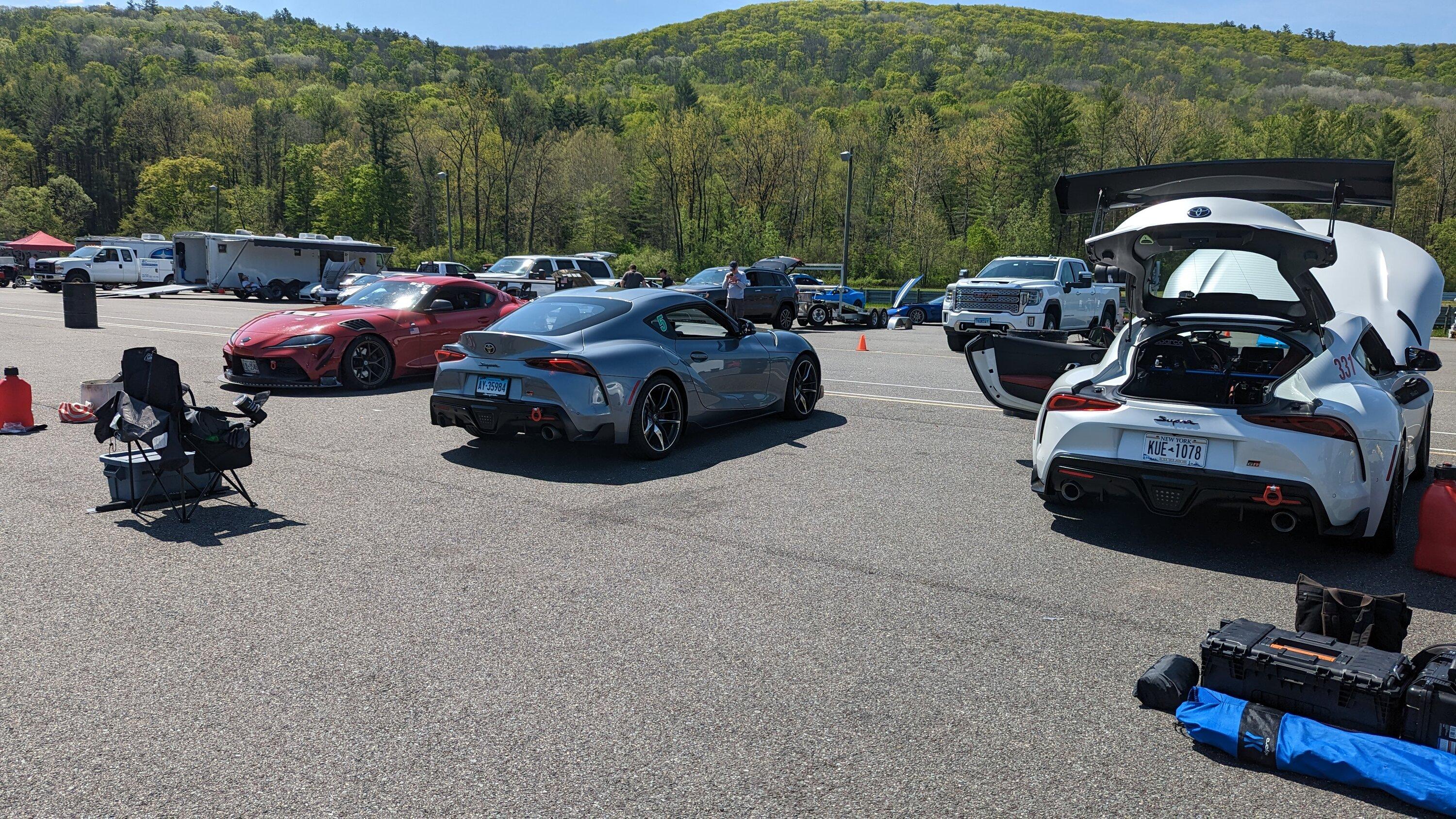

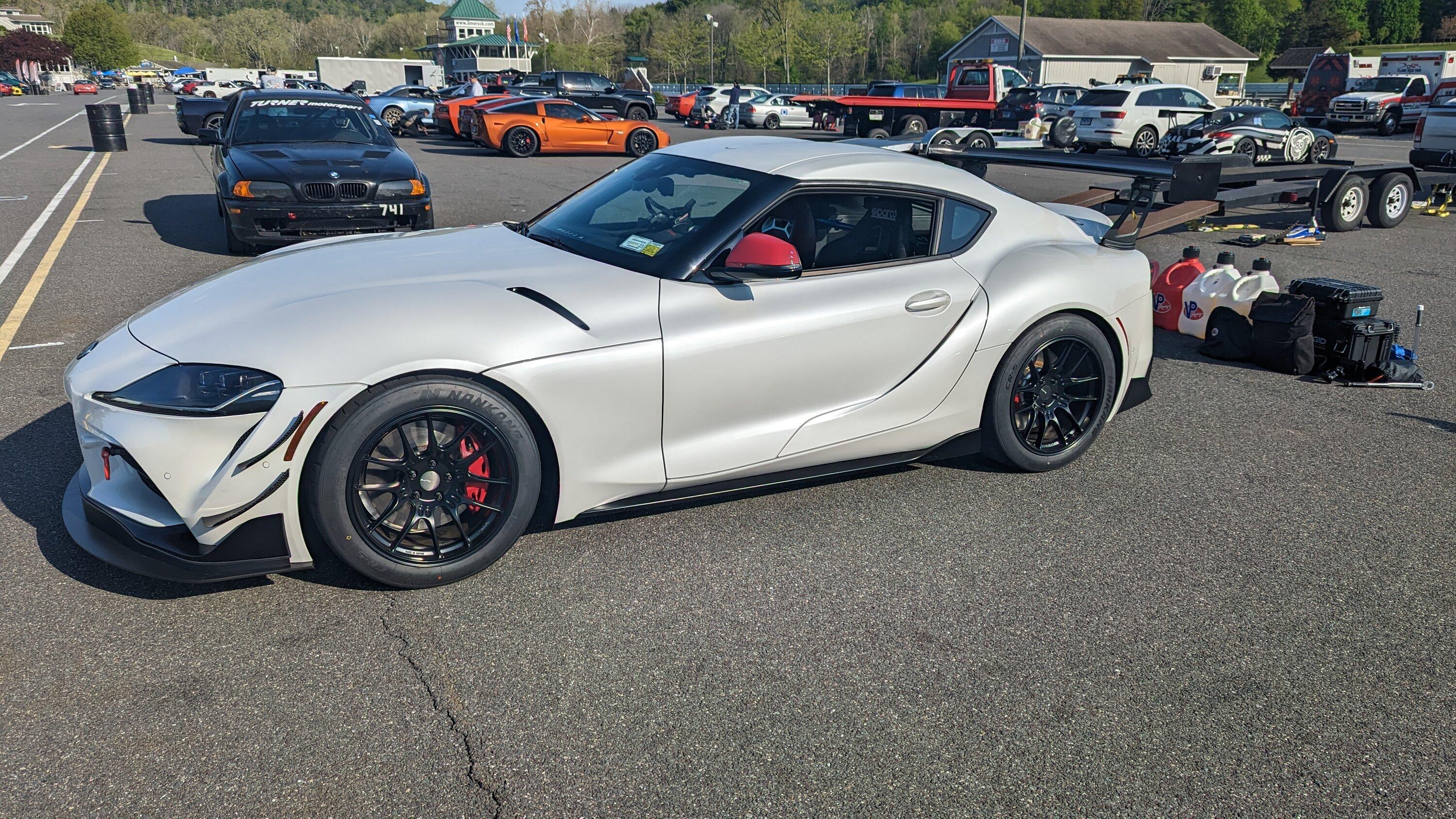

I'll add a better write up and pics of the track day on the 12th at Lime Rock Park, but suffice to say it was incredible! Met up with some great people from the forum and had a great time. The parts and work on the car really came together!
Here's a couple shots I took on my phone:
