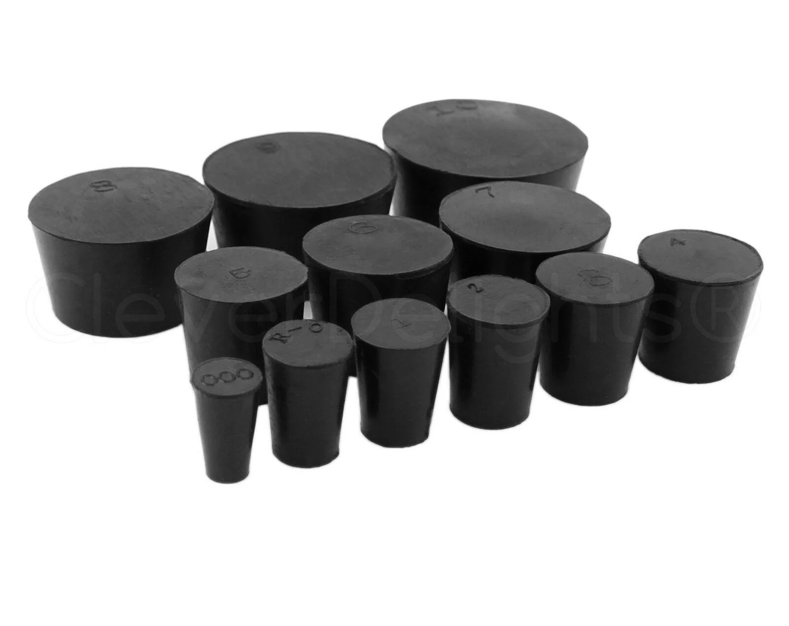

Agree. I'd replace the cork with a rubber stopper.

What diameter rubber stopper is recommended.

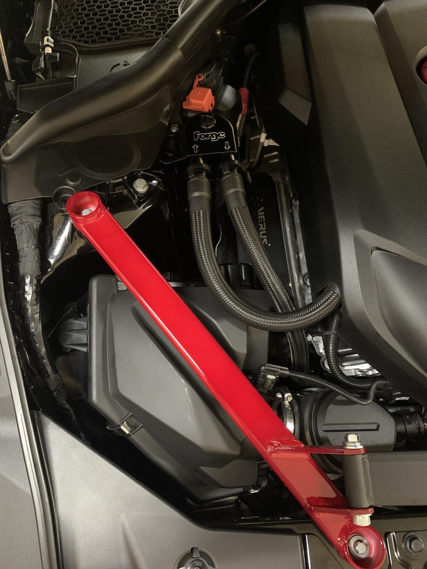

I personally don’t like the huge gap that is present with the verus cap. At the end of the day you won’t see the cork assuming you put the stock resonator back as I did. Just for the stock look while removing its functionality.
Actually the empty space will be a good place to add a AOS or Oil catch can. Also you can view the Verus turbo heat shield if you installed one.

Exactly what I did. The Toyota air box is actually not a bad design. Get rid of the resonator, remove the foam baffling, and get an AFE high flow filter. I added a Verus shield and a Forge separator. Looks great. I honestly think the Toyota air box is flowing as much as an intake, but don't have data on that. See several guys running like this.
I sold my Injen and made this mod. The AM intakes use up a lot more space. Except for the CF ones that are crazy money.
