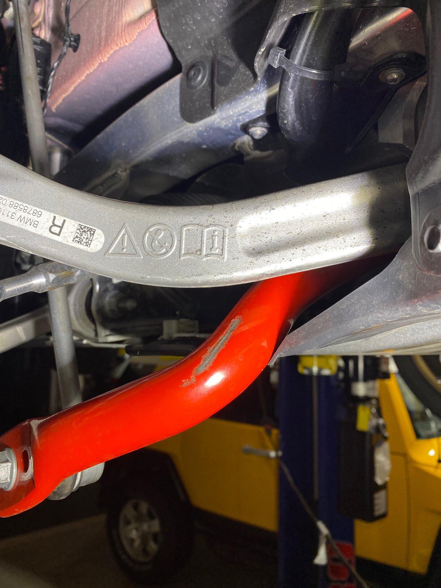

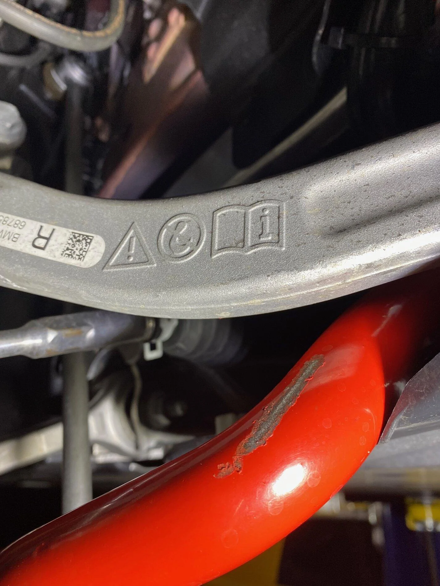

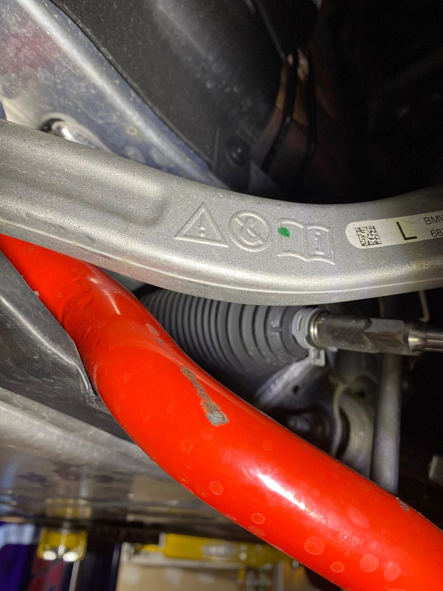

I just installed an Eibach's front sway bar along with some Vorshlag camber plates (all else stock). After coming back from the alignment shop, I noticed the front sway bars are hitting the lower control arm. The rubbing marks appear to be even on both sides, so it's not from my sway bars being positioned too far on one side vs. another. My finished alignment settings for the front are -2.5 camber, 0 tow, and 7.2 degrees caster. Has this happened to anyone else and if so, what are some ways to remedy this?
Thanks!

Just spoke to David from Eibach and they are checking to see if the production run of my sway bar has an issue. he agreed that alignment setup does not affect the sway bar's clearance.

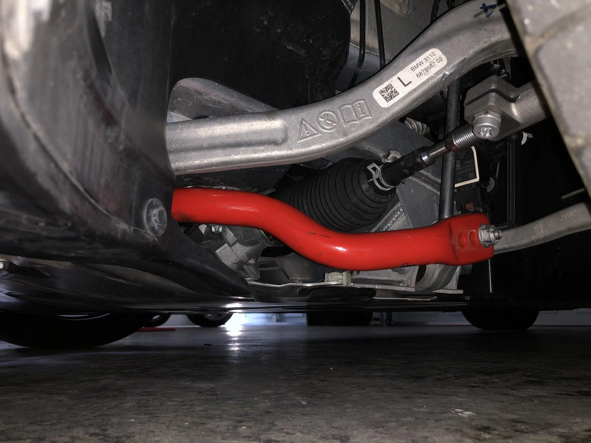

here's photo of my installation.

Not sure if it's the angle but I just installed Eibach Front & Rear Sways and ProKit Springs and I feel like mine on the ground has much more space than yours from the control arms.

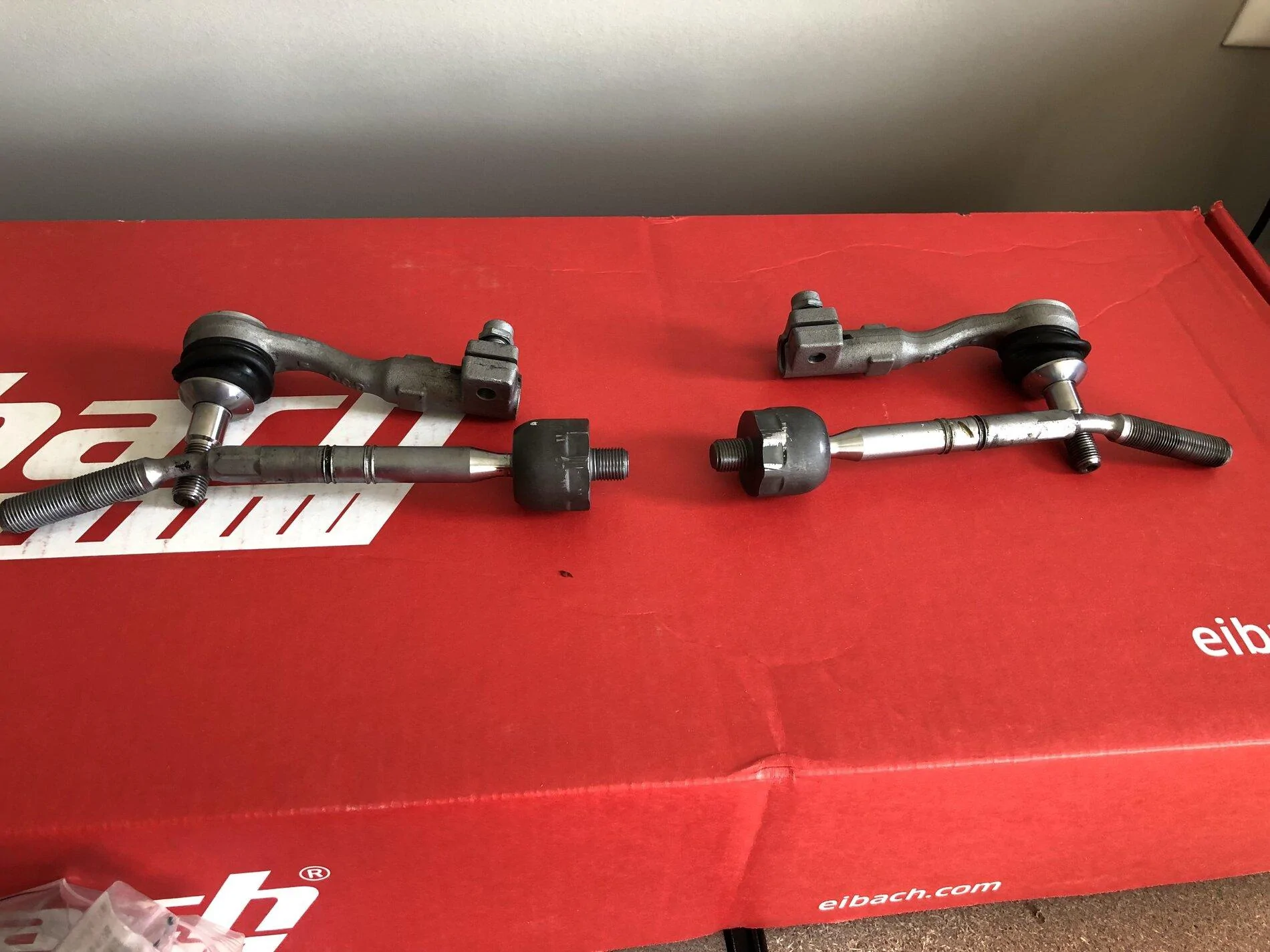

Also, if anyone's looking for a thursday afternoon laugh, here's what happens when you install that front sway bar backwards! Pulled a big dummy move here, sway bar did not look like it was really damaged just the inner tie rods were instantly bent. Sweet way to burn $300 extra dollars on the install... Also the Eibach label on the bar is upside down when correctly installed.

Those are the same exact batch numbers I have. My fix this evening is to make some 1/8" spacers. I then taped the spots it used to rub with masking tape and did some hard cornering - no rubbing so far.
I personally would hold off on putting these on your car until I find out some more info from Eibach on how they plan to remedy this.

Ouch!
Mine is very similar and the only reason it looked so close apart is because the suspension is at full droop since it's on my lift. I did a quick measurement when the car is on the ground and it's about 1.5-2" from LCA to Sway bar.
