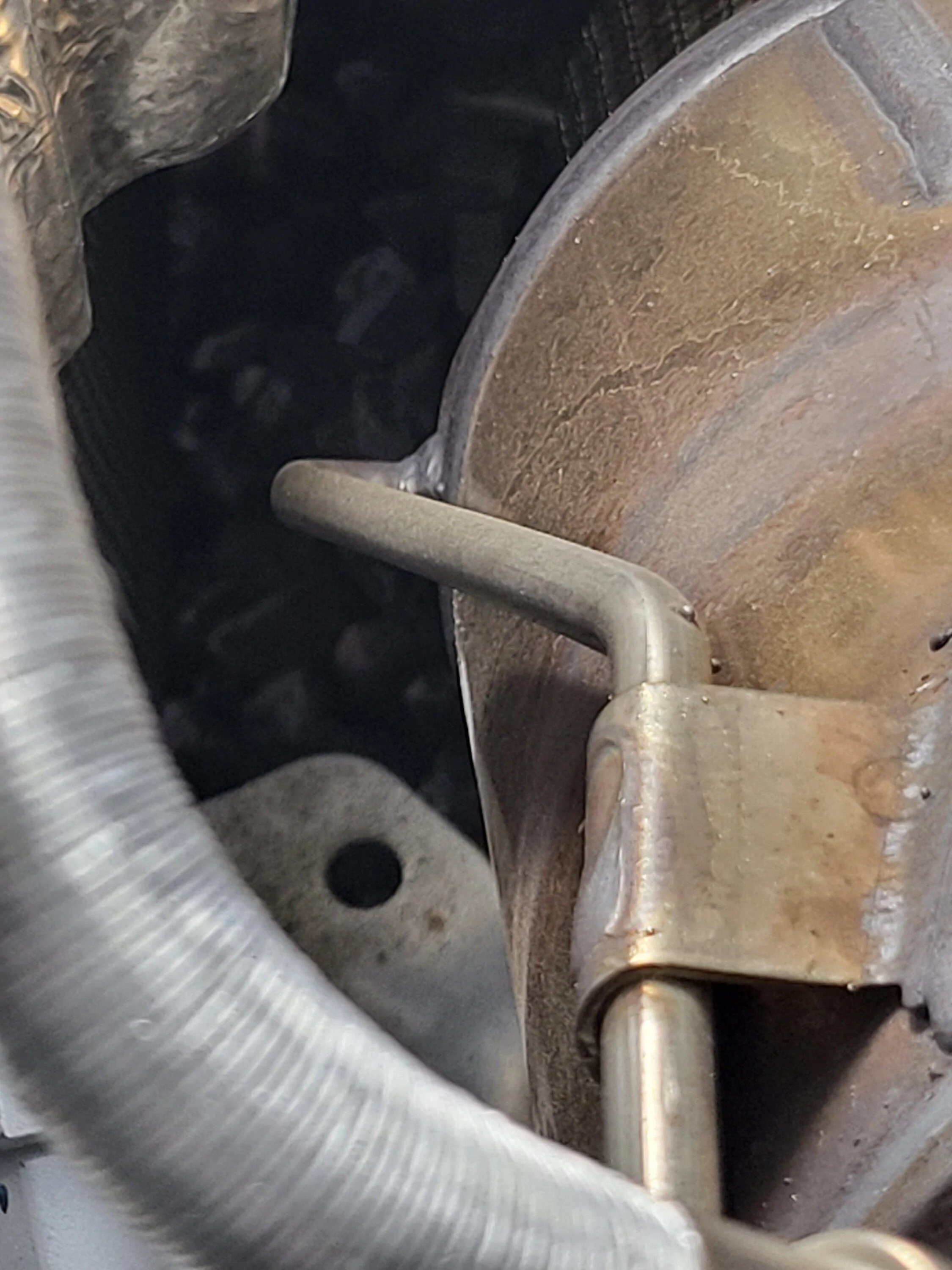

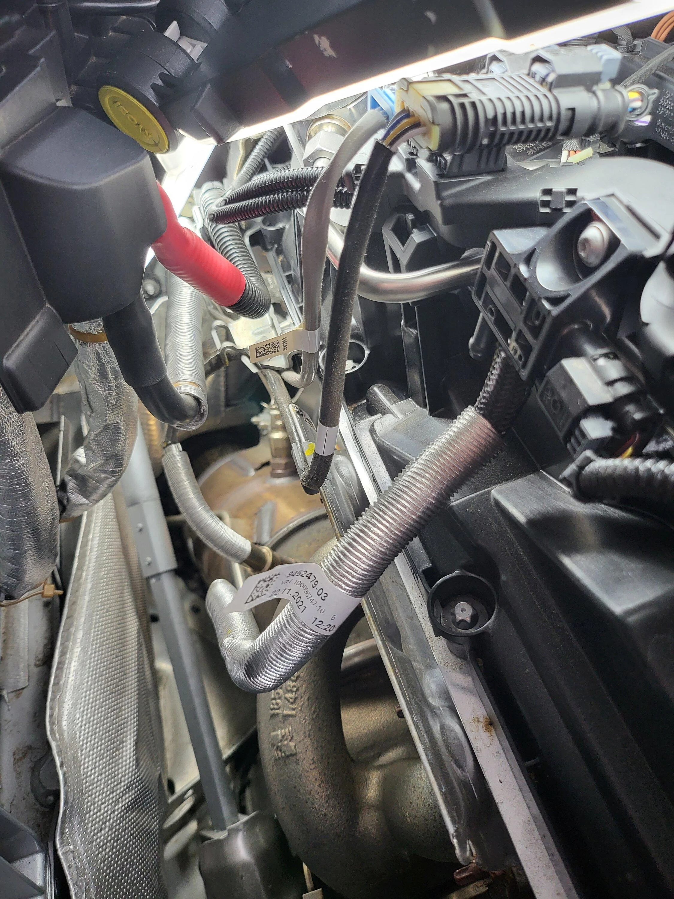

Hey guys is anyone rocking a cat back exhaust? Do we need to get an OPF delete module? I've had a look and there doesn't seem to be any cables running from the OPF only from the Cat.
I'm looking at a Cat back exhaust but want to make sure I don't need to do anything else.

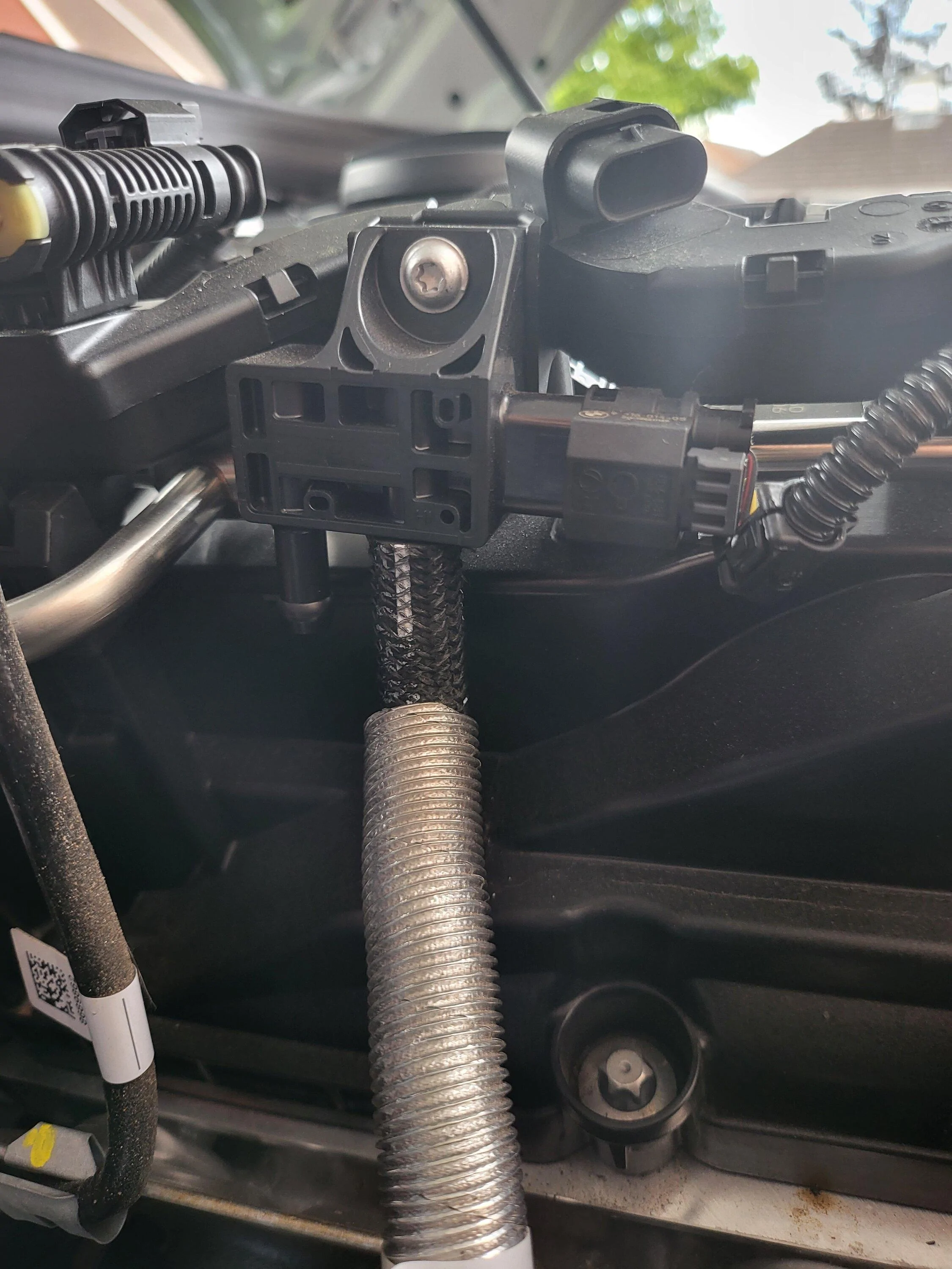

Thanks, Yeah it's really unclear with our OPF supras whether we get the error or not, other bmws have the sensor attached to the OPF but I can't physically see a connection.

I can see where it would connect, similar to the aftermarket delete module, but only the Cat has a connection and a blank slot next to it.
