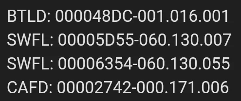

3a. When I flashed BM3 for the first time, these were the software versions present on the vehicle:
4. The next time I flashed any sort of software was their switch to Multi-Map in November of 2021. I've been running that map ever since.
4a. After updating to multi-map, sometime over the last year, my software versions are now this:
5. ProTuningFreaks says this software is so new they can't work with it. Of course that's impossible, because the car is tuned right now on Bootmod3. I unlocked and flashed it with their own software over a year ago!

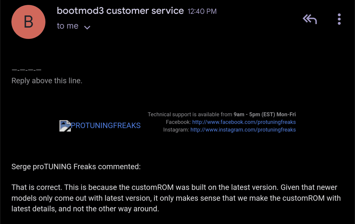

Aaaand here's confirmation of what I expected, from their support:
I just talked to the development team here and here is what happened in chronological order.
  1. You activated your license with a certain set of software details that did not require a bench unlock.
  2. You flashed your maps without any issues.
  3. Once the customROM was released (map switching, anti-lag, flex-fuel), your ID’s got upgraded. CustomROM was done based on software details that require a bench unlock, as those were the latest software at that time.
  4. You can still flash your OTS maps without any issues.
  5. To flash the STOCK RELOCK tune, we would need to update your stock tune details to the latest software.
  6. I am not sure what the purpose of your stock tune flash is, but in order to not need a bench unlock, we suggest that you just flash the stock tune(customROM) version.

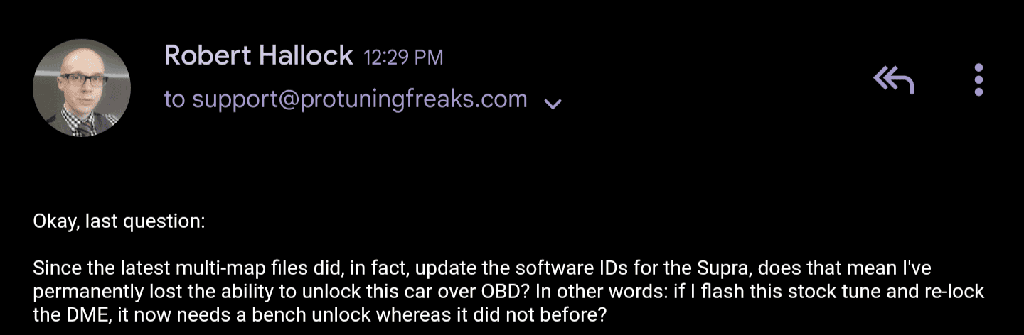

And, to top it off, their multi-map files have permanently taken away my ability to lock and unlock the ECU over OBD.
As of now, I cannot transfer or sell my bm3 license anymore without paying for a bench unlock.

I have a freak car: an xx.110.xx DME running xx.130.xx software, thanks to the bullshit from ProTuningFreaks. Marin tells me there are less than 150 of these cars running around. I'm now on Ecutek and not looking back.
Moral of the story: if you have a Supra that can be unlocked over OBD, never run BM3 and never update to their multi-map software. You will lose unlock capabilities, and you will lose the ability to return to stock and sell your license.
