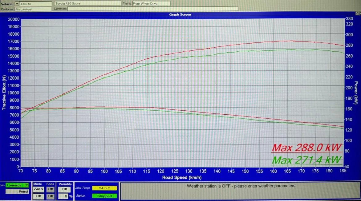

For some reason the tuner didn't dyno the standard tune only custom map on 98 and e50
The car made the following
98ron (93 Octane) - 271.4 KW@wheels (363 hp)
E50 - 288 KW@wheels (386 hp)

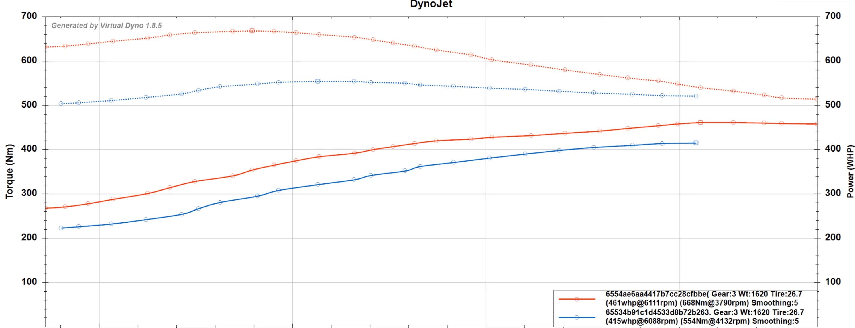

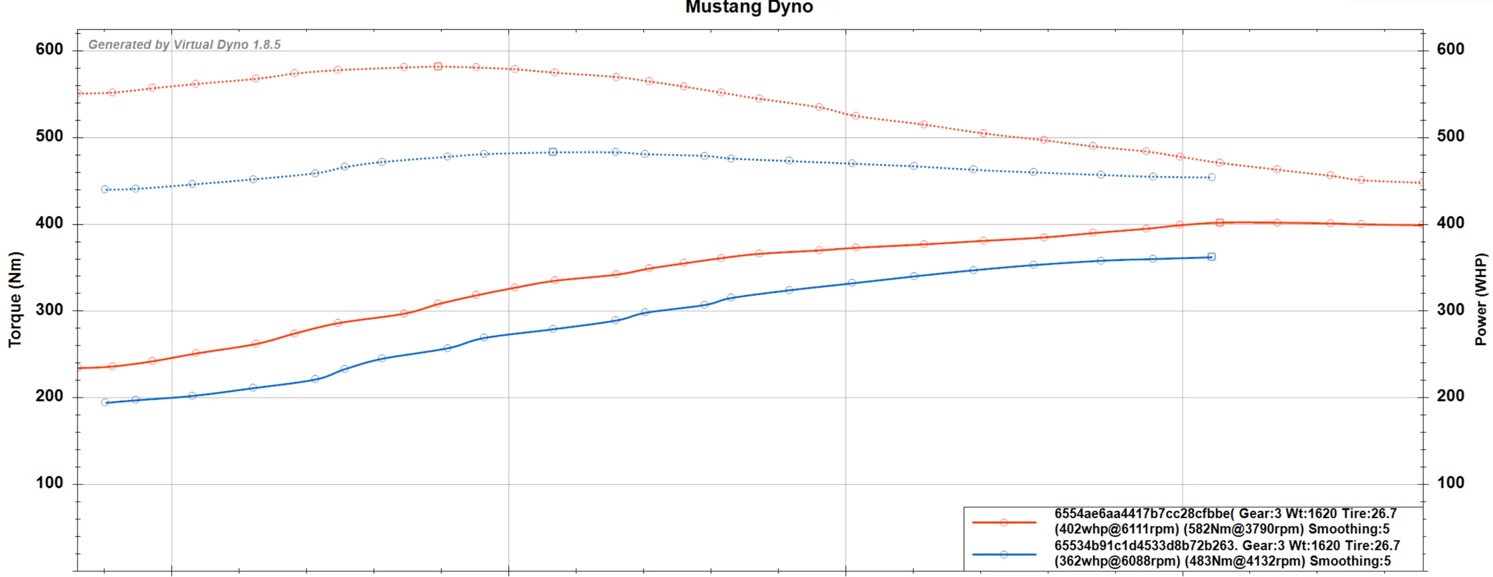

I have displayed 2 of your logs on Virtual Dyno with DynoJet settings (blue is OTS, red is your revision file) and the same with Mustang Dyno to show how big the difference can be. Difference is around 60HP. It is possible that your dyno is reading lower values.

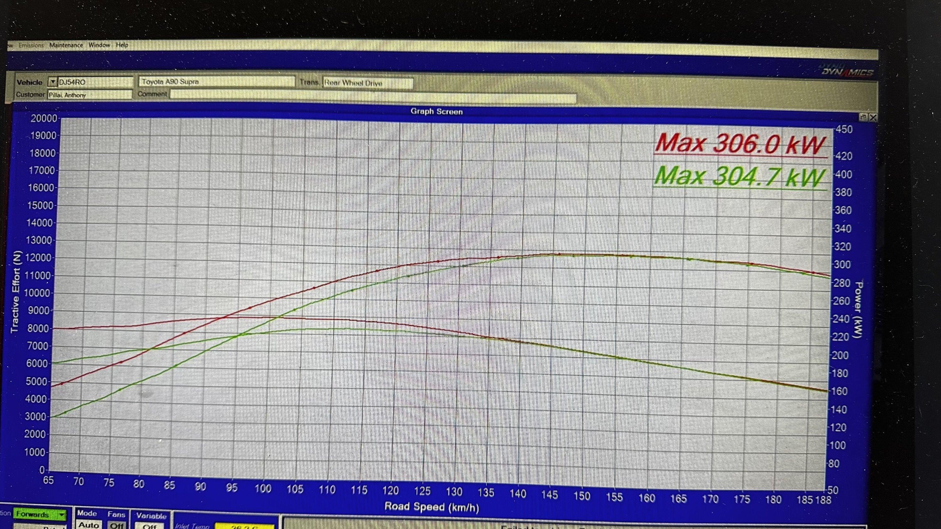

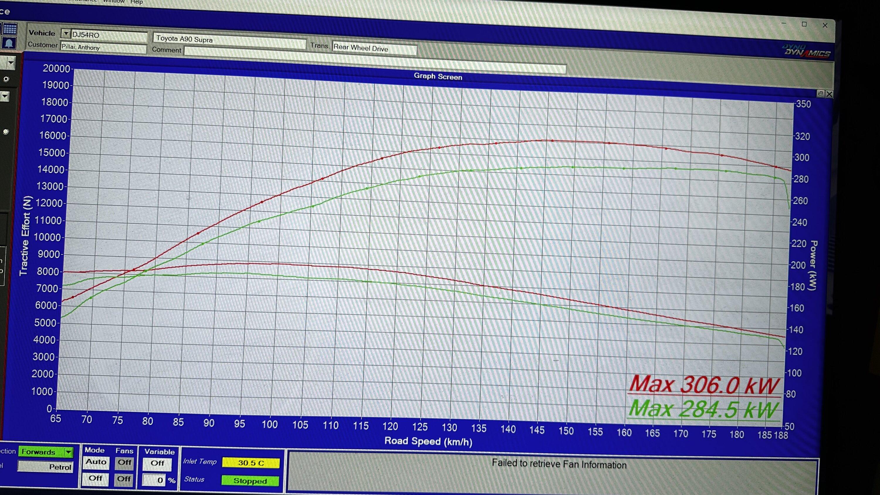

This is the final number I got. The limitation previously is something that I figured out when getting in touch with bootod3 and then told the tuner.
First pic is the old max power on e50 to the new max power with the custom tune
Second pic believe it or not is the custom tune compared to the OTS stage 2
Thanks

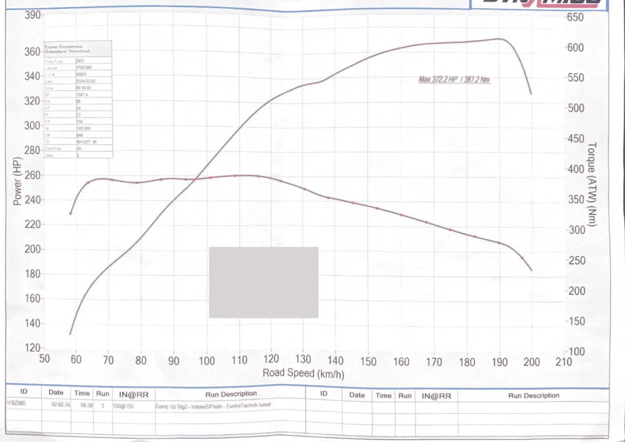

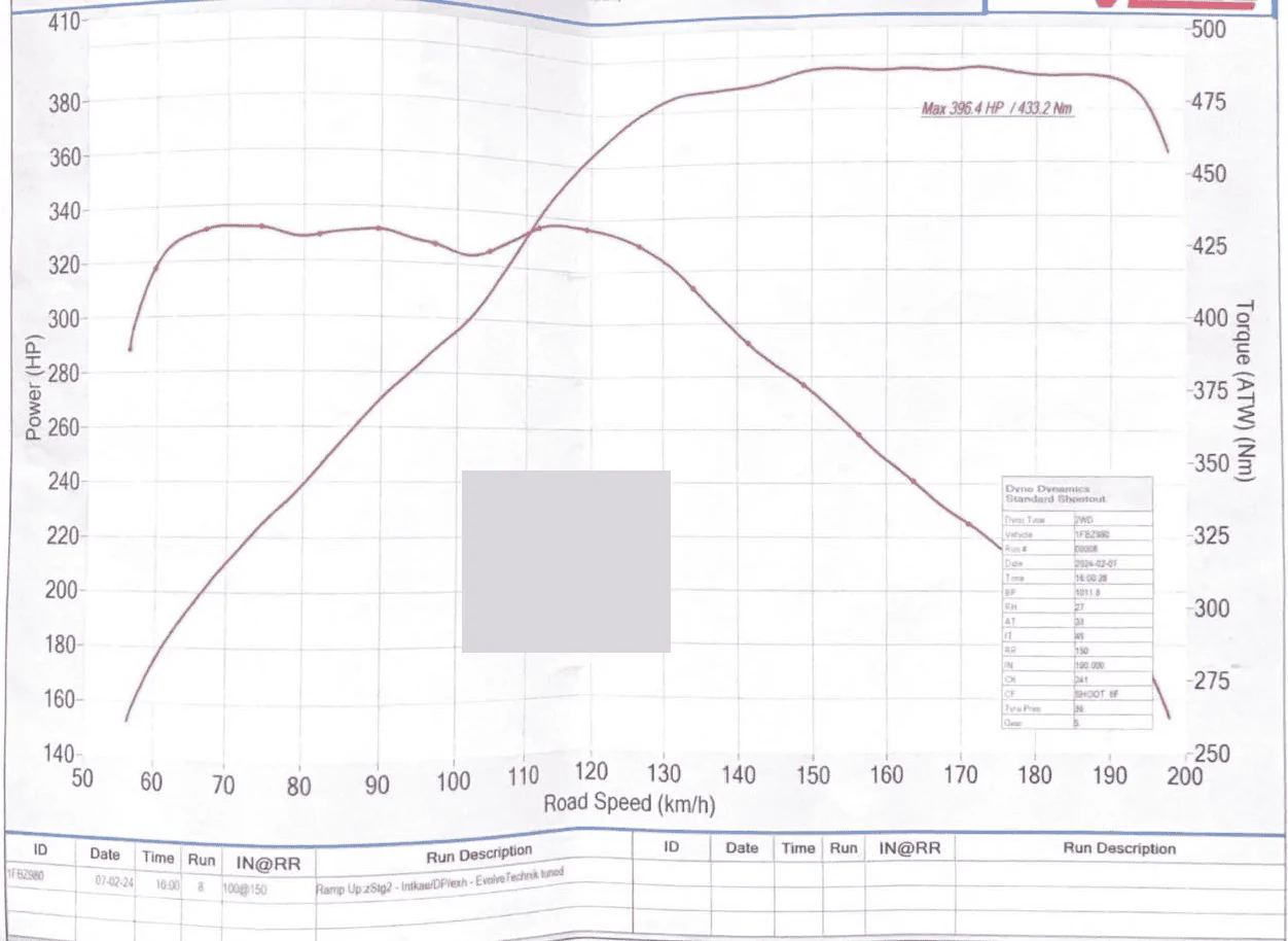

I'm in AUS too, and I just had my car custom tuned on 98. What were your hp & tq figures before & after the tune? I feel like our dynos here (DynoDynamics) read really low.
@Twisted Tuning are you able to have a look at these numbers? catless dp + intake + exhaust 2021 Femto Unlocked tuned on 98. I had the tuner do a revision and it made more power (2nd chart). Thanks :)
