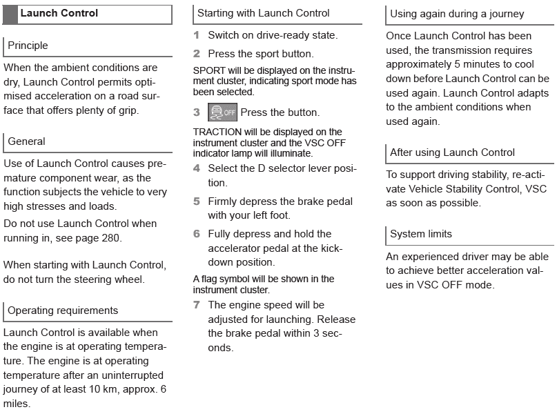

Ok so I basically walked into showroom shook salesman hand and drove off within hour. I’d didnt test drive etc.
How do you use launch control? What are the driving modes? Traction controls? Stability controls? Etc
I looked for videos and guides but didn’t see anything readily available.
Thanks.

All the relevant information will be in your owner's manual. There's a lot of good info in there.

I tried to do launch control for the first time today (as now I am over 1,200 miles) and can’t get it to work.
Yes, yes, I have read the directions in the owners manual, several times....
Car was warmed up, in “d,” sport mode on, traction-off button pressed, left foot on brake, other foot on gas...back wheels start to spin and rpms aren’t limited at all....:dunno:
Any launch control experts out there?

Press the brake as hard as you can, it needs to read basically 100% pedal pressure before engaging launch control. Make sure you're pinning the gas all the way too, and you'll see the Launch Control indicator in your gauge cluster. Also launch control sucks, it launches at like 2k. Generally faster to do it yourself.

Got it thanks, that must have been it, gonna have to give it another try.
Ya, without being a DCT, I assume it is nothing more than the car holding the brakes on at 2k rpm and releasing them...
Thanks for the info.
Edit: It worked, I just needed to push the brake pedal harder. Yes, you are correct the launch control is pretty weak. Thanks again.
