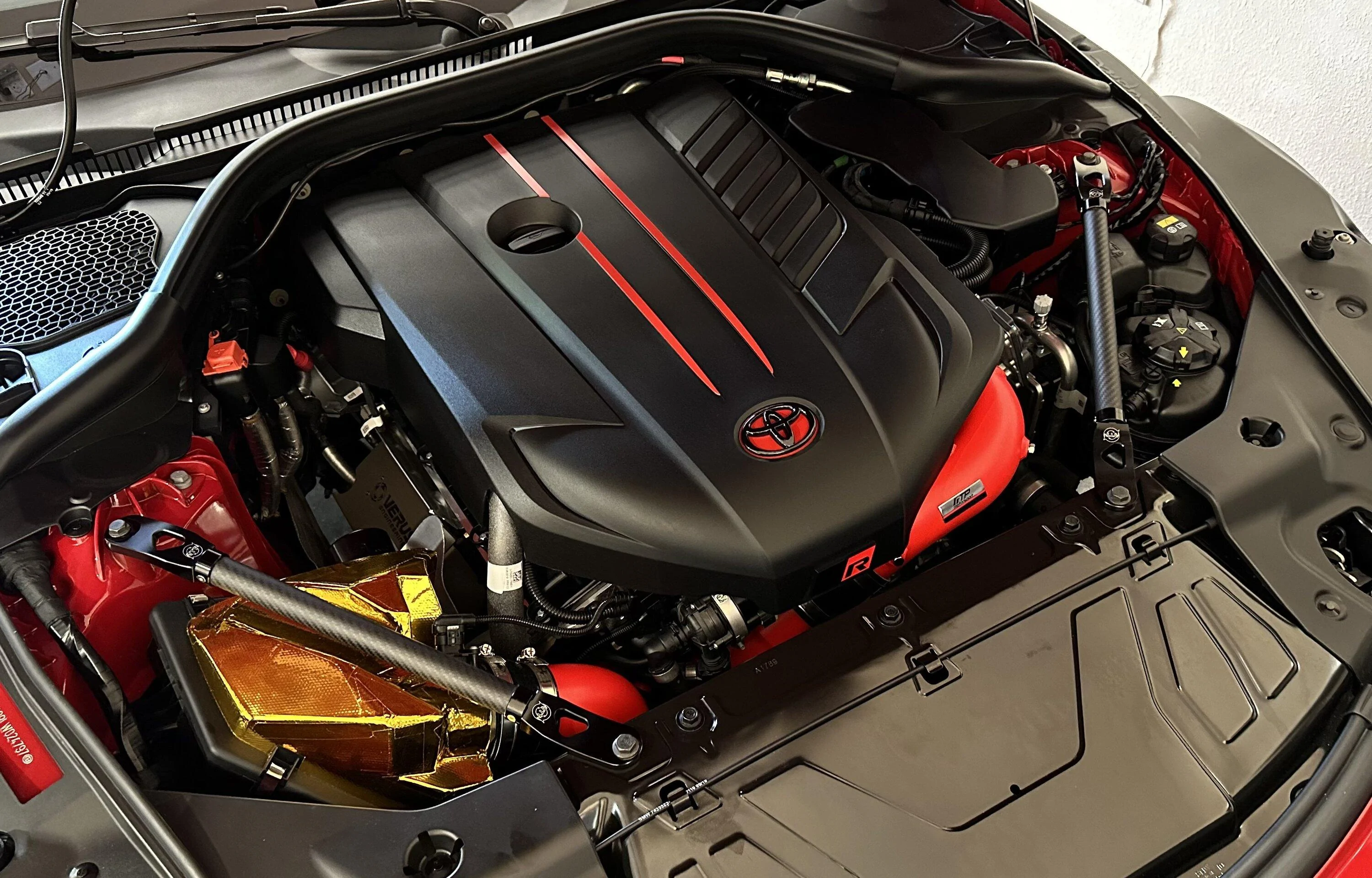

I custom did my own for a few bucks and a little time.
Looks good dude! How does the OEM one come off? is it double sided taped on by the factory?
Is that a heat tape on your intake? I assume to keep the engine heat out of the intake? Any idea of it actually works?

Thanks man. It's DEI radiant barrier wrap. It does work. Before I put it on, after a hard drive, I couldn't touch the airbox it was so hot. With this, I can hold my hand on it after a hard drive. I've been using this on Turbo cars for years. It works.

Thats awesome, I'm going to get some to put on my intake. Any idea if putting it on the inside of the airbox instead of the outside makes a difference? (although putting it on the outside makes it look kind of like the space shuttle, which is actually pretty sick.also is this it? https://www.designengineering.com/reflect-a-gold-heat-reflective-sheet-12-x-24-1/

Needs to be on the outside. You can also wrap your intake and charge pipes with this. I haven't gone that far. I did apply it to the stock heatshield on the side facing the turbo.

The emblem has two plastic rivets that you just drill out. I painted the red with high temp paint first. Painted the emblem with high temp black and used silicon adhesive to reattach it.
