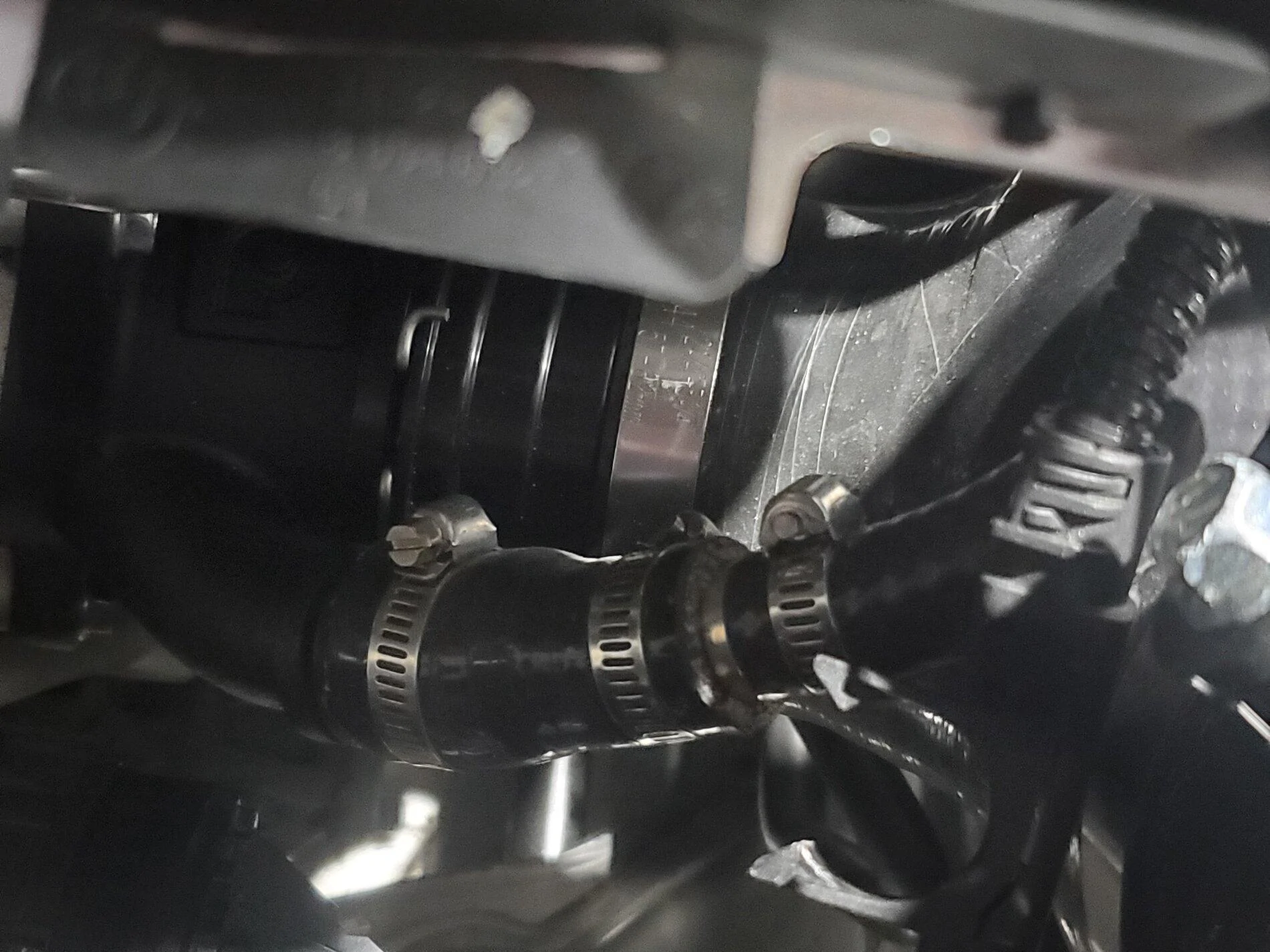

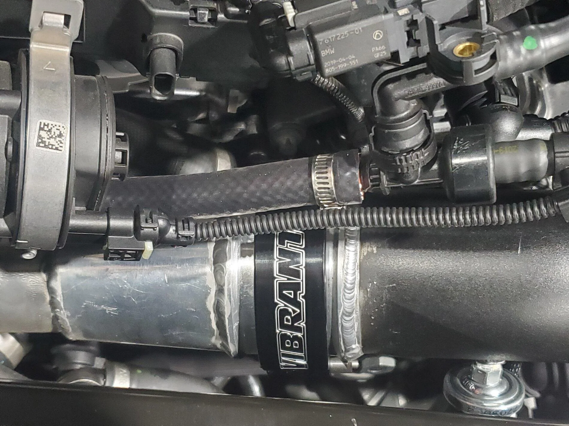

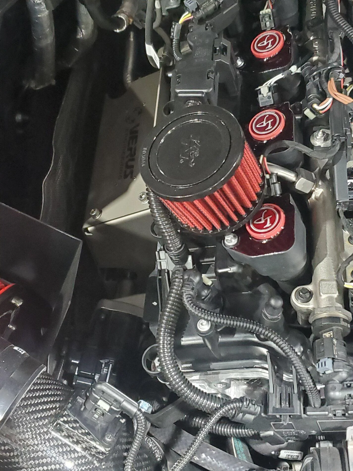

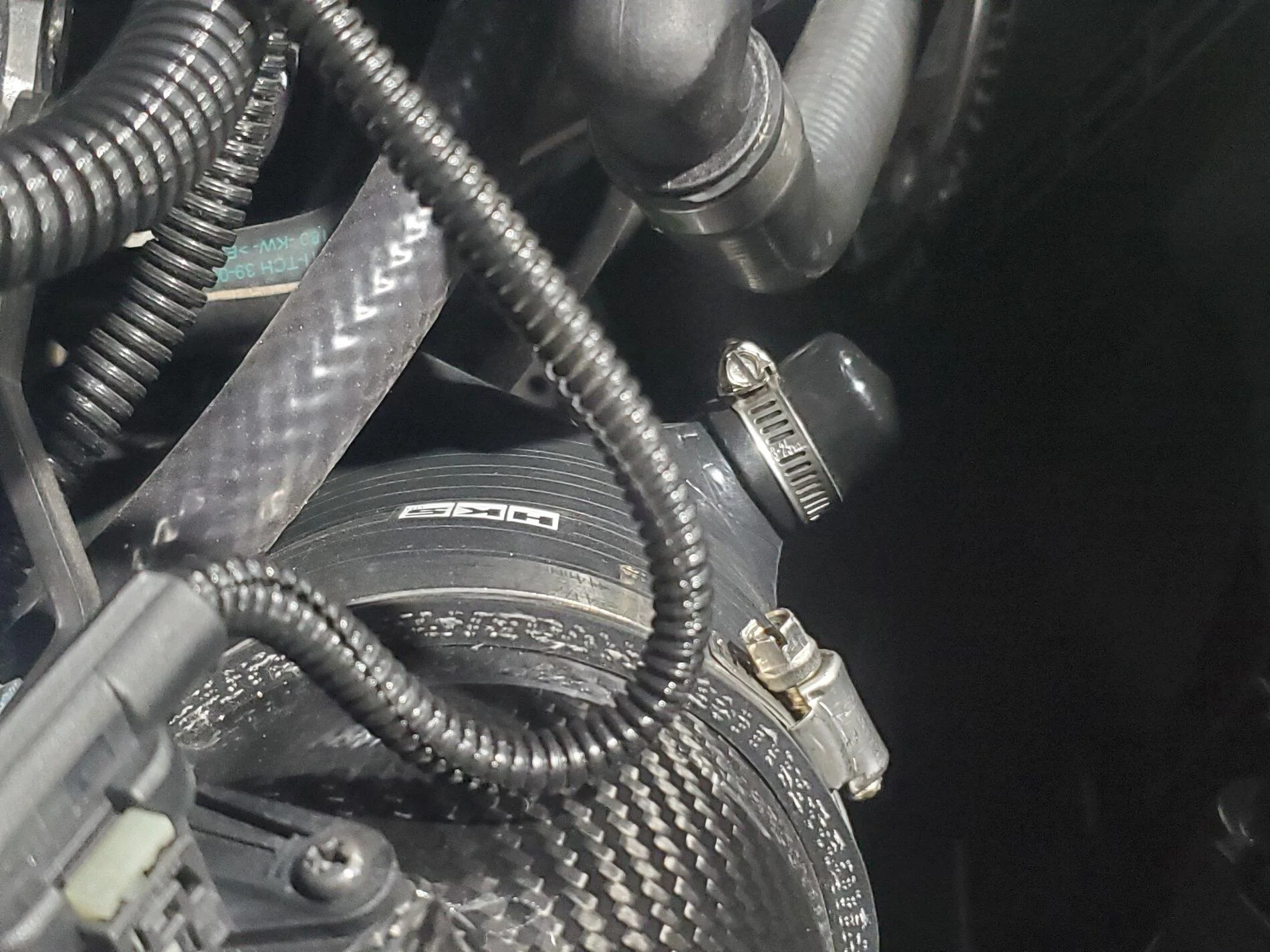

Bflood
Jun 20, 2020
389
333
Columbus OH
3.0 Premium
Good question, I’d like to know that too
I’d rather go “ole school” and just vent to atmosphere, but I’d like to know, in doing so, will that throw a code? And has anyone done this simple , no cost FIX????
I'm venting CCV, PCV and oil cap - no codes.

Bflood
Jun 20, 2020
389
333
Columbus OH
3.0 Premium
Hate to ask u this, but pics of how u vented both CCV and PCV, or an explanation of how, and did u put some sort of filter on the end of vent tubing? Thx
I can take a picture next time the cars out but I used 7/8" breather for the PCV and 1/4" for the CCV (I'm still using the Mishi CCV catch can so breather was placed on the exhaust) I removed a couple of the oem lines and capped anything else not being used.
