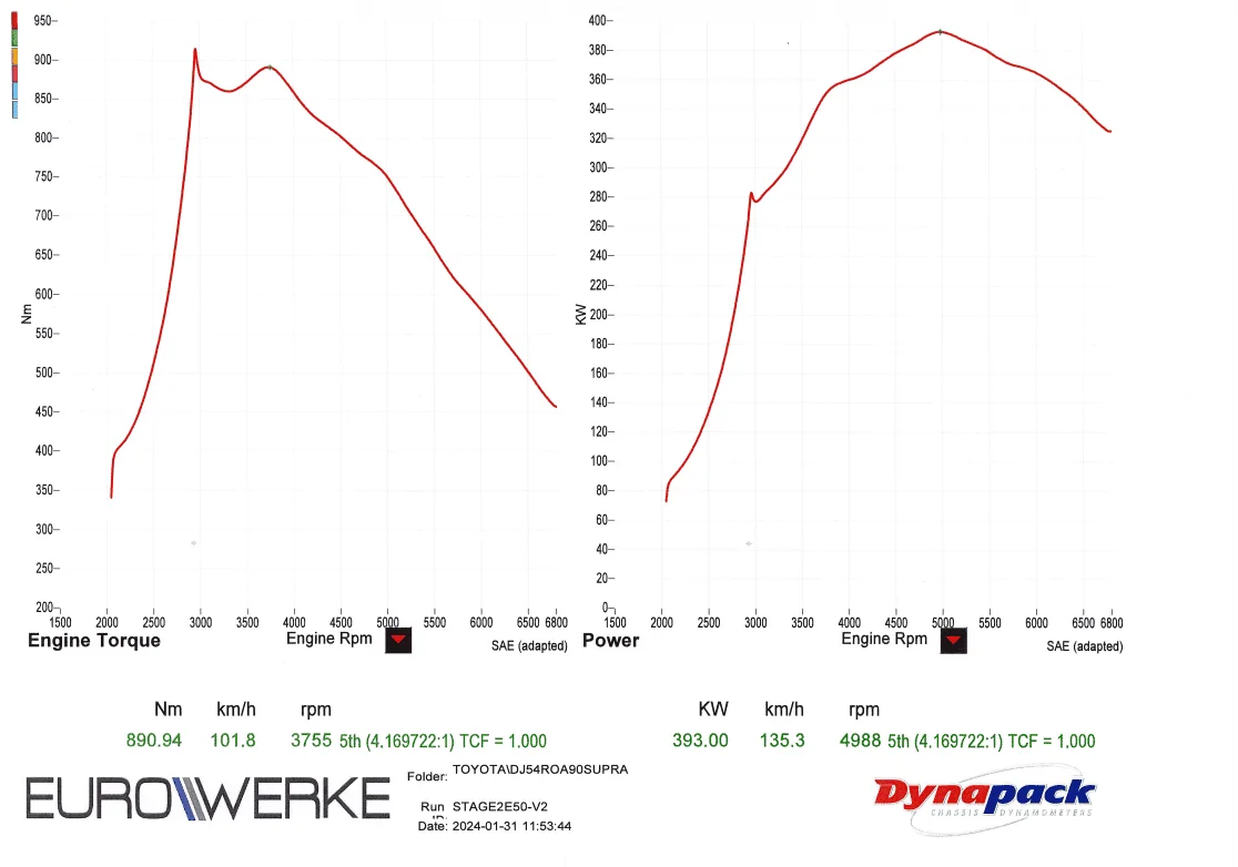

Just hoping i can get some help here. I have gotten the car tuned again with another tuner who has the car finally running right and making good power, have included dyno numbers below.
But now the trans is slipping in 6th gear only, a revision was done to reduce the torque, the revision was done on the hub dyno and there wasn't an issue on the dyno but it is slipping when on the road. so when hard accelerating from 5th to 6th or from hard accelerating in 6th the trans either slips or slips then goes into limp mode, obviously i don't want to keep doing this and ruin the gearbox so was hoping some one can take a look and what the issue could be.

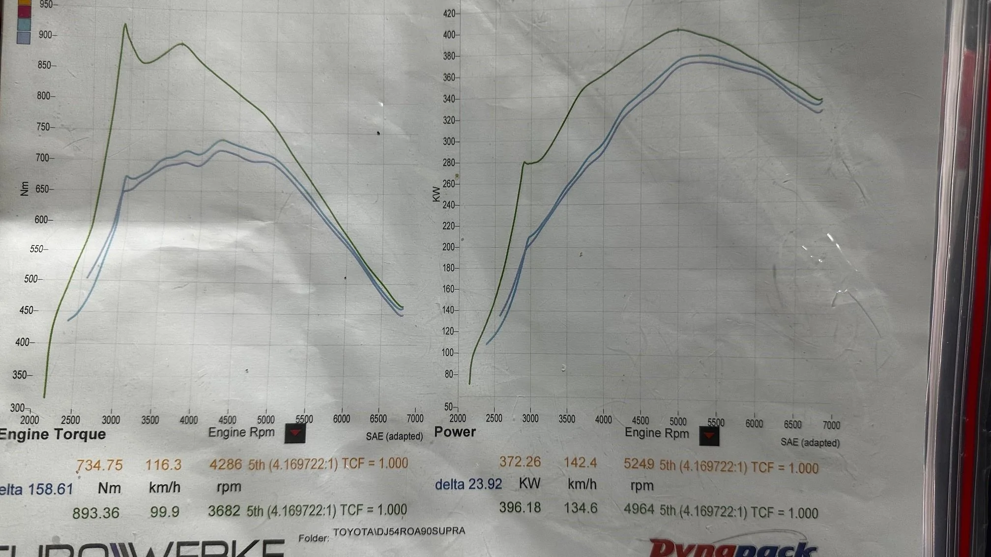

This is the comparison between the old tune and the new tune on E50

Is the new tune the one with the massive spike and the sharp drop off?
Both tunes have a massive drop off the new tune is the one with the 890 nm of torque.

The spike and dropoff is the trans slipping and re-catching. The tune needs to keep the torque under 800Nm or it's likely to slip on the stock trans in 5->6. If your new tune is pushing nearly 900Nm, your tuner needs another revision.

That's called "under reporting torque". It's a tuning strategy. It can lead to undesirable effects, as you are experiencing.
The car is obviously making more real torque to the wheels with the new tune.
