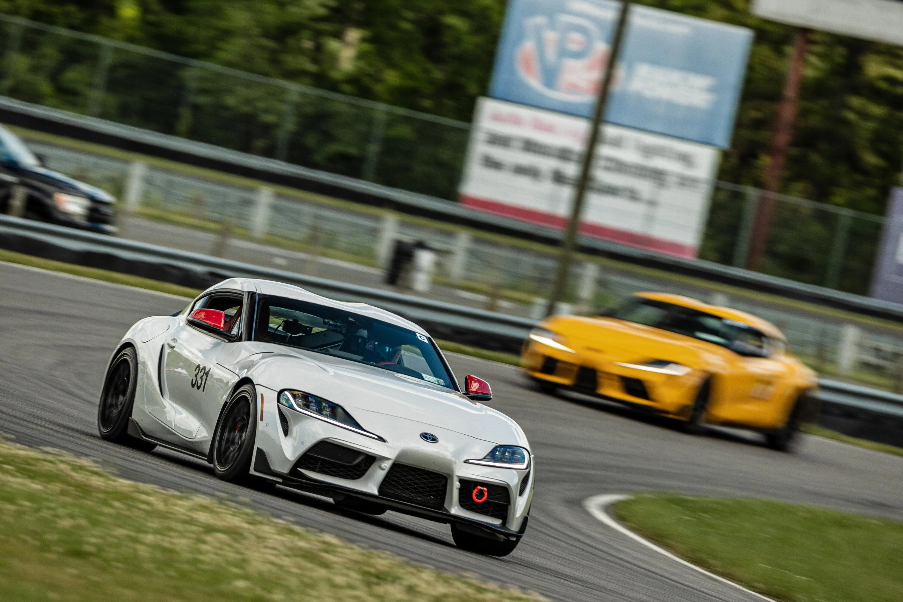

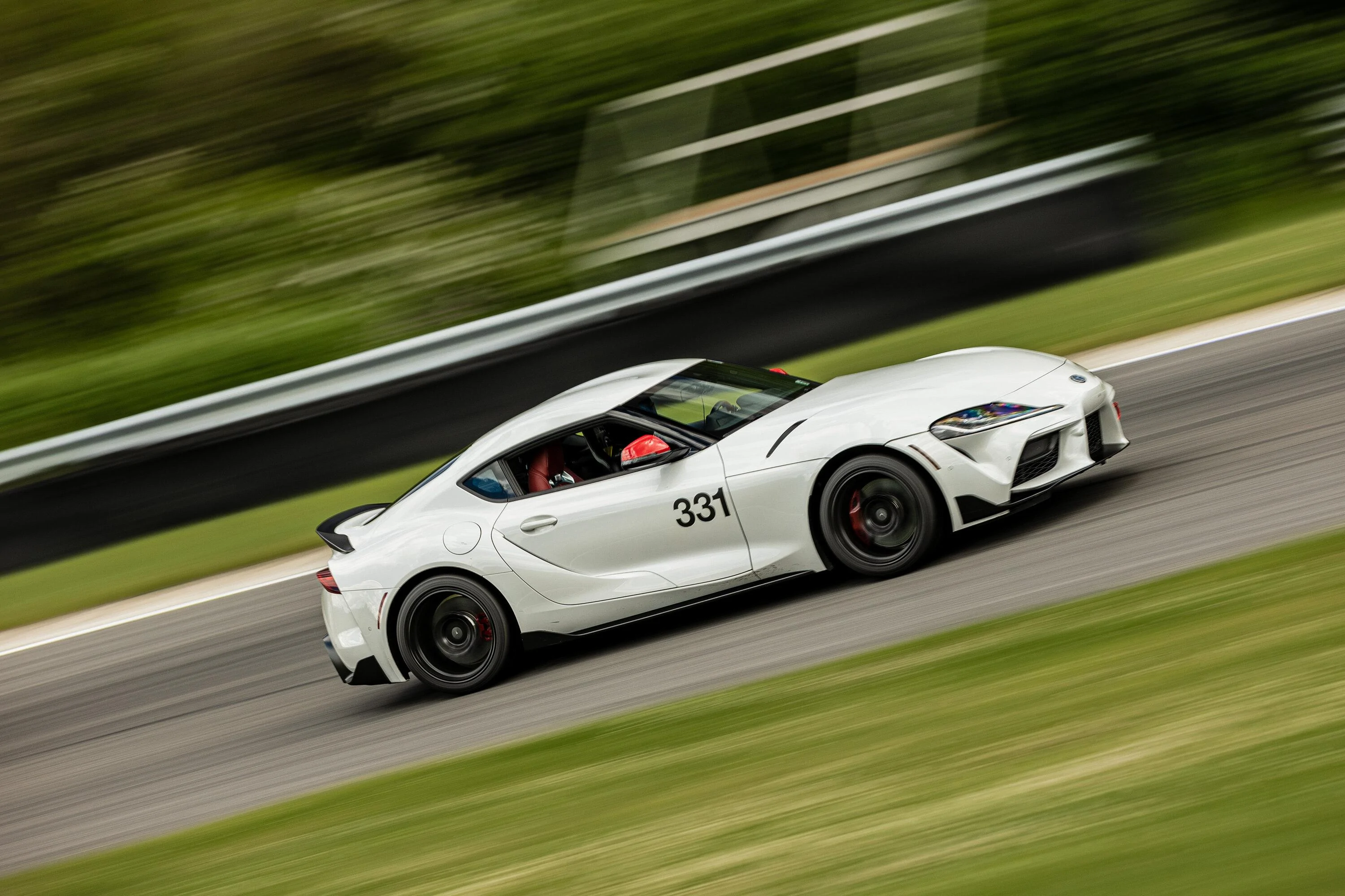

Tons of traffic at the track his past weekend. Most traffic I have seen so far at an East Coast event. I maybe got three clean laps the whole day and my tires where pretty overheated by that time.
Here are two laps from the day. 14 laps into a session. First lap in the video (lap 14) I am trying to cool the tires down a little, second lap (lap 15) looked open finally so I was going for a flyer but the tires had other plans. I'm usually not very verbal while driving but you can hear my frustration in this footage, lol. I still was able to drive the car home so that is a HPDE win in my book. ;)
I think this is the fourth time at Lime Rock so far. Getting used to the track. Aiming for a sub 1 min before the end of the year, which is respectably fast for a street car. We'll see!

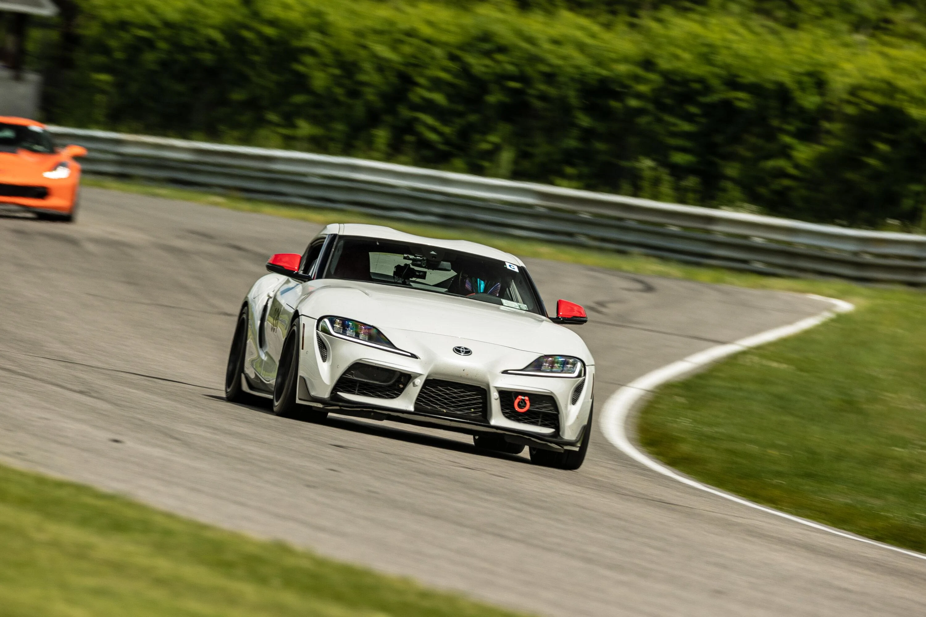

Lime Rock again today. Soooo close to F'in sub 60, it's killing me. A fraction of a second somewhere would have tipped the scale. Going again tomorrow although the tires feel like they are heat cycling out, so we'll see!

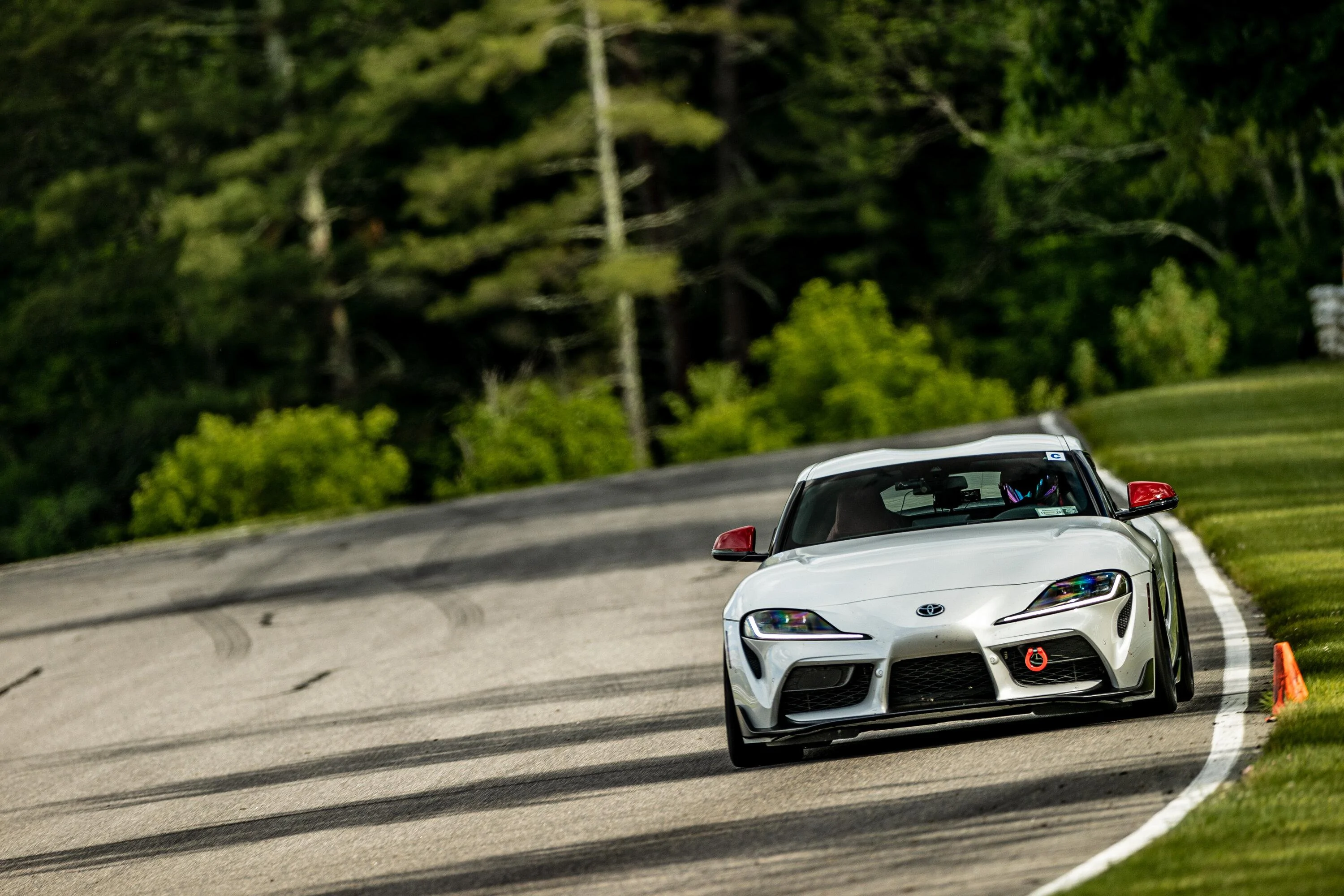

Went to Palmer Motorsports park this weekend. Third time at this track, second time in the clockwise config.
I love this track, it's very challenging and a rollercoaster ride. I very much respect this track as I have seen a fair amount of crashes here so I don't drive it as hard as other tracks but still like to chip away time every time I go!
