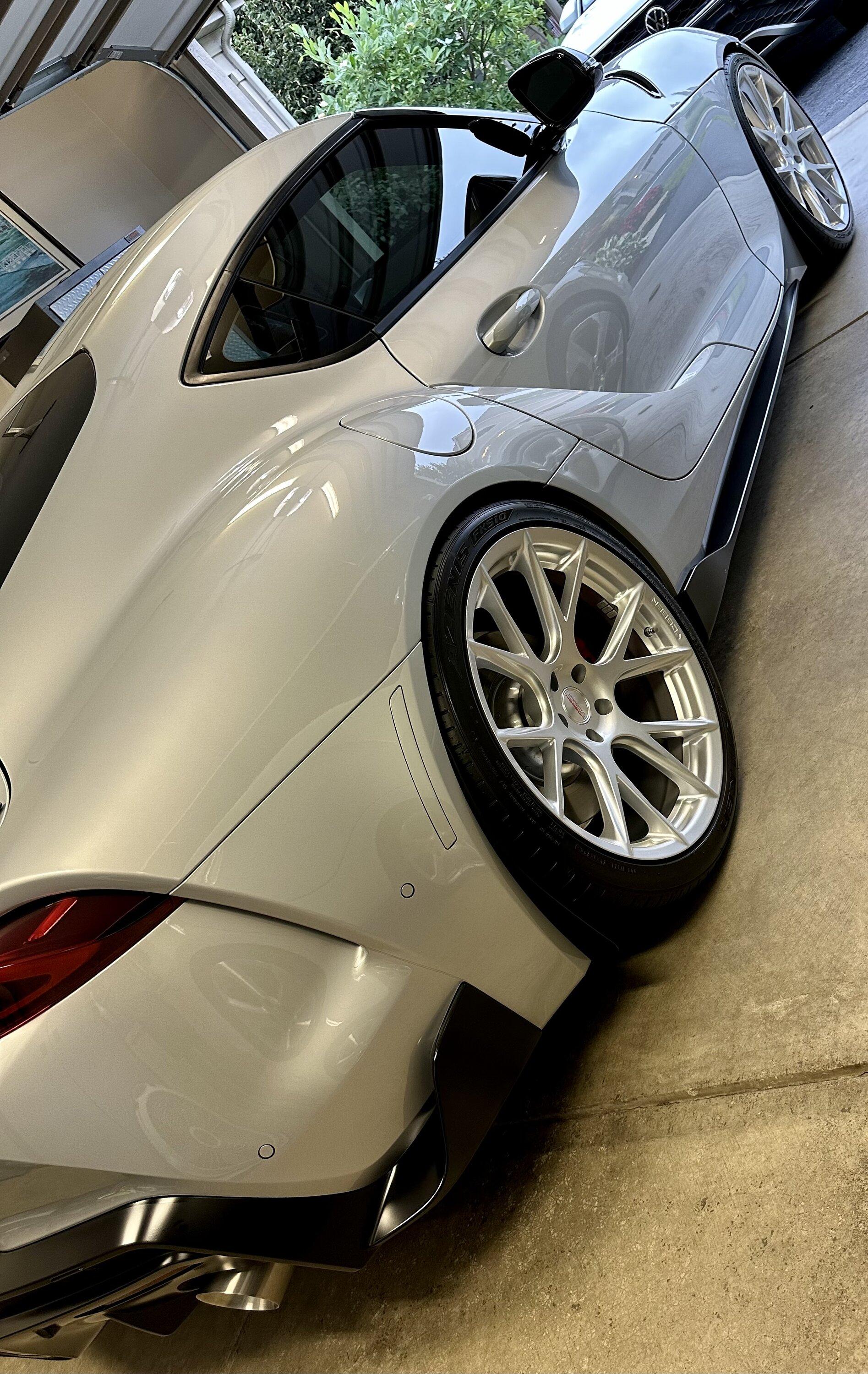

I ended up doing both... paint corrected prior to the full car ppf and then after. Some don't realize you can polish the ppf but you can.... adding even more clarity.
I've never seen a silver finish shine so much.

Damn! Thanks for sharing a picture. I'm pretty hype since I've always wanted a supra. Can't wait to get mine and get it done right.
