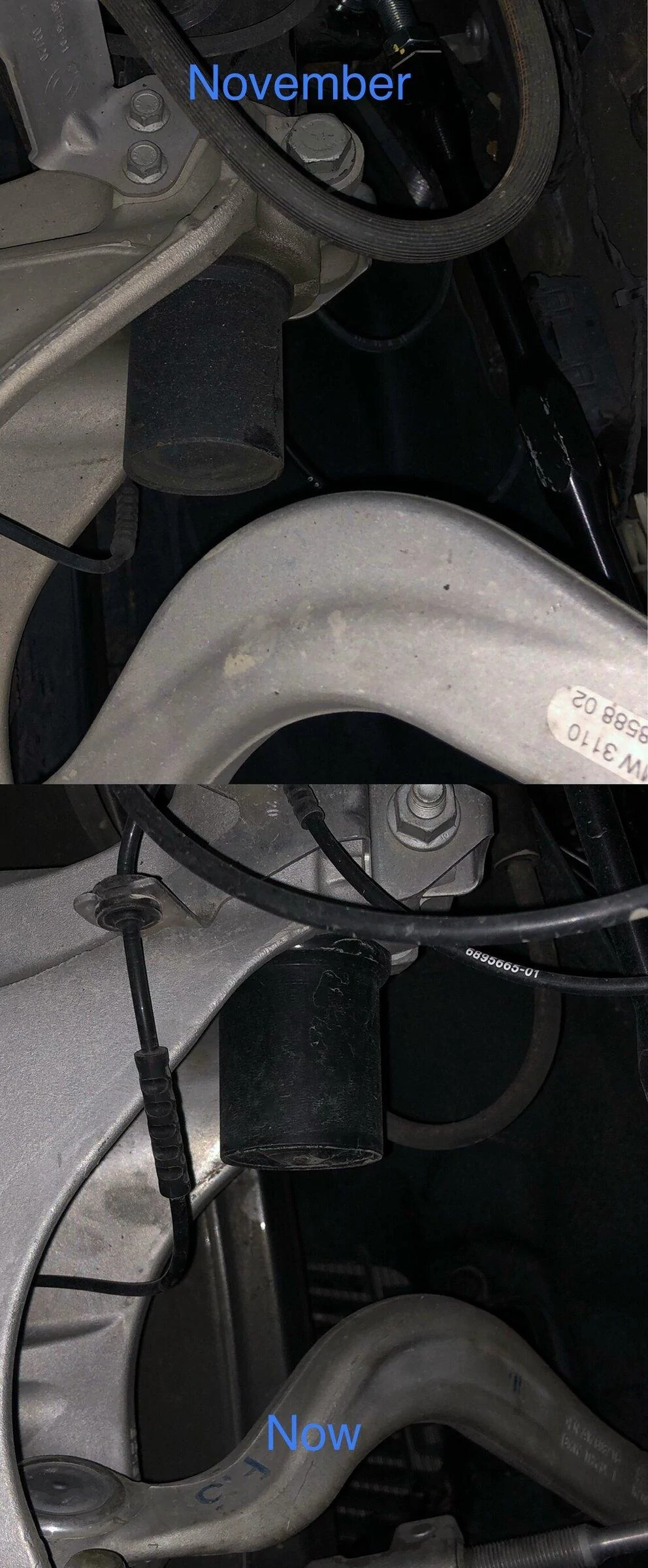

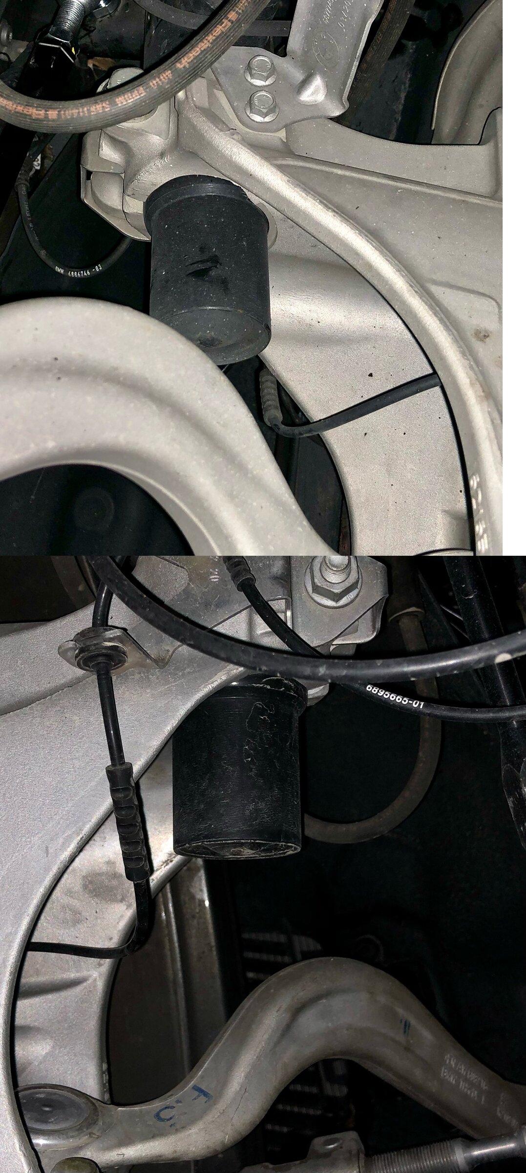

Hey all,
I’m very much a noob when it comes to car engineering/mechanics but am trying to learn as much as I can via here and doing things myself.
Last year I replaced my springs with HKS adjustable lowering springs. This involves removing the strut from the knuckle so the spring perch can be replaced.
Anyways, long story short, it looks like the strut may have slipped lower into the knuckle after a few months of driving? I’ve attached a photo from November compared to now.
Is this tiny amount of slippage, if any, something worry about? I live in Michigan with bad roads.. perhaps it settles into its correct spot?

It looks like the November picture is taken of the Right "Passenger" side and the now picture is of the Left "Driver" side. Can you confirm that to make sure we comparing the same sides?
Your struts are most likely seated into the knuckles at this point. Perhaps inspect and measure both sides are the same and re-torque the pinch bolts to 41 ft·lbs (+90° turn) and you should be good.

I'm struggling to see any difference in the flange gaps on these photos in the first place
You’re right about the photo, I attached the wrong ones. This is the same side (drivers side) but looking at it from opposite sides. It looks pretty close in my opinion and doesn’t show any damage from the top when I removed the wheel for further inspection. So I doubt it’s causing any weird feelings. Appreciate the help.
I am getting some tramlining but I’m sure it’s because the aggressive camber I’m running. The steering wheel also moves a bit when going over some bumps, but also most likely due to the aggressive camber and the wheels following the curvature of the road.
