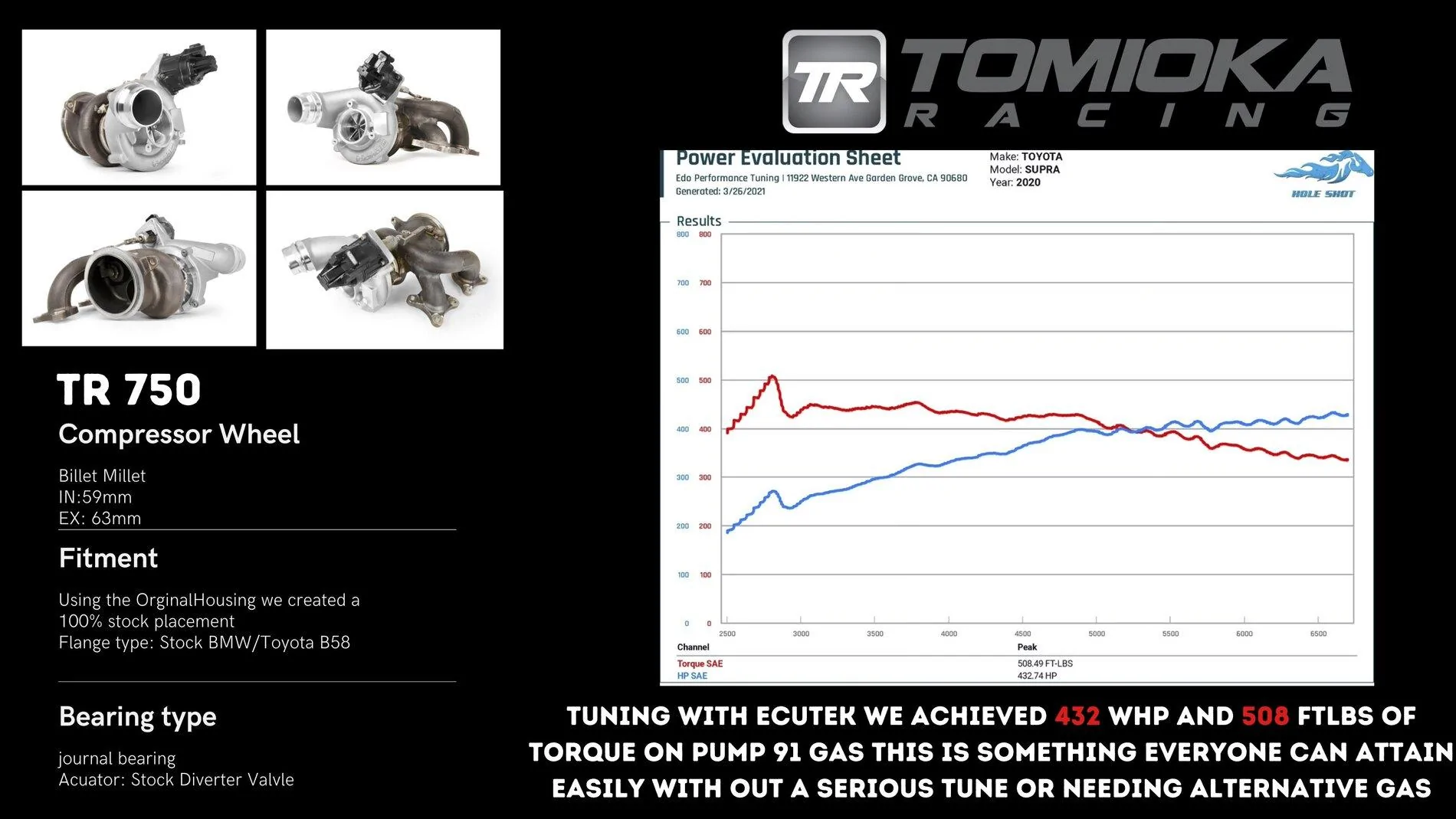

But your dyno is only showing 430 whp and 450 wtq (I don't count that boost spike at the beginning), which is what people get with just a downpipe and a tune. Does that dyno read low? How does it compare to the stock turbo with a downpipe and tune on the same dyno?
It probably is making 430whp at super low boost and has a ton of room for the turbo where 430whp on a stock turbo is at higher Psi levels at approximately 80% capacity on the stock turbo which kills the turbo life over long term.... you gotta think reliability and longevity not just peak hp numbers in a dyno.

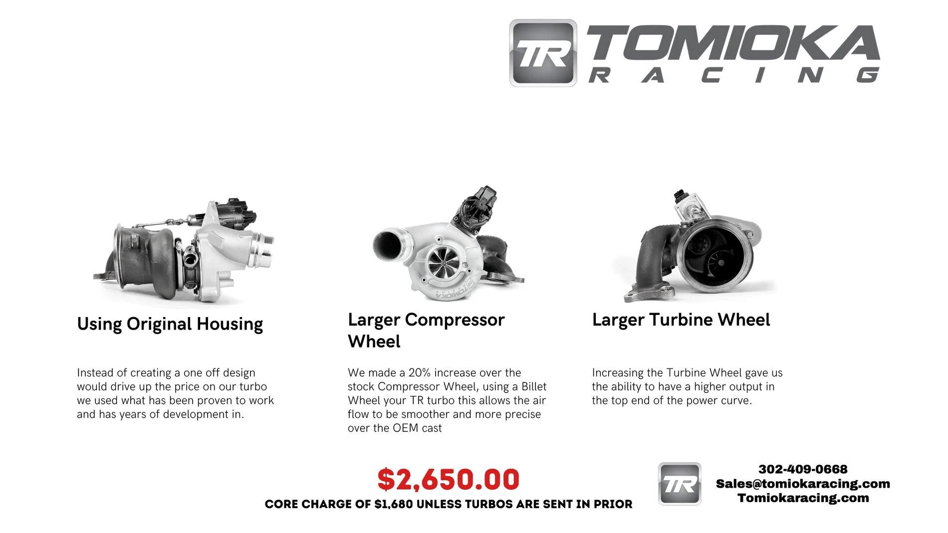

Can you share logs? Can you share information about flow and back pressure? Anything else? Donā€™t get me wrong, I love more options, but for a product priced above the Pure, Iā€™m struggling here. Looking forward to your response.

no one in their right mind will pay more for this than the pure. literally would've ONLY MAYBE CONSIDERED if this was 2700 with the core included.
You can get a Vargas Turbo and take your chances. $1600 without a core charge. Driftmotion has an affordable option that starts at $1k if you send in your turbo. I agree, there are lots of better choices for the money.
