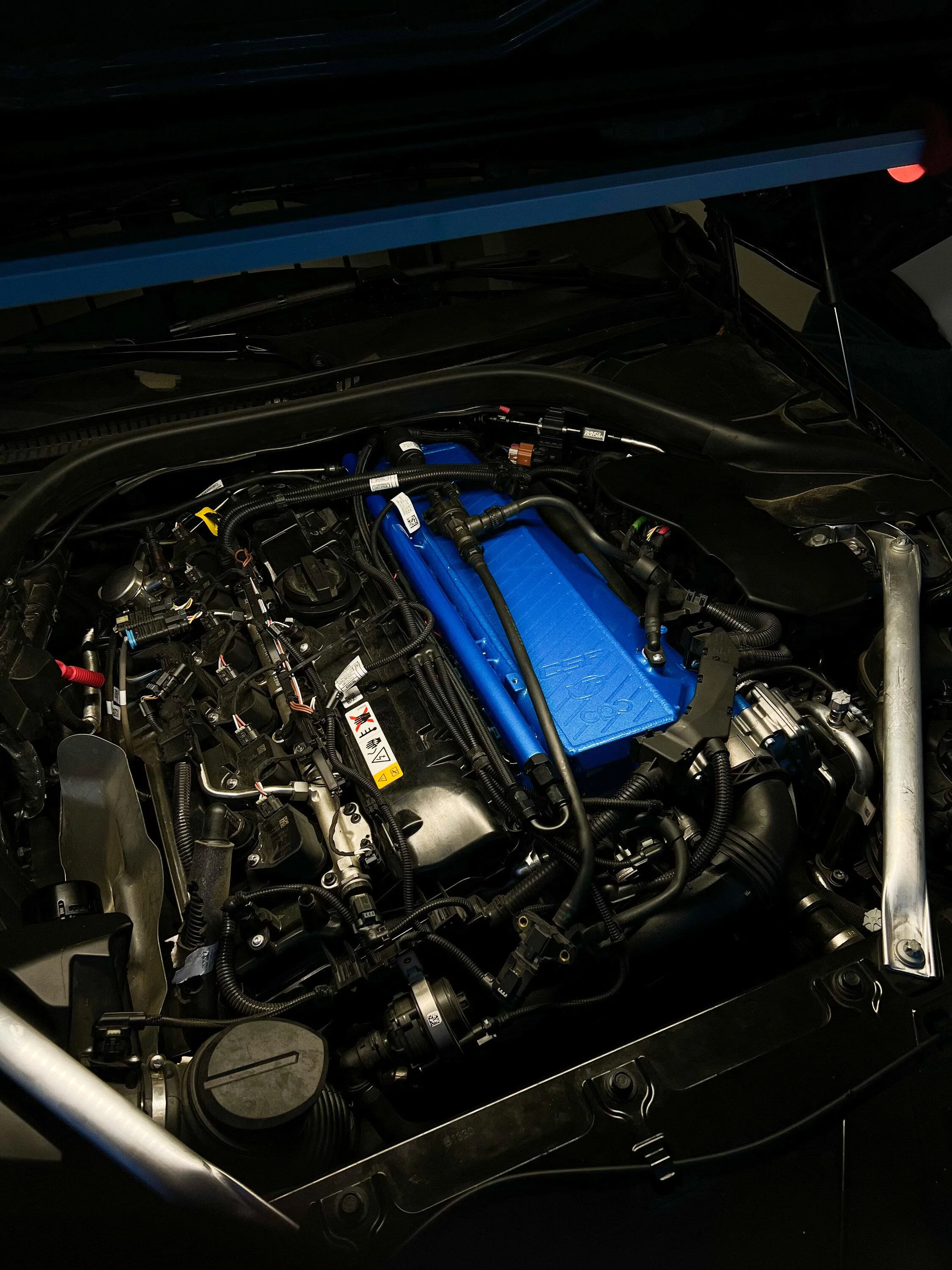

You said you have an AMS charge pipe, but that looks like a stock one in your picture?

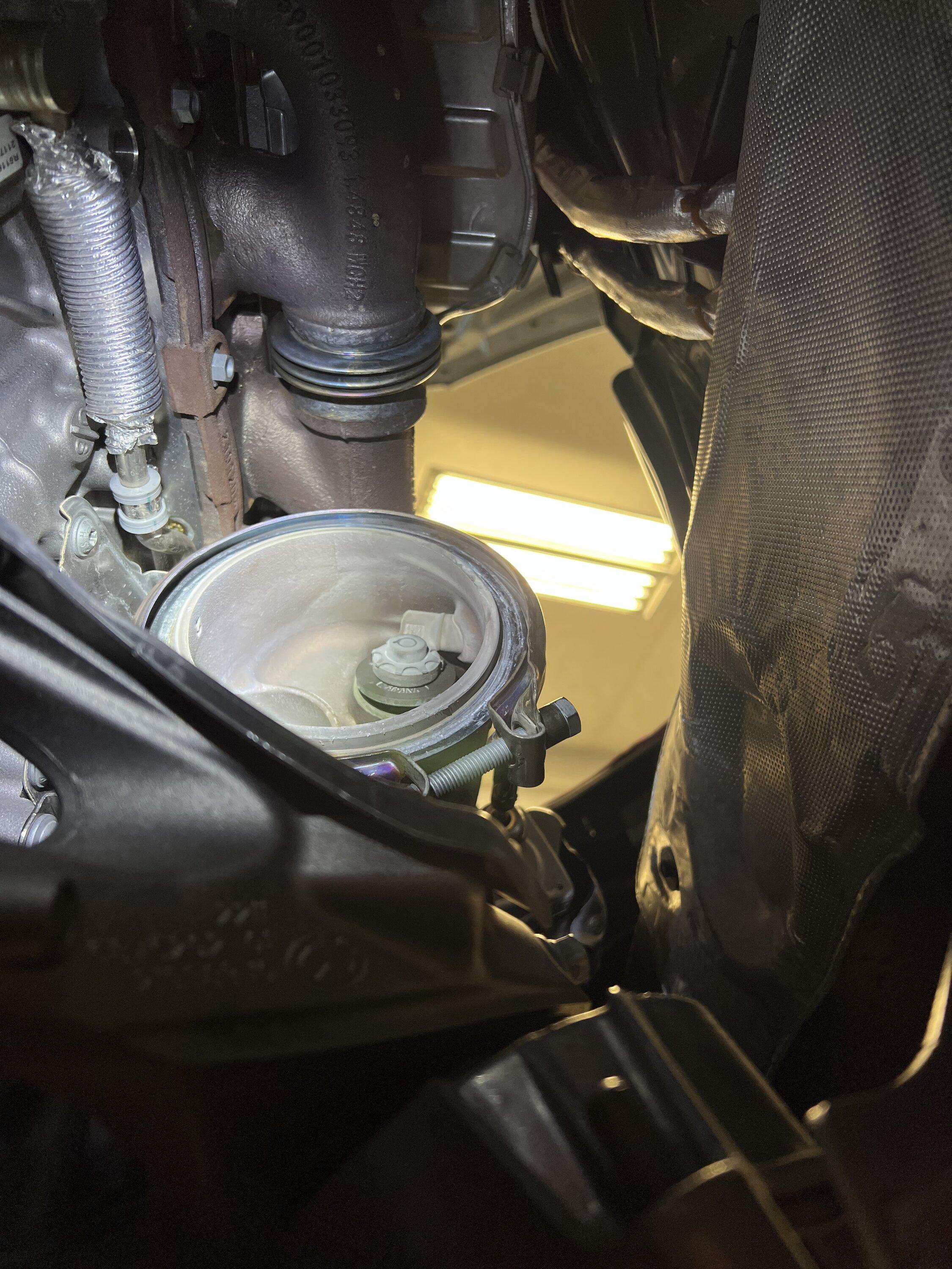

Anyone think this may be the issue? WG is cracked open with the car on the lift.
