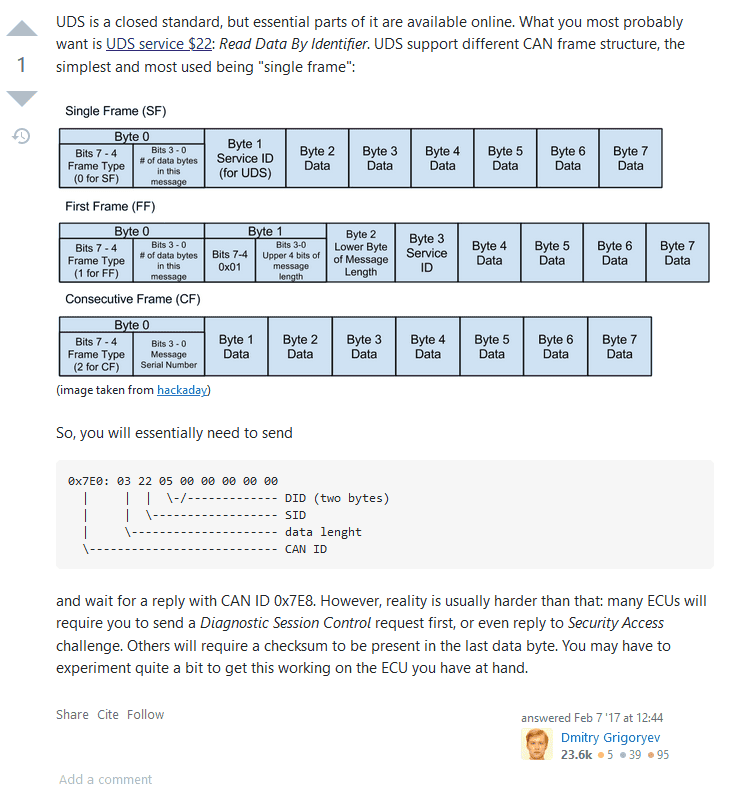

Okay, maybe I've made progress. Or maybe I've wasted hours of my time today for nothing.
First, we know from Zeitronix itself that it communicates on CAN bus ID 0x00EC hex and 11-bit CAN identifiers.
So I tried the obvious: pinging PID 00EC with Torque. No response.
Okay, so the ECU has different "modes" where different channels of codes are sent. Mode 21,22,23 are often used for vendor-specific things. I tried plugging in 22 EC and got data back! The ECU reported 7E9037F2213. Interestingly, that equates to ~8.0 when you hit this value with the typical (A/255)*100 formula for calculating ethanol percentages on other platforms... Not entirely unreasonable for the e content of 93 gas. Did I get it? Probably not.
As a roundabout verifier, I pinged this interface several times and got the same HEX code back over and over. Ethanol content fluctuates slightly when you're putting it through a sensor, usually some wobble in the first first decimal place, as the car runs. I've seen this in my other car that runs E50. So it's unlikely this 7E9037F2213 response is the ethanol content we're looking for because it came back over and over at the same number.
That takes me back to the 11-bit thing from Zeitronix. A standard CAN message on a car has specific format/encoding that looks like this. This is NOT AN OBD2 MESSAGE.
If we take Zeitronix at face value, then 0x00EC is the default CAN ID of the Zeitronix unless Visconti changes it to something else (which they can, and you can).
Okay, Zeitronix also says:
Data 0 is 8 bits long (meaning bits 0 thru 8 in the data)
Data 1 is 8 bit (-40) to derive Celsius of the fuel (meaning bits 9-16 in the day)
Data 7 is 0x00 for sensor OK, 0x01 for sensor not ok
This gives us some clues about the CAN ID (orange) and CAN data (blue) in the diagram being sent by the Zeitronix unit. That took me here, suggesting I wasn't entirely wrong for suspecting Mode 22.
Mode 22 represents UDS, where you can directly read information by Identfier... identifier... LIKE OUR 0x00EC CAN IDENTIFIER. Case closed here, I need to be in mode 22 but I was using it wrong.
Okay, that's a big clue. We know our CAN ID is 0x00EC (maybe).
We know/think our Service ID (SID) is 22 (this is a hex value).
Standard CAN messages are limited to 64 bits (8 bytes) aka HEX 40.
Byte 1 (8 binary bits) should be the ethanol percentage if we convert to decimal, e.g. 0x38 hex should be 56% ethanol.
Byte 2 is another 8 bits, and if we convert that to decimal and subtract 40 we have the fuel temp in ethanol.
And in the 7th byte, 0x00 = sensor OK or 0x01 = sensor not OK.
And another clue: Zeitronix says that Data 0 (the first 8 bits) contains the eth%
Putting it all together, I'm thinking maybe the "PID" is not a PID at all but a mode 22 UDS query formatted differently.
And we're just guessing it uses the simplest single frame, in which case the query is:
EC (Zeitronix CAN ID 11-bit)
00 (single frame query)
40 (8 bytes data in the message)
22 (service mode)
Data bytes
1. 0-64 (eth)
2. 00-FF(temp)
3. null
4. null
5. null
6. null
7. 00 or 01 (sensor)
OR MAYBE I'M A TOTAL MORON WHO HAS NO IDEA WHAT'S GOING ON AND THIS SHIT WILL NEVER WORK BECAUSE THE FRAMES ARE A PROPRIETARY SIZE AND TORQUE CAN'T RESD THOSE KINDS OF CAN MESSAGES REEEEEEEEE

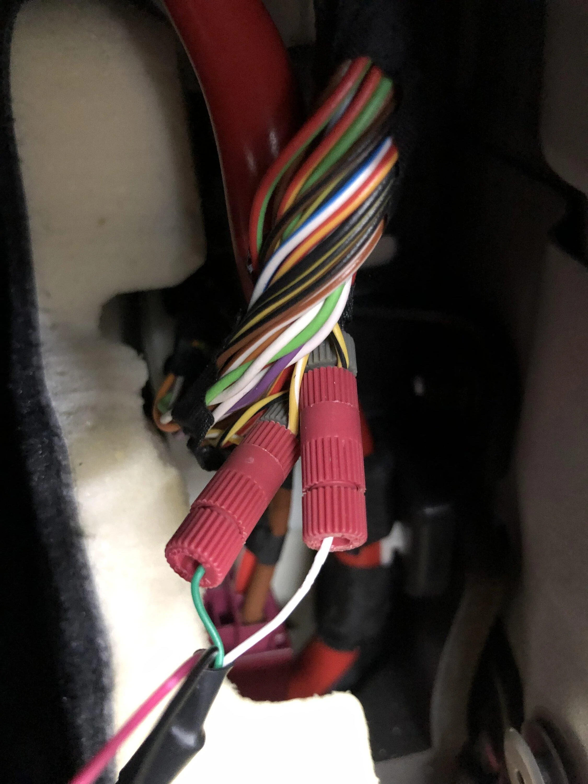

Catch me up here - how are you interfacing with the CAN bus?
underdonk
Jan 6, 2021
1,879
1,878
'21 Supra 3.0 Premium
Easiest place to tap into the CAN bus is the twisted pair in the passenger footwell. Right hand side, under the glove box. Pop off the plastic interior piece and it's right there.
Got it. Thank you. So it seems that @Thraxbert has arrived at the logical conclusion that the software is the limiting factor in this case. There are all sorts of open source CAN sniffing tools available as long as one has the hardware to support them. I have experience with this stuff on the industrial control system side of the shop (toxic and nuclear waste processing), but we use pretty specialized tools (hardware and software) for this purpose. I've seen the open source tools work, though. There are some good, general tools available on the commercial market I've used for this purpose (outside of automotive work) in the past as well. At the risk of stating the obvious, that seems like what's needed here? The answer could be yours for $14,999.
